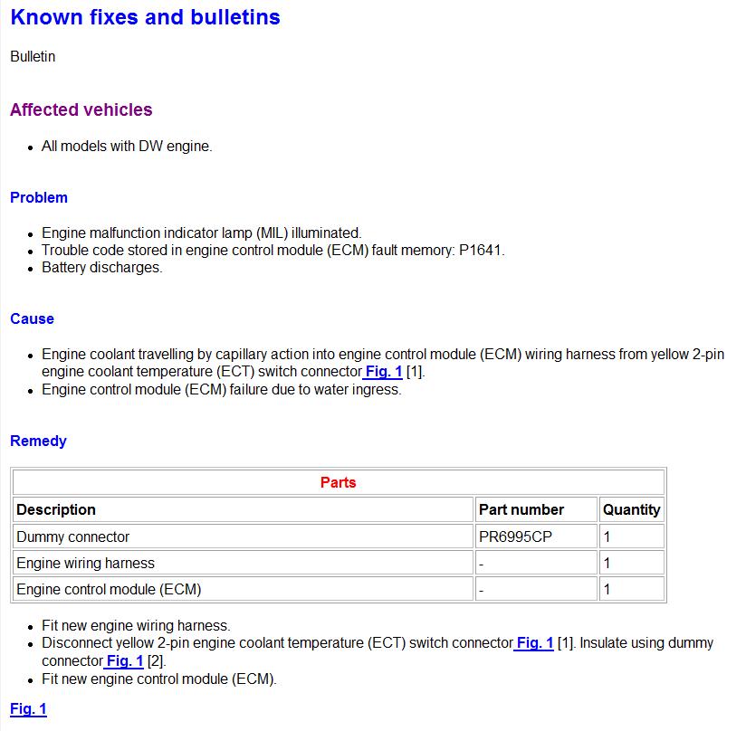

Hi Cully, thanks for your reply. I thought about the ecu and even found one on ebay for £36 but then realised I would have to have a full re-code done and don't know what this may cost. I'm doing it for my daughter and she doesn't have a lot of money to throw at it but we've already had the cam belt done and the new pump sensor (£107) and road tax so may be worth spending a bit more as the rest of the car is tidy and engine really pulls well. Or do I shove it on ebay and cut & run ?
according to auto data there is a know problem with the coolant temp sensor that tracts coolant to the ECM!

(30-03-2013, 06:24 PM)cully Wrote: according to auto data there is a know problem with the coolant temp sensor that tracts coolant to the ECM!
Hi Cully,
Thanks for the info I'll check that out tomorrow. Any idea where I would get these parts from is it Peugeot main dealer?

probably pug main dealer for the upgrade kit
