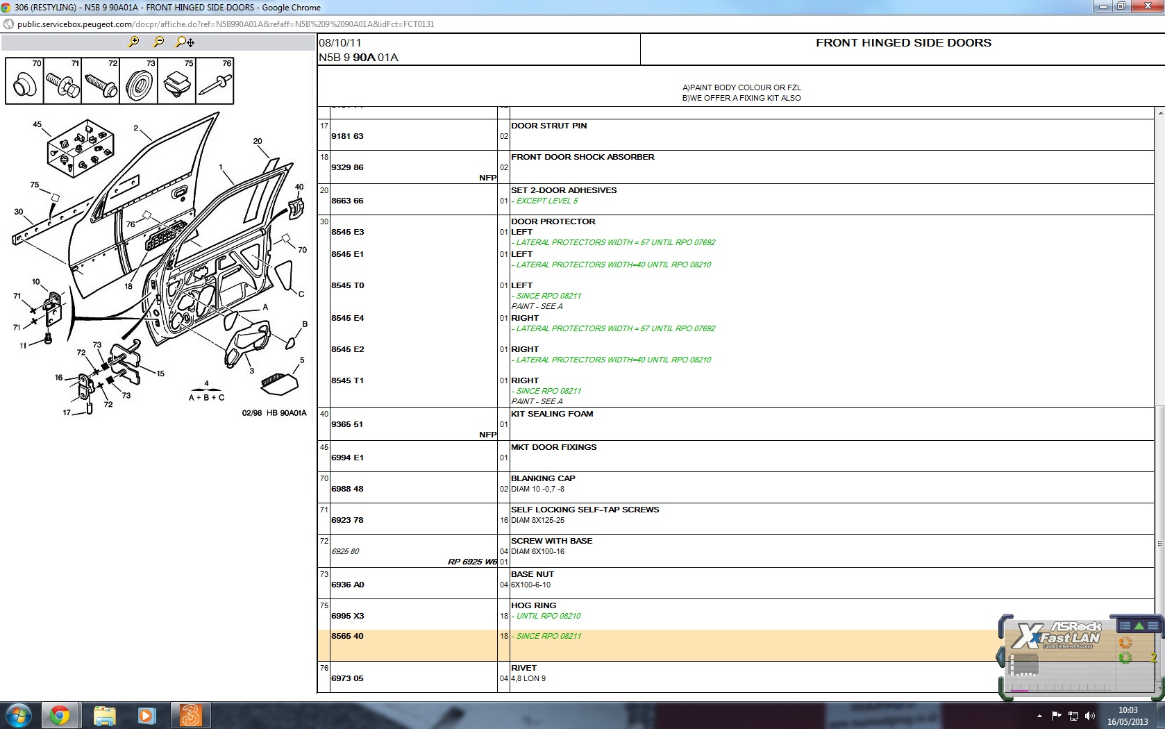

8565 40 is the part number and they are 20p inc VAT each, there's about 18 each side so you need 36 (£7.20 before discount).
