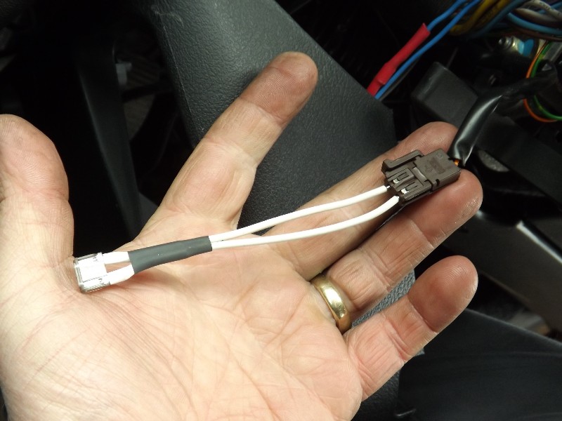

Have you removed original seats or steering wheel to fit sports steering wheel or seats.?

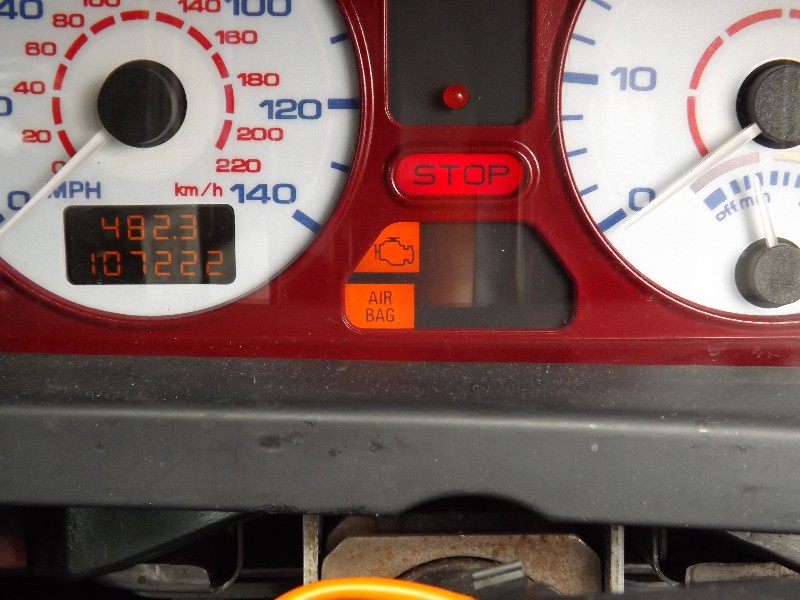

Have you a pesky airbag light that wont go out ?
want one of my fused Air bag resistors?
maybe this can help!
insert into faulty or removed bag/pretensioner plug

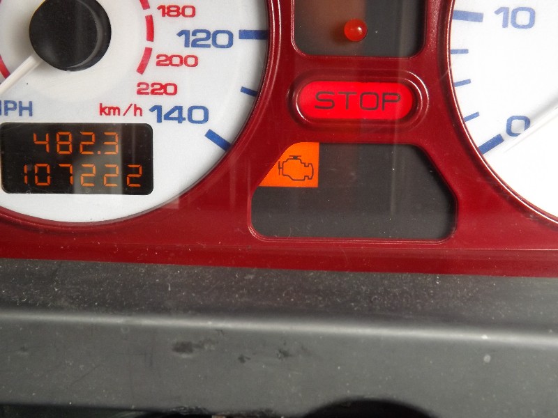

turn on ignition wait for self check and......
no airbag light!
tested on Ph3 Hdi
works on side airbags,pretensioner,steering wheel bag,passenger bag
remember these will only work if your system is working ok just less a bag or two
it will not work if the airbag ECU has logged crash impact and detonated bags

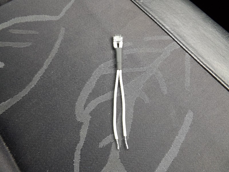

fused 2Amp airbag delete resistor
PM me if interested in purchasing a resistor soldered in series to a 2 amp fuse
