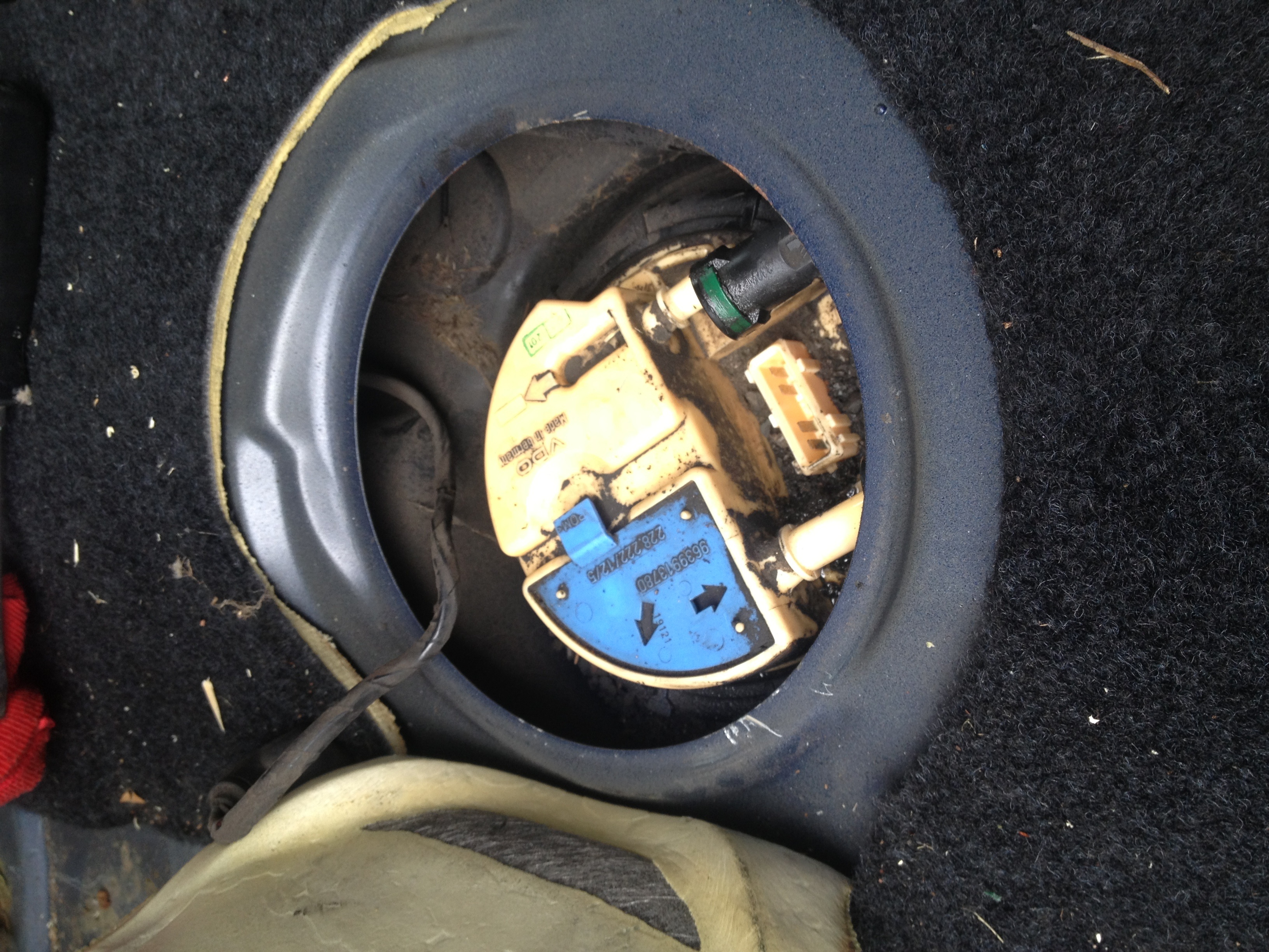

How do i get mine out, dont want to force anything. 2002 hdi, heres a pic...

(04-10-2013, 11:30 AM)PE02KHG Wrote: How do i get mine out, dont want to force anything. 2002 hdi, heres a pic...
as said, you've got the colour codes to help (white - inlet, green - return)
pop them off
You'll have a black "screw" which holds the sender unit down, usually requires a hammer and screwdriver to tap it round, they;re stubborn fucks..
I got it out, but its got stuff attatched to it within the tank can i just pop these bits off?
My bad, just the float was getting hooked.
don't do this when you've just brimmed your tank... it gets messy
