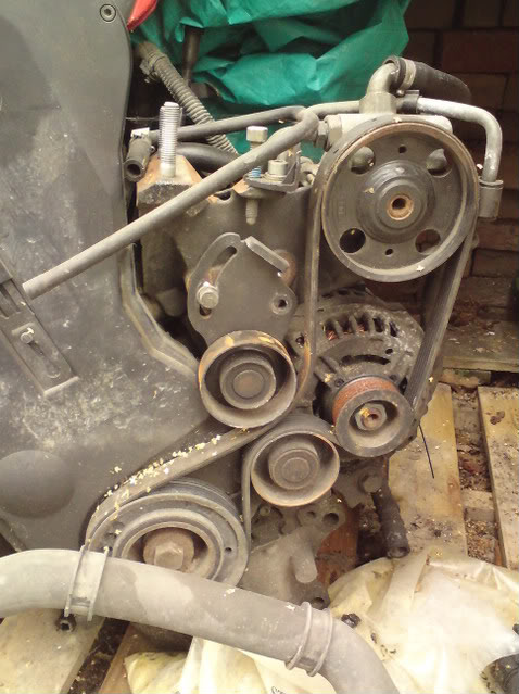

just so people can see the difference this is my standard 6 setup with aircon Smile
[Image: 100_5326.jpg]
