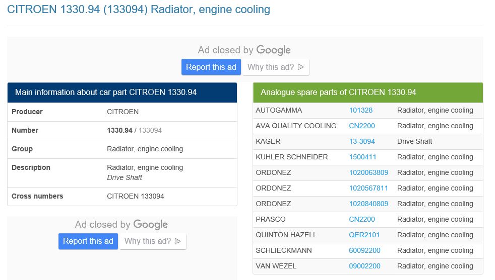

Partinfo.org lists these analogues for Citroen 1330.94.
Oscaro (whoever the hell they are) also seem to supply the AVA CN2200 radiator, and I found a Van Wezel radiator through Autodoc.co.uk, but it's not cheap.  (Another reason I'd be bodging the Nissens to fit!!).  At least we know Autodoc ship to the UK relatively cheaply.
