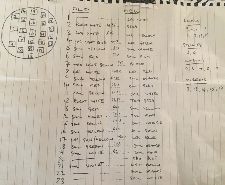

I've checked the continuity between the door plug and all the wires that are inside the driver's door skin that are going towards the door lock mechanism to identify that they are definitely pins 9, 10, 11, 12, 16, 17, 18 & 19 as per the table in the pic
I've tried a few combinations of swapping/changing the wires coming from the A pillar into the new loom (changing one wire at a time and testing things).
For reference this is how I have wired up the A pillar wires to the wires in the new loom (btw the numbers in the middle row e.g. A275, 606 etc don't bear any resemblance to the numbers on the wires coming out of the A pillar, I just copied these from Cully's guide in case they were going to be of use):

that drawing is for a ph3 car with the locking box in the centre dash console under the clock temp display
ph2 locking box is under the rear bench seat and the wiring is very different to the ph3
i would suggest rechecking your joints as i suspect you have mixed up some of the same colour wires
Peugeot use wire numbers printed on the cables as tracers not insulation colour hence multiple cables of the same colour

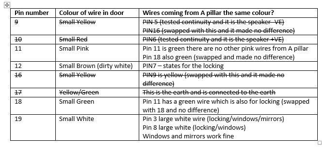

Thanks guys, I;d be very surprised if it's the solenoid unless me rewiring has caused it to break.  I reckon it's mixed up wires and I've tested the continuity/functionality of quite a few of them and narrowed it a bit:
I will have to try every possible ramification as a worst case but based on the above can anyone offer any further clues on which coloured wire going to the door lock does what e.g. is one of the wires the connection to the RF for example and therefore what could be causing the driver's lock not to close with the key?

Managed to sort this now, did a pulse test on the wires into the solenoid and it turns out I had the two red wires - pins 6 and 10 mixed up. I originally ruled this out because PIN6 was routed to the speaker and it worked but they're both live feeds....doh!
