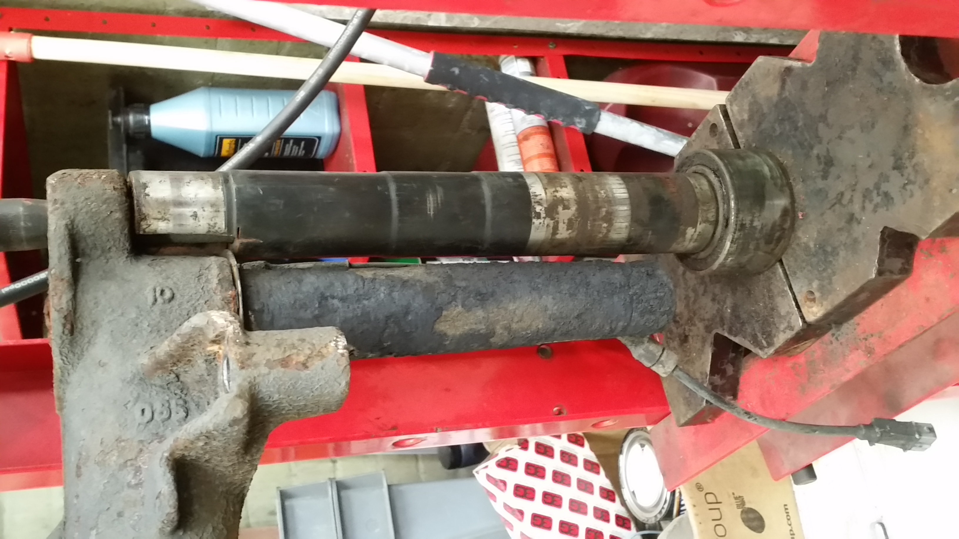

using an old shaft with a clearance groove cut in it.
these ones I stuck 8 tons on then a few minutes of blowtorch and they went  BOINK.

You do, just crank on them with your homemade puller (after repairing it), once there's some pressure on, apply some heat and if that doesn't work alone a few hits with a BFH on the other side will see you peak past 8 tonnes easily.
yup, that's how I did the last ones, the gauge may go well past 8 tons but its only a 10 ton press so I don't like to crank it too far, give it 7 or 8 and apply heat, or a doink with a hammer, and ping they go.
you do have to be quick if you apply heat though, they soon cool down and you'll be back up at peak tonnage again.

I borrowed a 20 ton press in a lorry maintenance unit. That did the trick!
