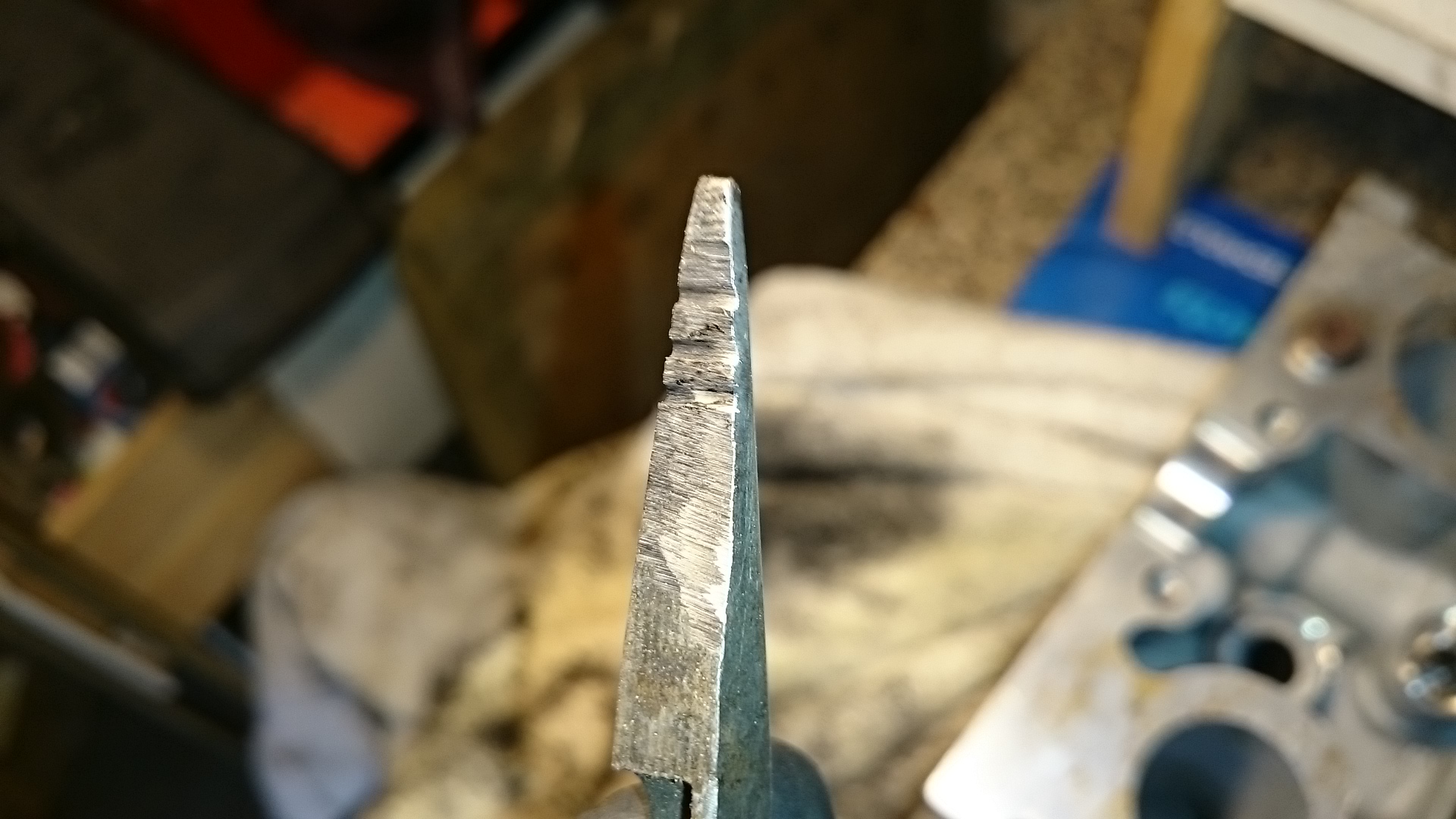

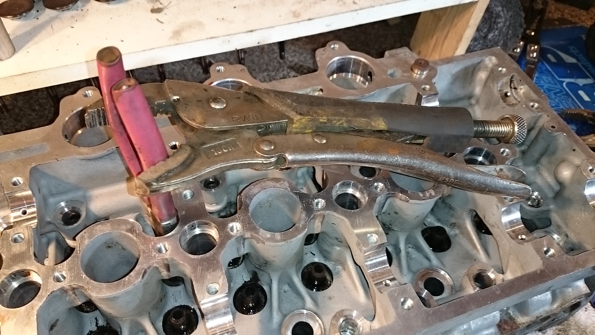

After another 20/30min on one with no joy... The grinder and old tools got it...
With that setup...got each one out in seconds!!
Fyi: inlets are trickier than exhausts to correct myself
