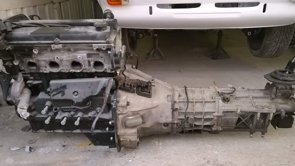

It'll be a type9 box that'll bolt straight up to a zetec (personal experience)

Black top bolts straight to a rx8 6 speed with a adapter plate

Type 9 box on a Zetec black top
