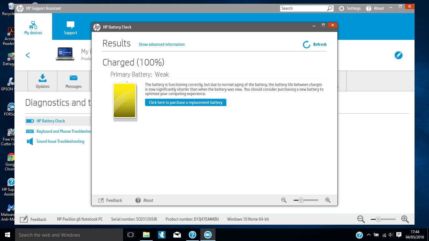

I tried the battery health check though and it shows a weak battery on the new one? The old battery showed 'needs recalibration'. Not sure whether I should message the seller and ask for a replacement or if it's likely to be the laptop at fault, not that I can prove it either way I suppose!
My other thought was that the new battery is also a dud/has a f*cked cell but there's no way you'd know without removing them and testing which would invalidate any warranty you have. Could be worth seeing if the seller will replace
