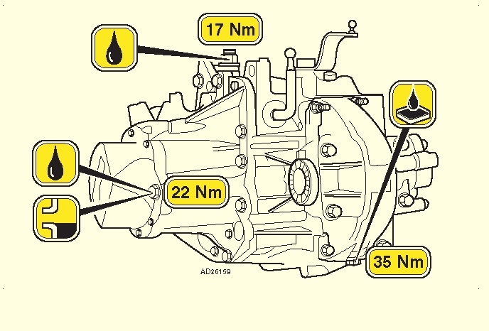

through the breather at the top
box takes 2 ltrs from dry

The white cap? How does that come off? Just pull? I've never really looked at it
Posts: 18,242
Threads: 386
Joined: Dec 2011
Reputation:
87
Location: Suffolk
Car Model/Spec: Focus Titanium
Thanks: 1
Given 118 thank(s) in 117 post(s)
Black plastic 'nut' type thing under the white cap. Its 17mm iirc.

Just undo it yeah?
Take it completly off I guess, and fill till it spills or is there a level?

this is for the 5 speed but i guess the level plug is the same as the 6 speed

So from the side, fill until it spills. From the top 2 litres from dry right.

(28-03-2016, 12:00 PM)Matt Wrote: So from the side, fill until it spills. From the top 2 litres from dry right.
I'll drop the oil and see what's left tomorrow. As I can't get the oil today as dealership will be shut!
Good luck getting it in the side without a pump though... I'd fill from the top either way.
If you're draining it, just stick the full 2 litres in afterwards, I'd only bother with the level plug if it was only half drained from a driveshaft popping out or something.
