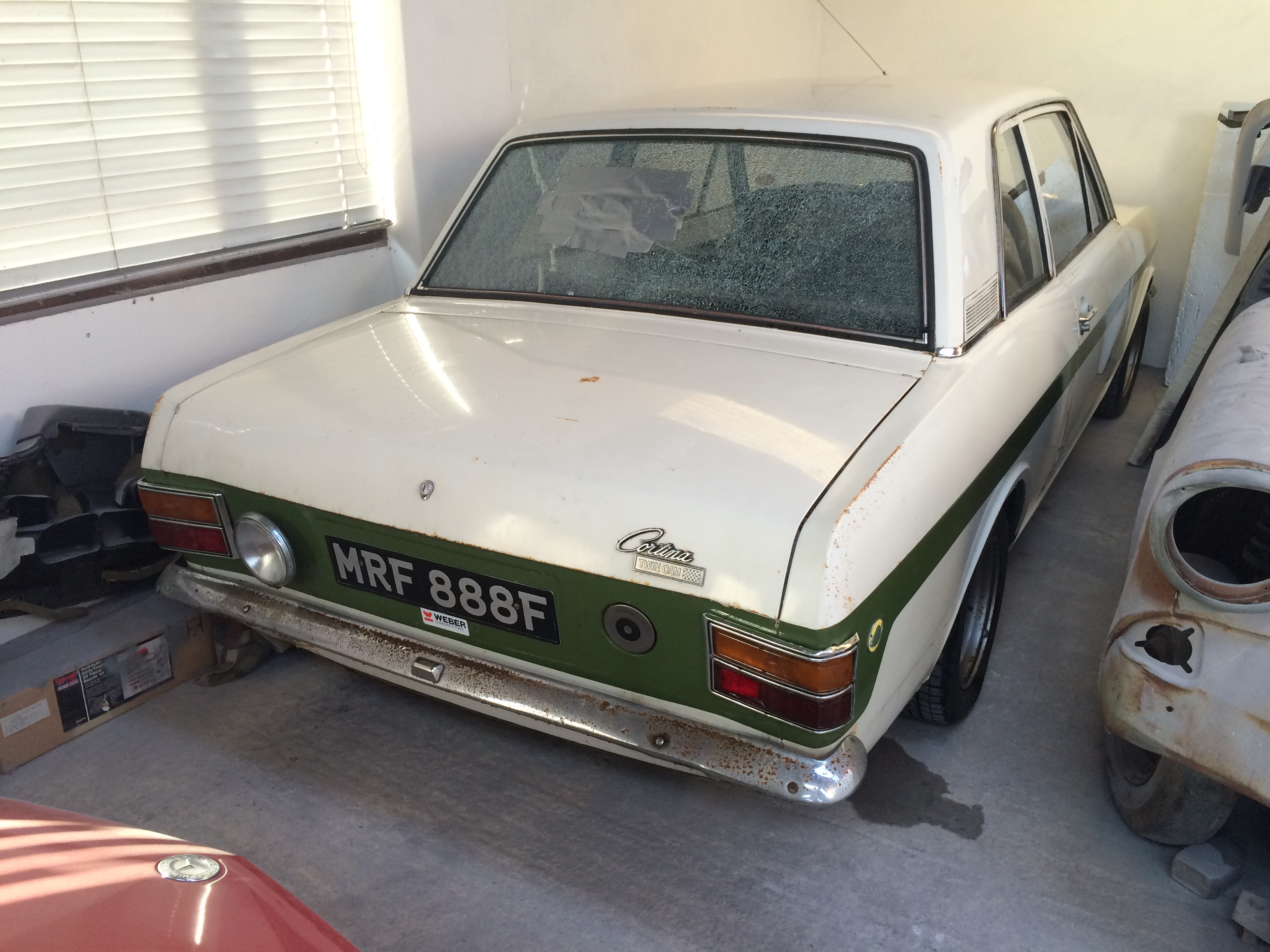

Don't start me on cortina bits lol, I've a mk2 lotus In the shed waiting on a restoration

That's a pretty special old cortina you got there bud! Worth? 25k???
Ever rally it?
If mk3 golf is close you could check the spec on mk1-2 scirocco sills?
Yeah man it's a cool old ford, if it was in respectable condition itd be worth that mate yeah.
Priceless to me sort of.
Sadly some man has removed the original lotus twin can engine, but there's a fully built pinto in it on some nice 40's . I'm 24 so most of my mates just don't get it lol!!
