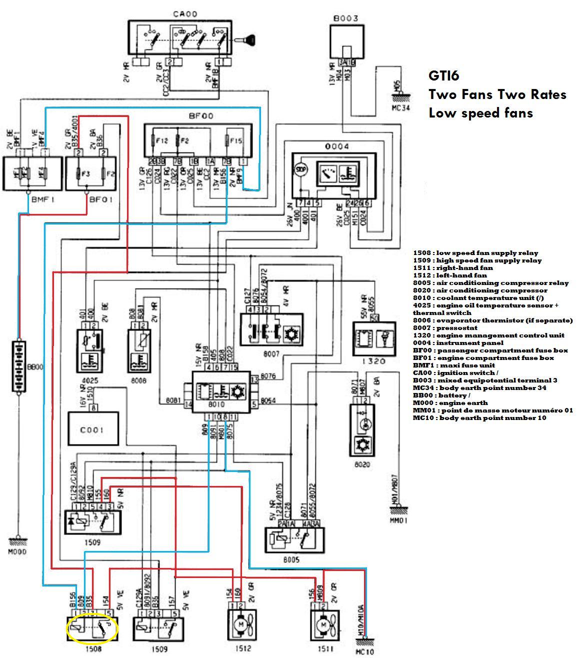

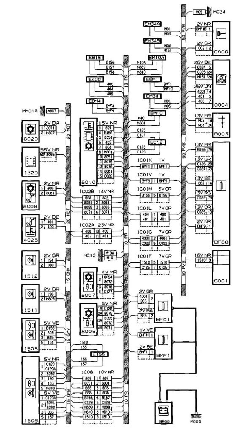

very quick one, looking to save myself a tiny bit of time
what/which wires are positive/negative on the default wiring loom fan relays (HDi Air Con model)
i am wiring slimlines in and using the original wiring loom.
/Toseland

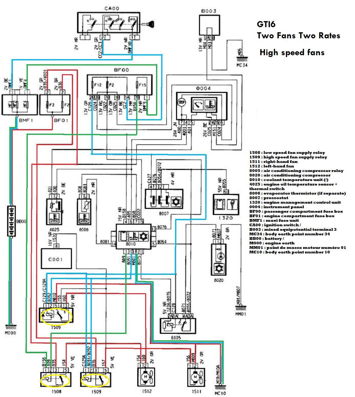

the fans are slow speed and high speed
the way they achieve the low speed is to switch both fans into series mod and to achieve high speed they are connected into parallel mode
GTI6 Info
thanks i'll print those off
those are for the gti6 but the fan loom to on the cowling with the relays will bet the same Wink
