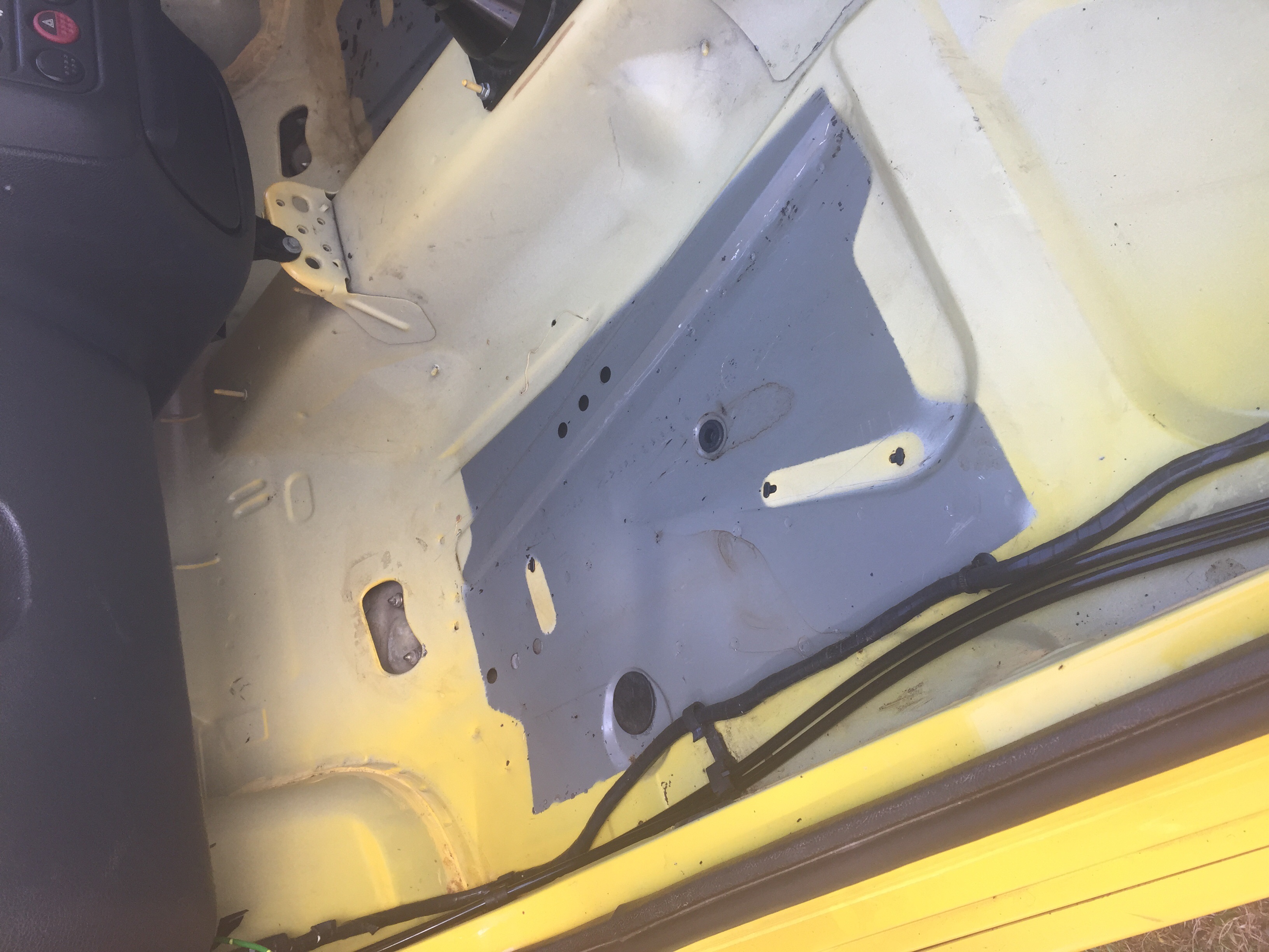

Finally got rid of all the tar stuff in the car, horrible job to do. Only took me an hour to get this piece off

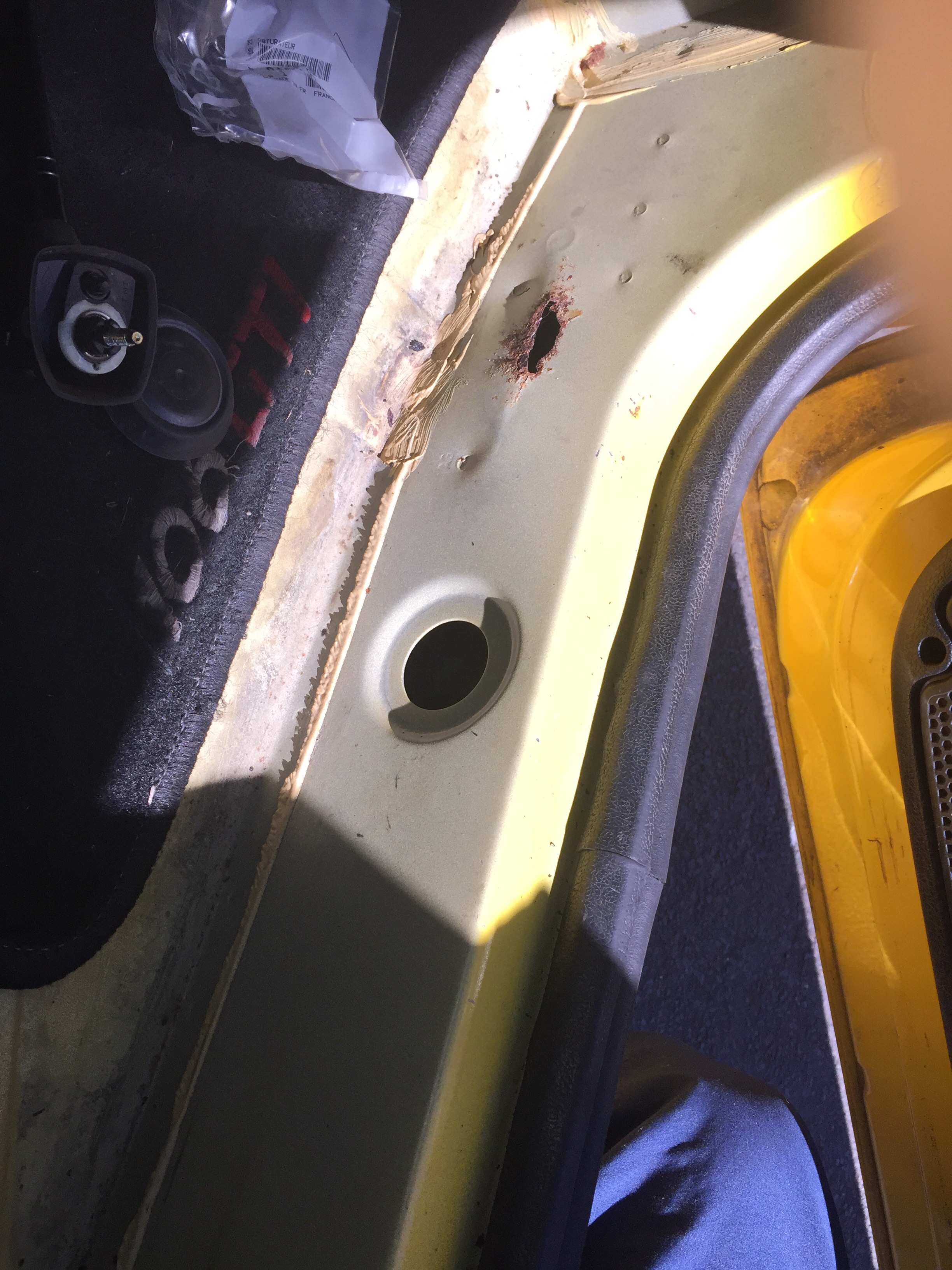

As usual with anything French I find more rust -_- not sure if it's under the side skirt or if it's within the body
you could blend that bit into a cage mount Wink

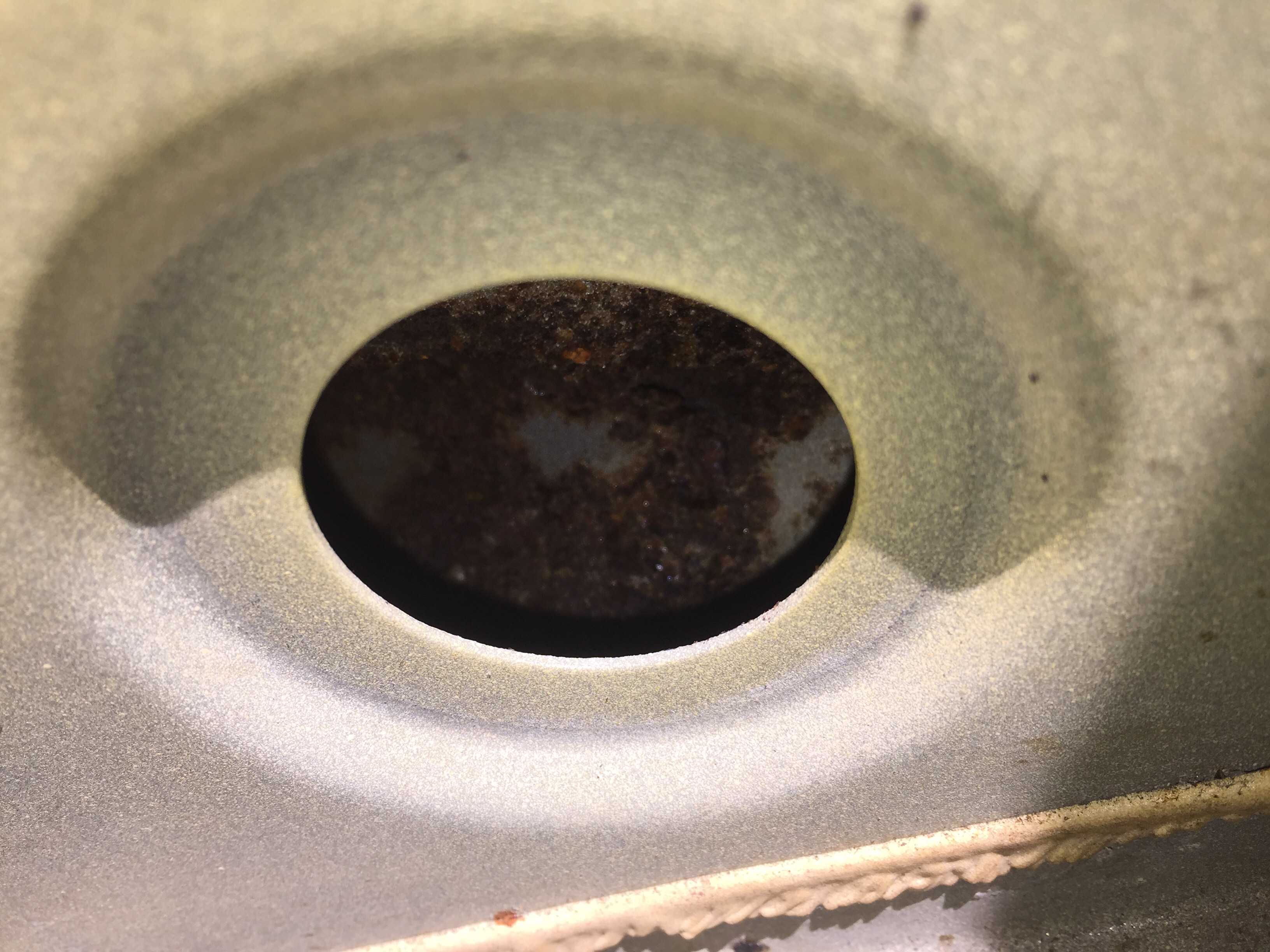

Yeah I would like too for that but if you look inside the big round he next to it you can see loads of rust in there
not much you can do about that other than spray something in there

Yeah it's a pain can snap bits off in there. Just douse the bugger in kurust

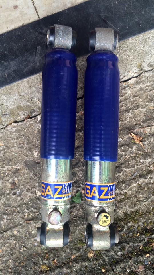

Next on my list is to get the new shocks on the new beam when they arrive and put that on after Pugfest Smile

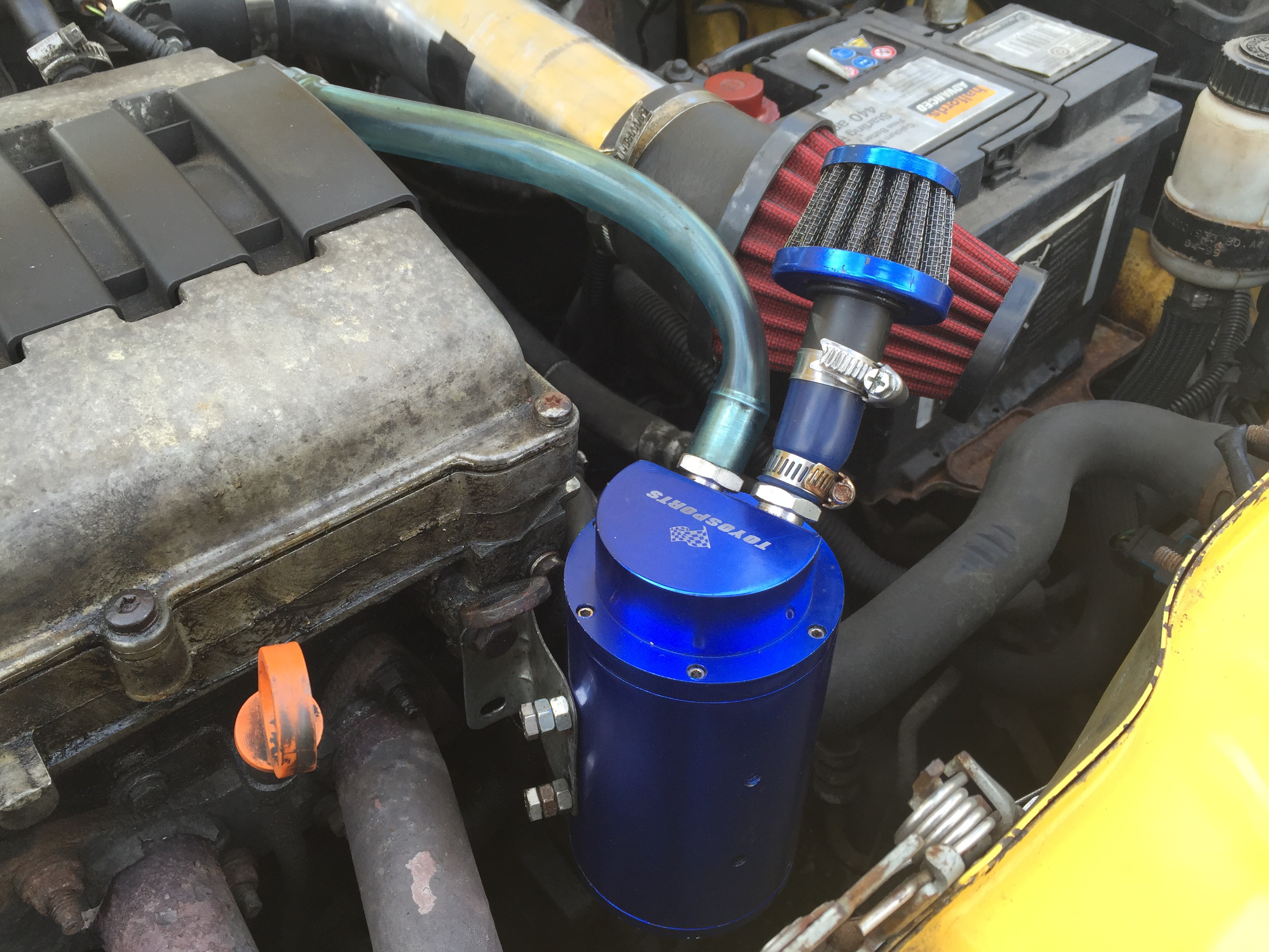

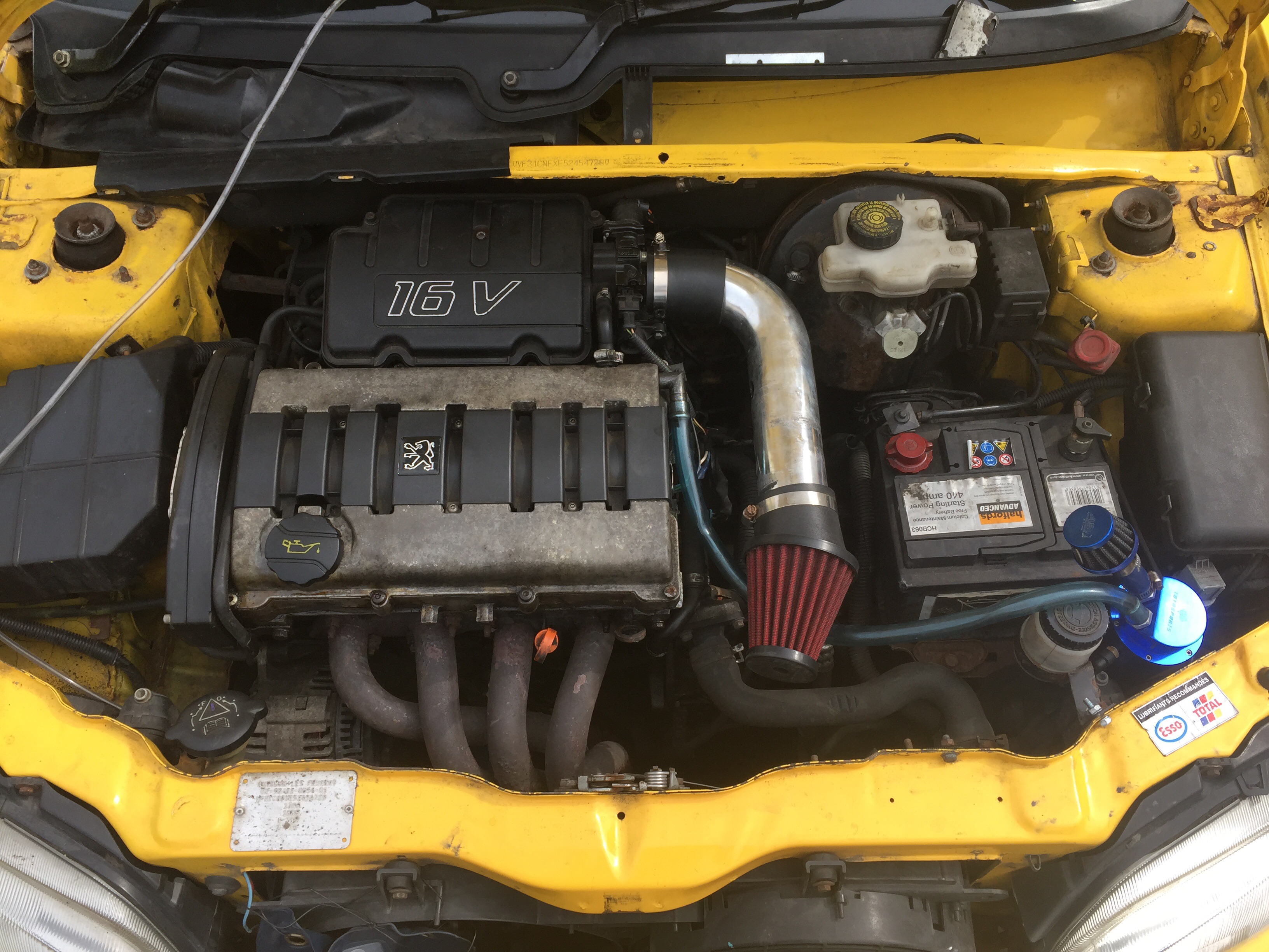

Had a catch tank laying around so I thought I'd put it it the GTi Smile should stop the oil getting in the throttle body and ICV and so on. It won't permanently be in that spot, I'm planning on getting a BMC induction kit so will make more room for me to relocate it

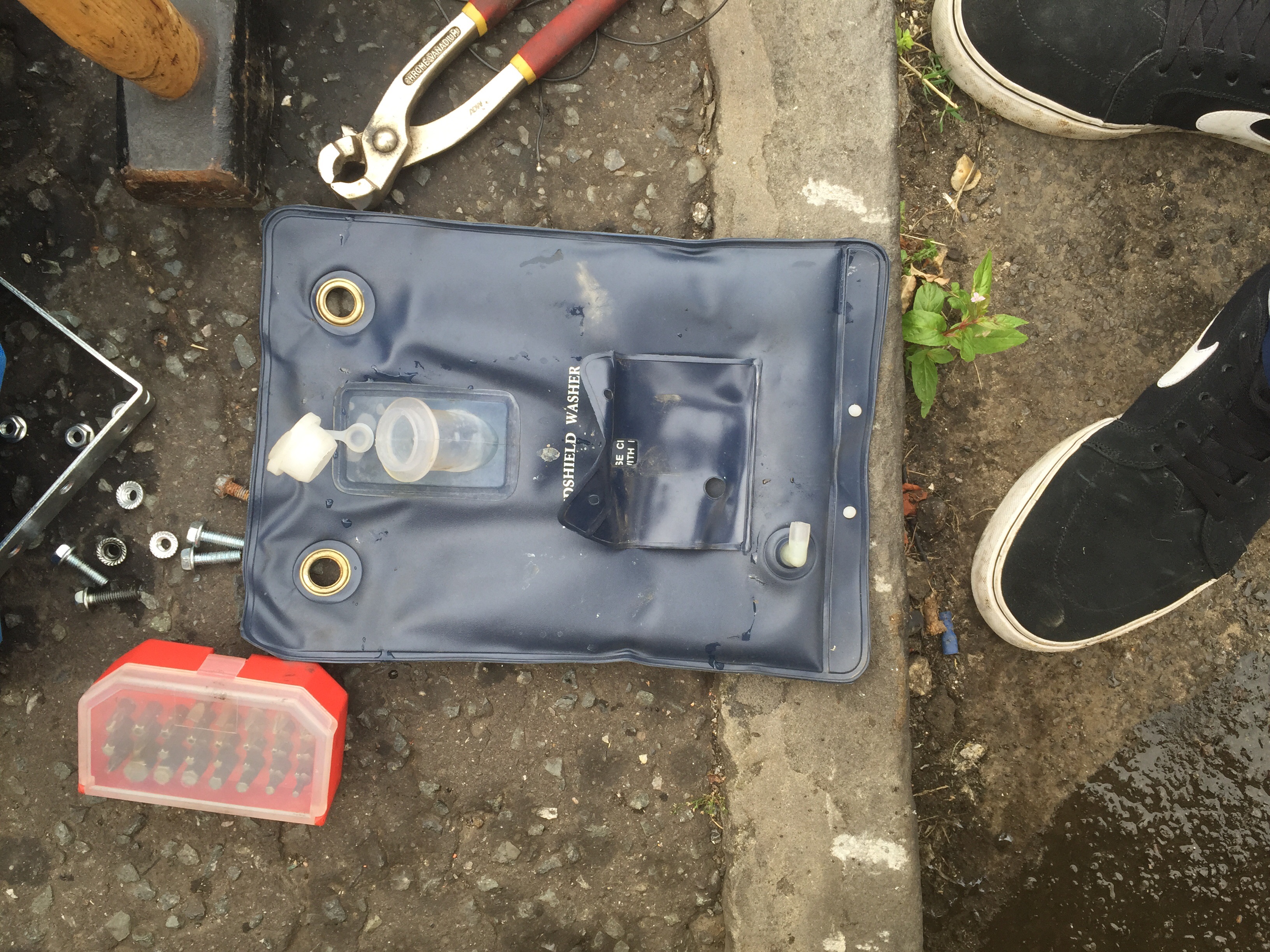

The washer bottle was previously removed due to a plate being welded in where it was so a washer bag was put just I front the radiator. I didn't like it there because it was restricting the air flow to the radiator. So after some research I'm going to fit a 205 washer bottle in the boot of the car as apparently they were located there on the 205 and is pretty much a straight fit. So I've removed that washer bag as I don't actually use the windscreen washers.
got a 205 rear washer bottle here if you want it Smile

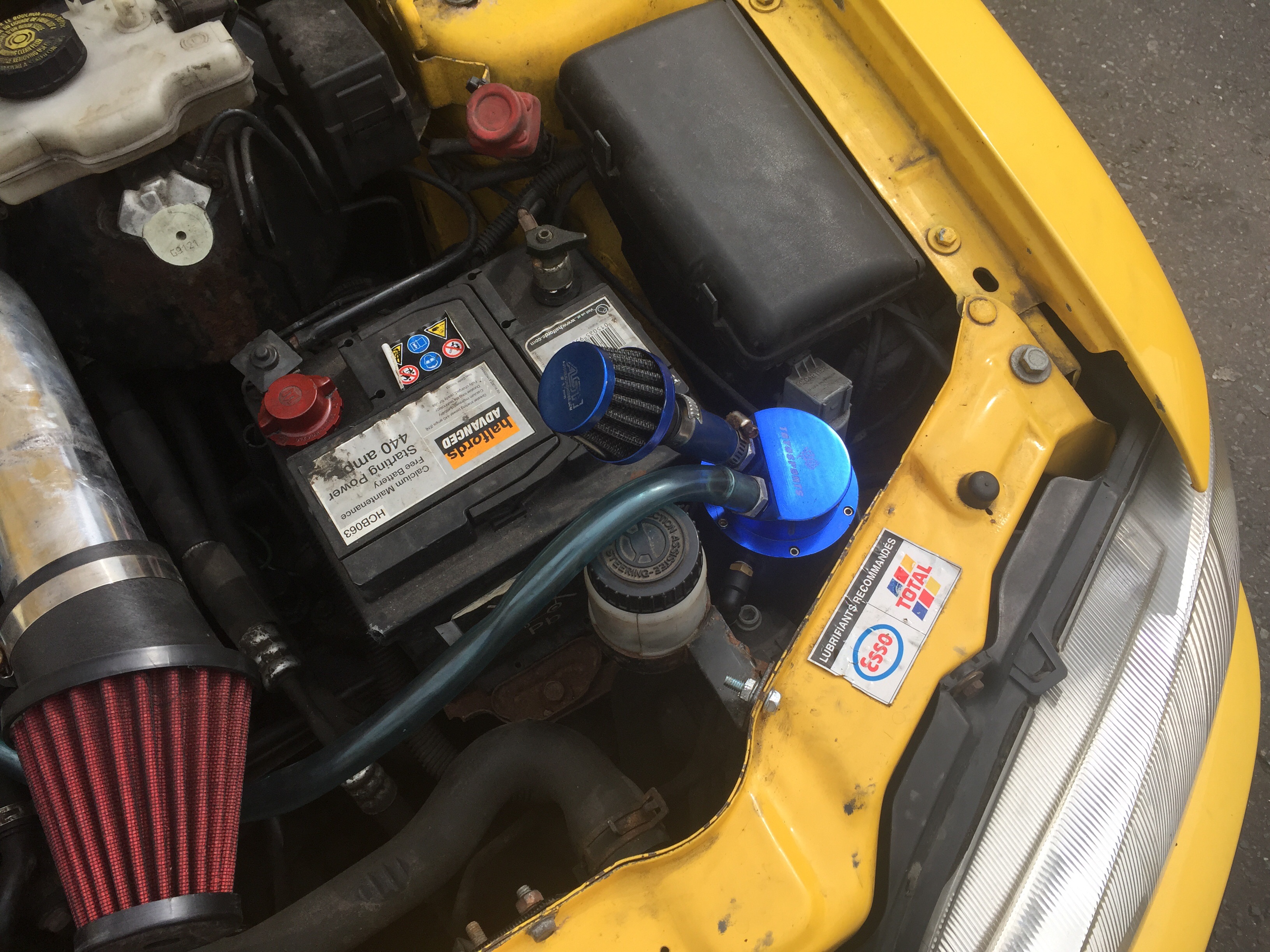

I've relocated the catch tank it's mounted on a bracket coming off the engine block, much happier with it there. Need to invest in some proper silicone hose for it. That crappy blue hose just folds in on itself
The 205 washer bottle came today Smile just got to figure out what way I want to mount it

I'm no perv expert, but that KnN looks awful small and with no cold air flow to it Undecided
(10-07-2015, 10:53 AM)Piggy Wrote: I'm no perv expert, but that KnN looks awful small and with no cold air flow to it Undecided
That's the oil breather, James.
