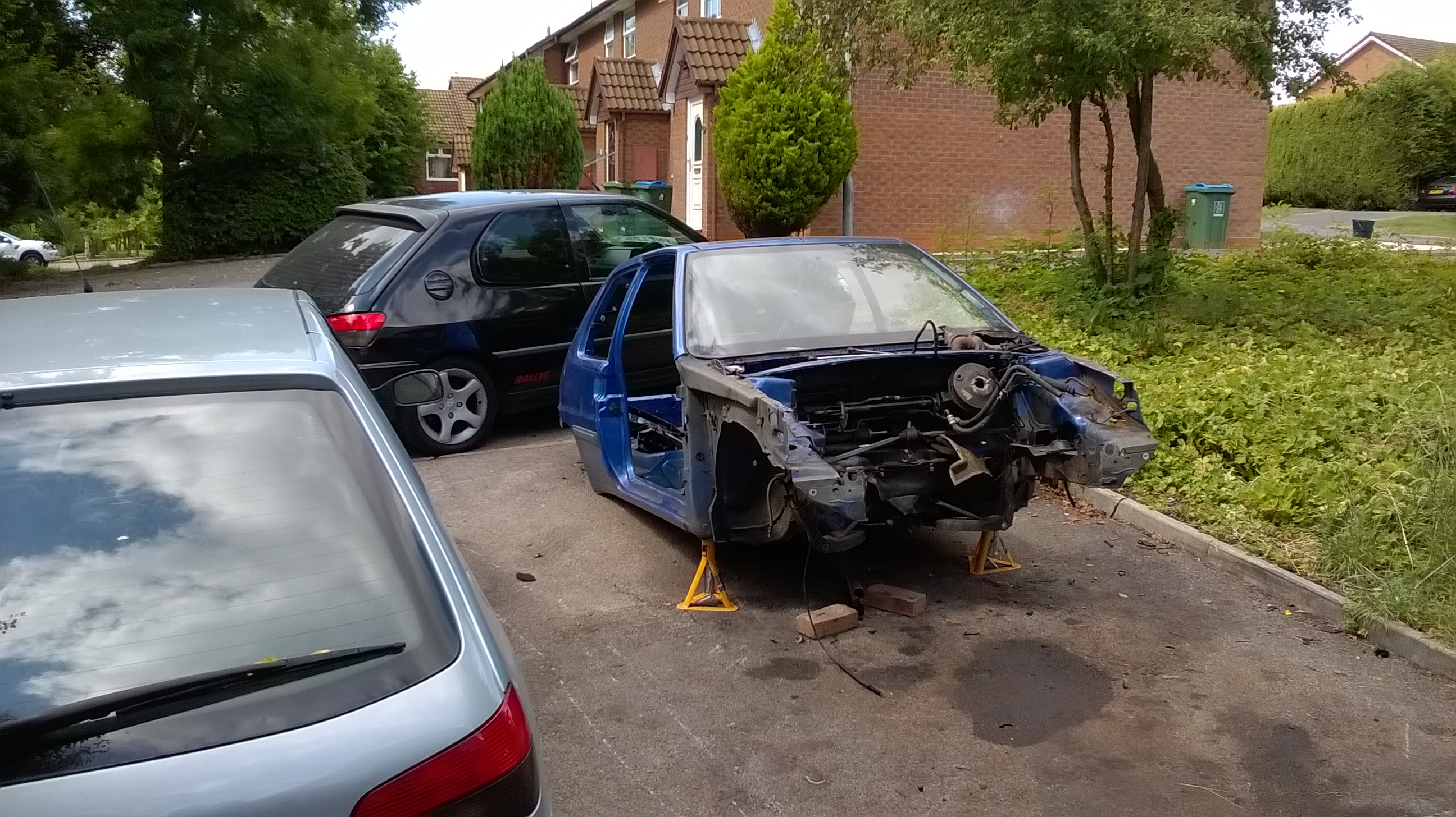

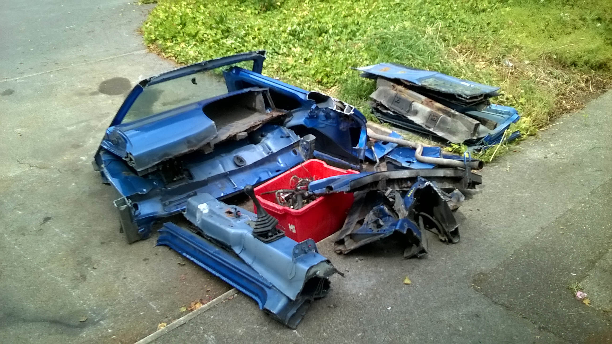

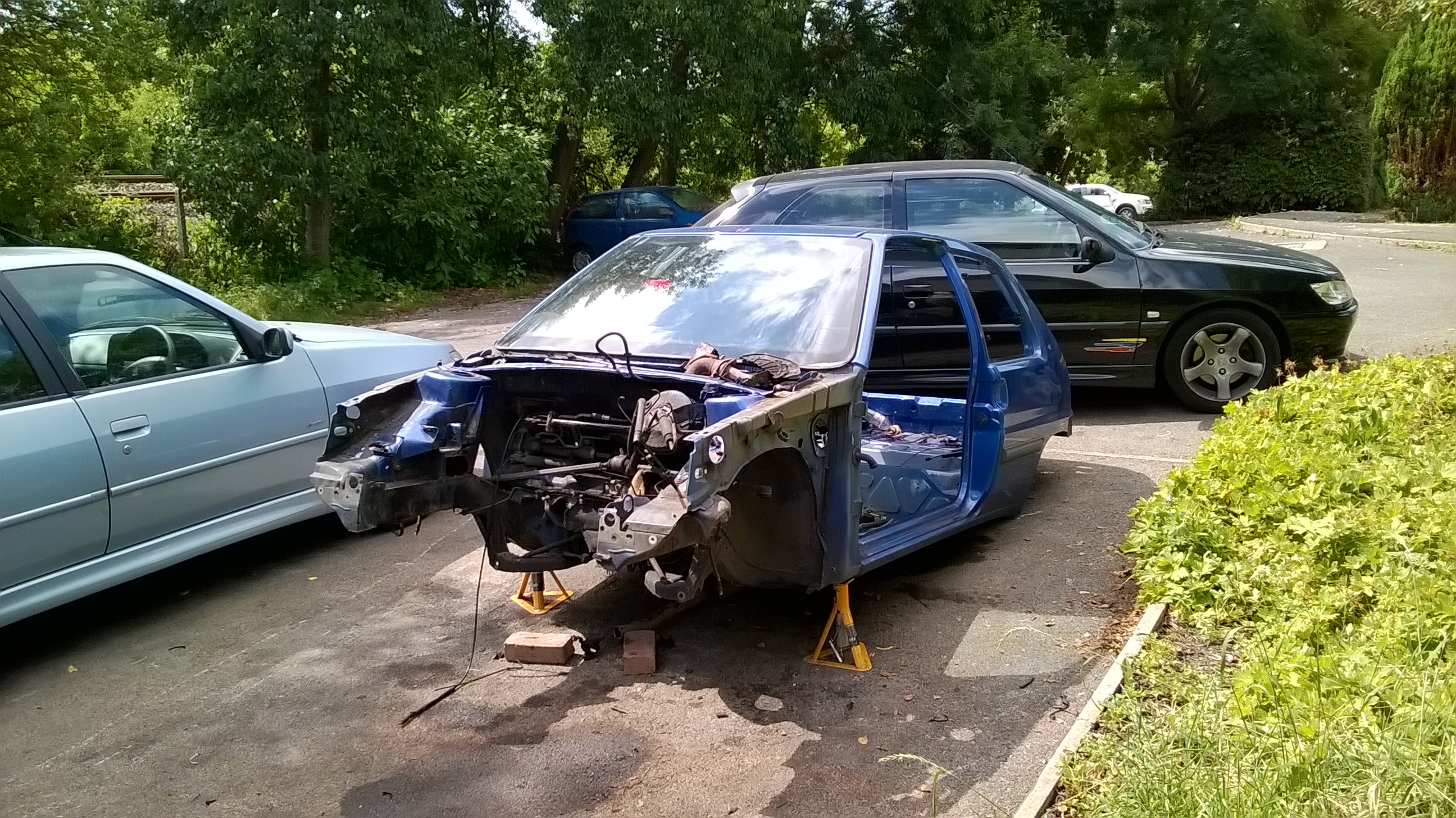

So the 106 is dead, it was far far too rusty to pass an MOT without days of welding but I've kept the engine which will be getting the turbo nailed on before going into a cleaner shell.
Your neighbours must really hate you with the amount of cars you cut up
The real question is why you wore shorts to spring action day when it was cold yet on the hottest week of the year you're in full length jeans!!

(03-07-2015, 09:23 PM)Niall Wrote: Your neighbours must really hate you with the amount of cars you cut up
I waited till they were all out at work cos I'm nice like that. I think they are happy it's not just sitting around on the floor but one has no right to complain as he has had a scrap Punto sitting in the car park for a year.

Yeah this. From cutting the front cross member the day before in shorts I had to wear jeans, I almost wore a long sleeve top and dust mask and TBH I wish I had as my forearms were almost black and the shit I've been blowing out of my nose is black too. Decent protection is especially important with the 9" as it throws shit alot harder and alot further, notice ear protection, goggles and safety boost too.

Christ dum dum, you don't hang about dismantling it did you! what was rotting on it?
(04-07-2015, 11:46 AM)Matt-Rallye Wrote: In our yard aslong as it all comes in at once and has an identifiable chassis number we are happy to write the COD as its obviously still registered to someone. Also the law states we have to take valid (in date) recognised photocard identification (so a driving licence or passport)
If there are any issues at all with the vehicle / scrap remains its all fully traceable to whoever brought it in for scrap and who we paid for it and the matter gets taken out of our hands Smile happy days!
My local yard is really good, they have my photo on file from scanning my driving licence so as soon as the ANPR has the plate they see it's me and you walk in the office and get "Hello Chris". They also have my bank account details on file so I don't need to even take my wallet anymore, really is brilliant.
(04-07-2015, 02:02 PM)procta Wrote: Christ dum dum, you don't hang about dismantling it did you! what was rotting on it?
Rear floor where it met the quarters both sides, offside c pillar, both horizontal box sections that the beam mounts to, where the floor meets to  go up over the fuel tank both sides, around the ariel, both front bumper mounts, both front inner wings, offside chassis rail (not sill) front floor both sides and front wheel arch into offside foot well.
That's all I can remember for now.
how come these go like that? I know rover metros are worse for the boot floors, floor pans and sills. But that was due to the poor rust treatment. I would have thought these were miles better!
The metal feels very thin everywhere, it really is tin foil, the grinder was scything through it much faster than it would a 306.
