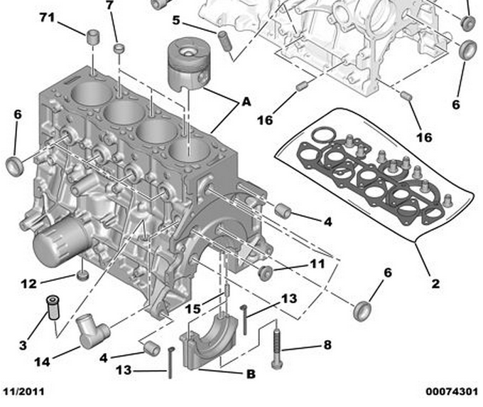

Is the flywheel locking hole viewable in this image?
I have the starter off mine currently, and have only given it a quick look but couldn't see anything under the starter?
Must be there though Smile
(28-08-2015, 09:26 AM)tigerstyle Wrote: Is the flywheel locking hole viewable in this image?
that's a useful diagram, could you repost it with all the picture please as well as any text/part numbers?
much appreciated.
how is the cam oil return elbow held in please.
I tried to copy and paste the diagram but that didn't work.
Srvice Box dude: http://public.servicebox.peugeot.com/pages/index.jsp
Guide on here, create your own login.
