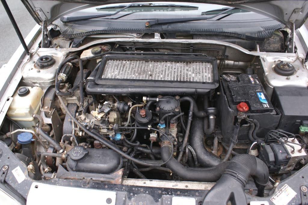

Took it for a drive, initially thought the diesel smell was normal but turns out there was a leak. One of the injectors I think has a corroded return pipe, no visible leak from the fuel pipe. It's the one on the end with the capped return pipe on one side which isn't leaking, I can't see the other side because the intercooler is in the way so I guess it could also be the o ring.
I'll try and upload some pictures when I get home later. It's is pretty pokey when it gets going Smile
Welcome to the world of peugeot...just sounds like leak off pipes that join the injectors together...not too bad a fix.
Thats standard pug ownership. defo sounds like leak off pipe which is pennies from halfords or only about £6 from peugeot.

Turns out I was a nob for trying to use a hotmail account on here the first time round. I've got a leak off kit and intercooler seal on the way in the post

Bit low on powersteering fluid and some rust coming through on the wheel arch behind the windscreen fluid pipe:
[Image: enginebay_zpsba8b506d.jpg~original]

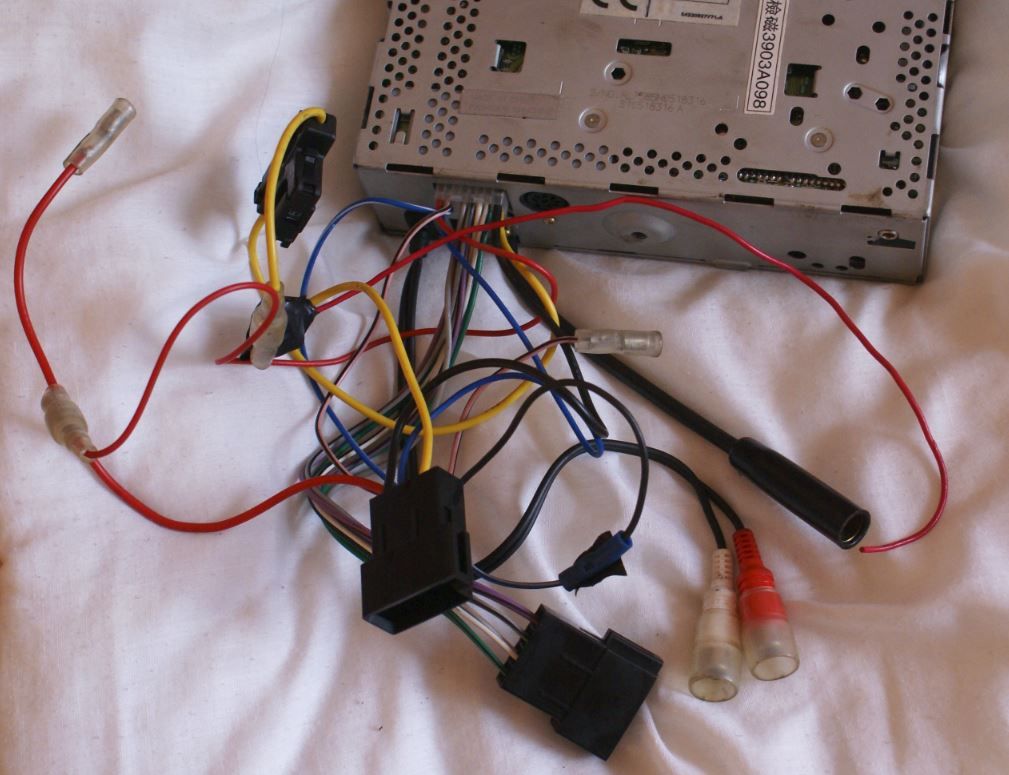

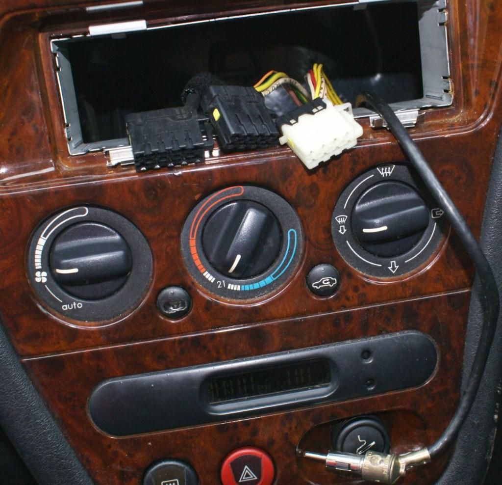

At least the tyres are legal. Another problem is no tunes (not so bad when it can't actually go anywhere), the trader gave me a stereo but not sure how to connect it up or if the detached red cable matters:
[Image: stereo_zpse8026e81.jpg~original]
[Image: stereocables_zps7d7bbb9e.jpg~original]
