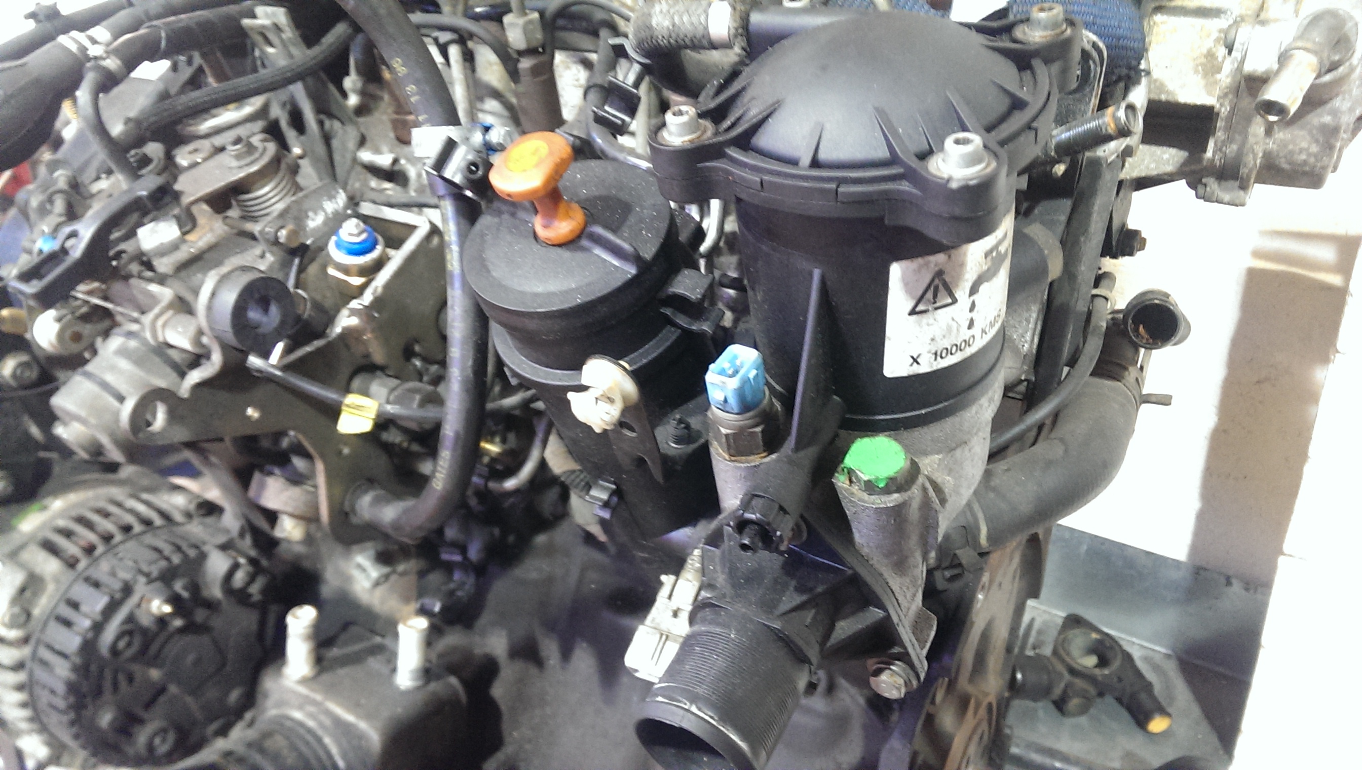

I dont have a 306 but i am putting a 1.9td 306 engine in a jimny.
when i picked up the engine i have no hoses atm or any idea where on an original 306 they might go to.
can some body help me piece together the correct route so i can sort my cooling out.
if anyone can point out where they go. and route to on a standard 306, i believe my engine came out of a m reg car .
1. oil cooler pipes , both of them
2. thermostate housing (im guessing to the rad)
3. where would the heater matrix pipes link to.
if anyone know where all of the pipes route to the engine that would be great
many thanks in-advanced
chris.
1. One goes to the rad one to the thermostat housin
2. To the rad yea
3. One pipe goes to the head one pipe goes to the plastic housing on the lower crank end on the back

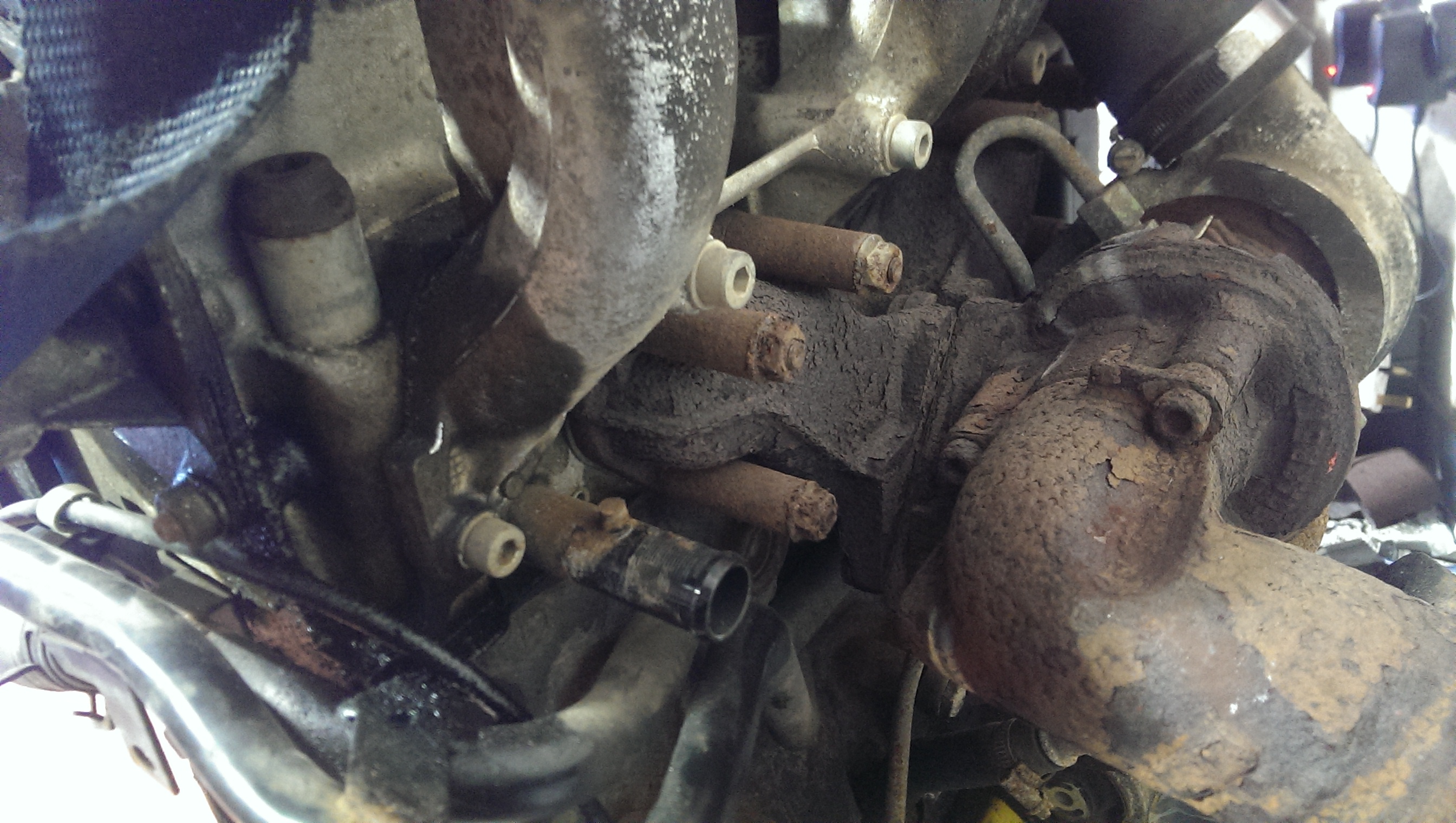

can you tell me where these hoses go to ? a total of 10 coolant pipes.

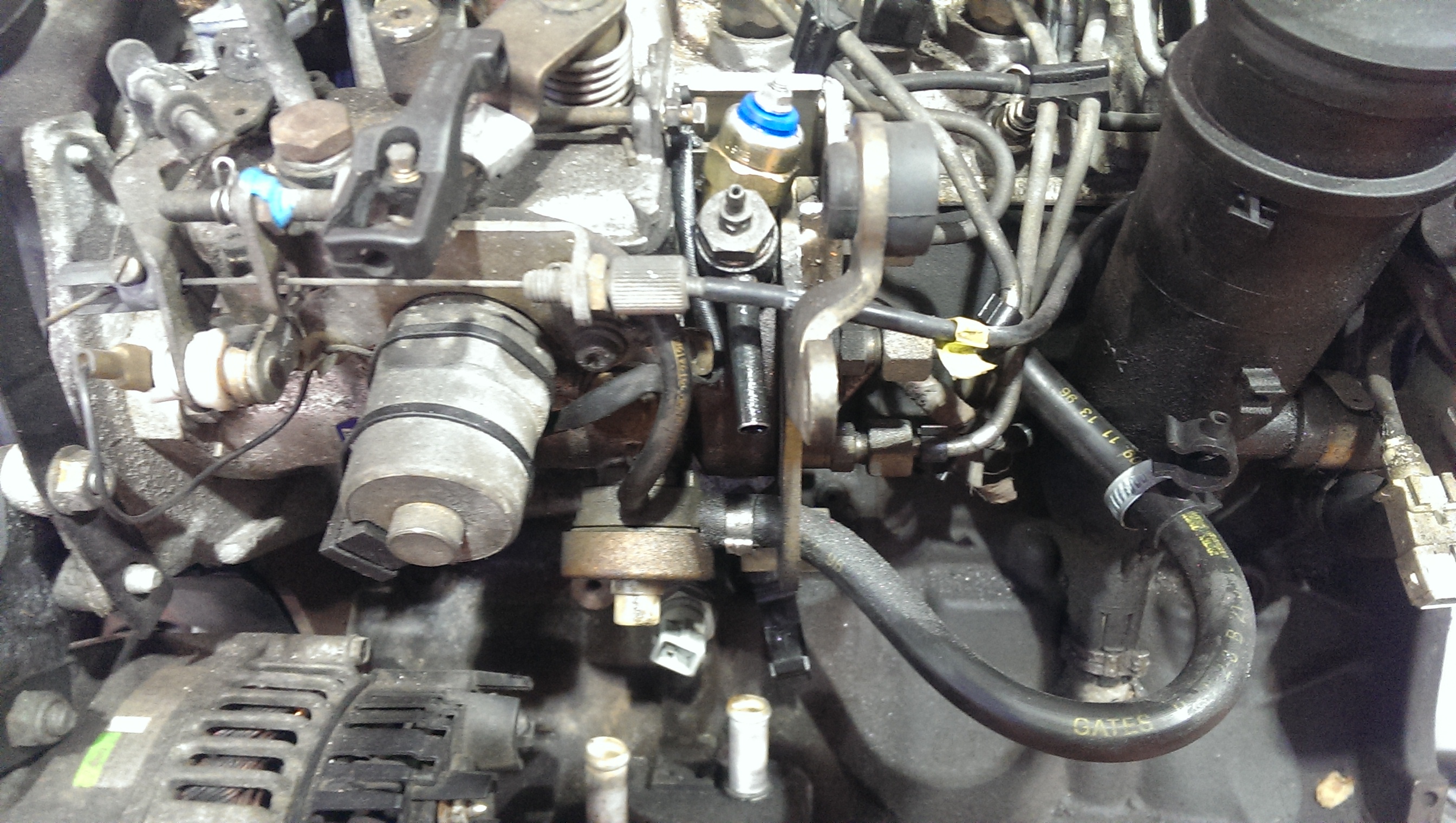

also the last picture . where do the fuel pipes come from . which are return and main feeds ?
and if anyone know what the sensors are for ?

The one on the back of the head there goes into the heater matrix.

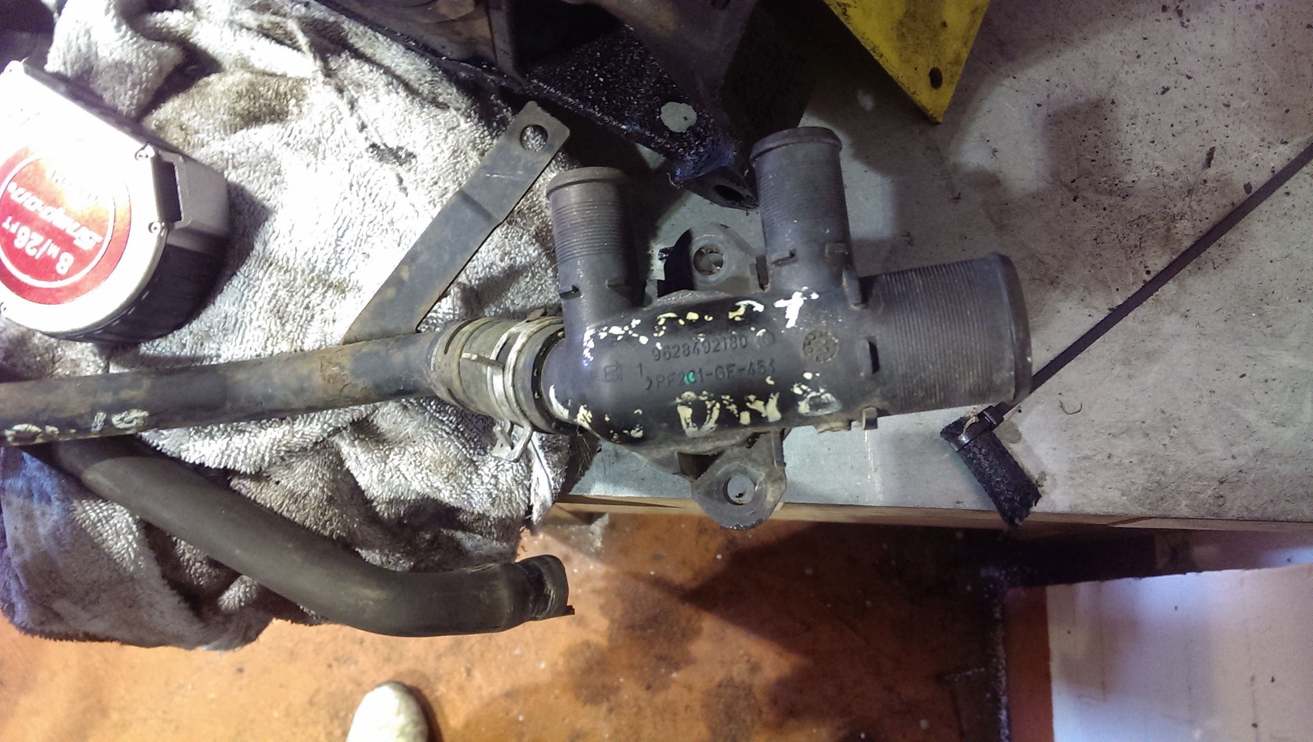

Then on that black plastic housing the big one goes to the bottom of the rad. One of the little ones on the top is the other side of heater matrix, and then one of the other small ones goes onto the metal hard pipe round the block to under the vacuum pump.
Does anyone have the plastic three way coolant pipe for sale, I have cracked mine whilst trying to fabricate a rear engine mount.
ThAt leaves me two now , the one next to injector cambelt end , and the little one ontop of the thermostate houseing
they both link together then go to bottom of the rad.
The one from top if stat housing usually has a bleed screw in it as its the highest point
What he said^^

So let me get this right ,
The top radiator is the return from the engine to be cooled , before going around the radiatorthrough he lower hose which then puts coolant back in the engine via the plastic block at back of the engine ,
The oil cooler pipes ... The pipe that goes from back of engine to oil filter housing feeds coolant in and.returns it back to the radiator to cool it down through the other pipe
Then the two pipes on top of the engine that link together are returns to the radiator ?

you will need a rad with a couple extra pipes...for oil heat exchange and the two small ones off the head.
the two small ones off the head connect low down on the rad.
But not sure if they can be connected somewhere else if using a header tank

can these not be put connected in with the top hose to radiator .?
im guessing the two short hoses allow for expansion ?
which perhaps i can join up and link in to the top of a coolant bottle.
failing this il have to try and make room for a 306 rad with expansion tank built on side
Right I think I may have sorted it ,
Expansion feed hose from bottle gets out in the lower rad hose , and the two little hose go in the little expansion hose ,

Can anyone identify the fuel hoses that come off the lucas pump ,
Also is the multiplug on the thermostate for temperature gauge ? blue plug.
Identify the fuel hoses in what way?
The one with the primer is the in and the other is the return? Unsure on electrical plugs bud, generally they are colour coded!
On Top of the pump theres the hose that is has a banjo bolt through middle of it.
Then just below the fuel stop start solenoid theres another fuel pipe with banjo bolt through middle with what looks like a bleed nipple in the middle
Underneath the Pump theres a fuel union with the black pipe that comes out of it in the picture it is looped round

The one with the bleed nipple is fuel IN. Other is the return.
I think the other pipe is the boost compensator pipe.

(05-11-2013, 10:46 PM)Tom Wrote: The one with the bleed nipple is fuel IN. Other is the return.
Is for wiring my knowledge doesnt go that far into it sadly!
boost compensator ? where would this normally attach to ?

Think iv found the answer... attaches to the intercooler ?
The boost compensator hose normally goes to the intercooler, it adjusts the fueling per amount of boost pressure at the time. So if you connect it to your intercooler system some how it will work fine.
