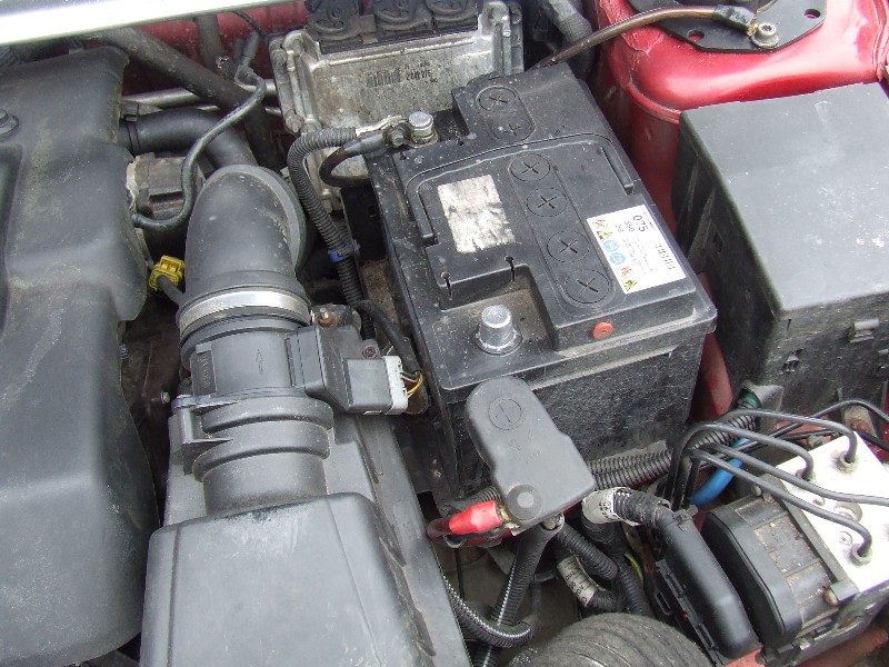

first off i opened the drivers window opened the Bonnet closed the door and waited for the BSI to go into sleep mode then i disconnected the battery

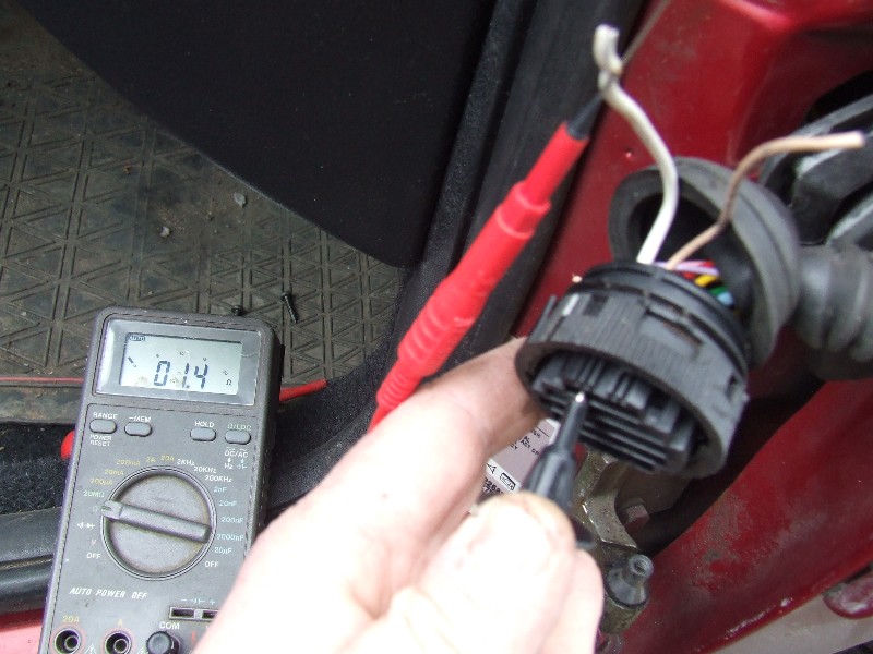

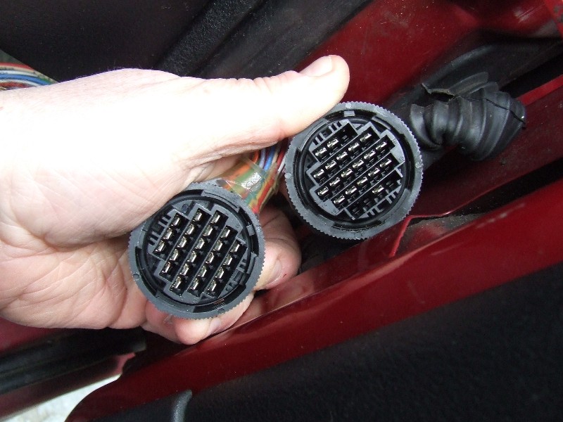

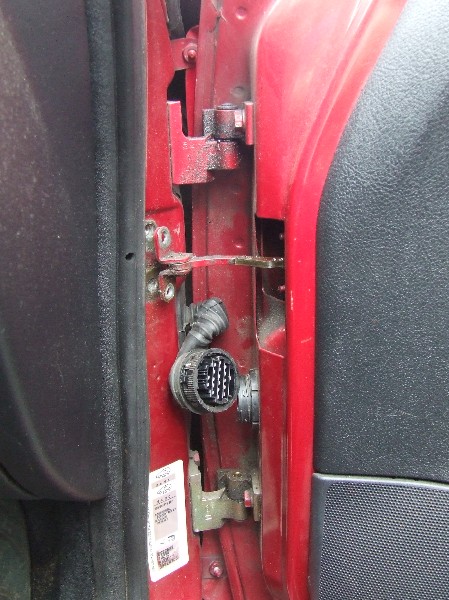

unplug the door loom plug and compare it to one you are replacing it with
make sure you have the same pins or more

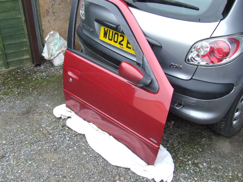

now to remove the door to gain easier access to the plug n wires,
unbolt the check strap and remove the 2 centre hinge bolts the door will stay unsupported,
try not to push the check strap into the door this will save you strugaling later
now hold door via internal handle and window frame and lift the door will lift off the hinge, place door down on soft ground to save paint damage

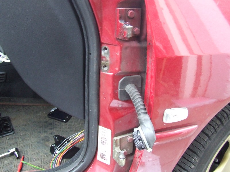

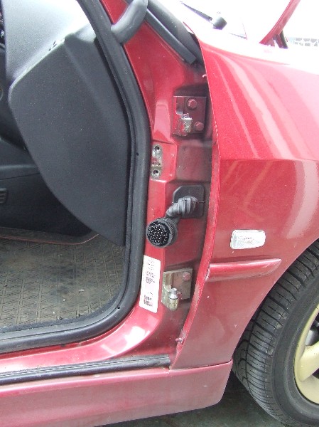

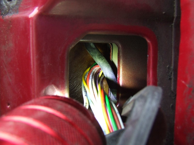

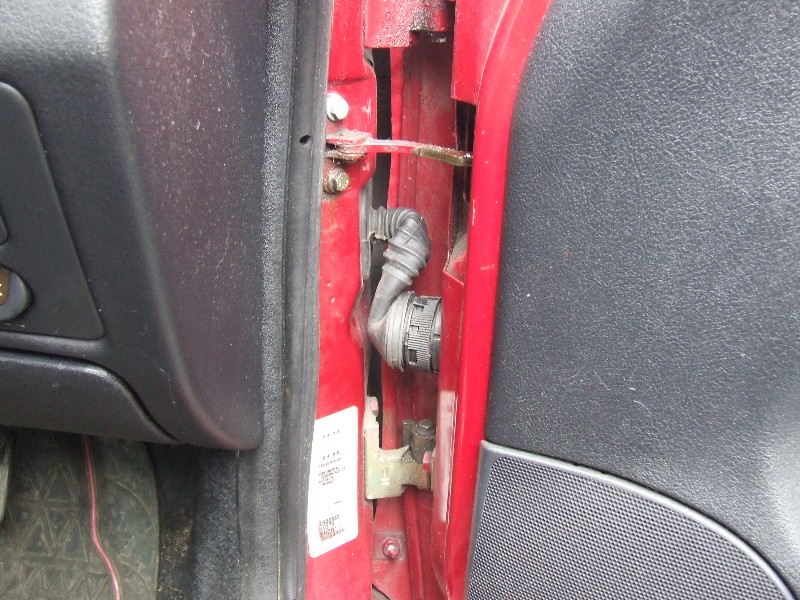

now you have easy access to the plug and grommet

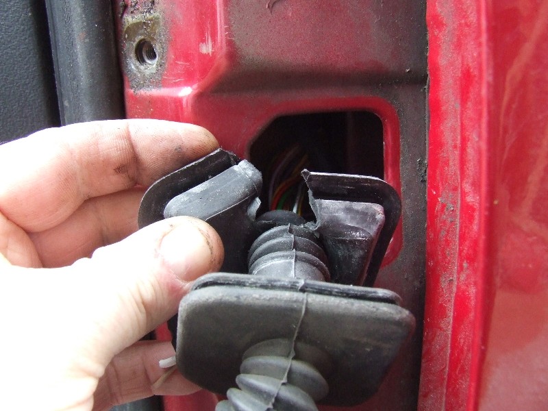

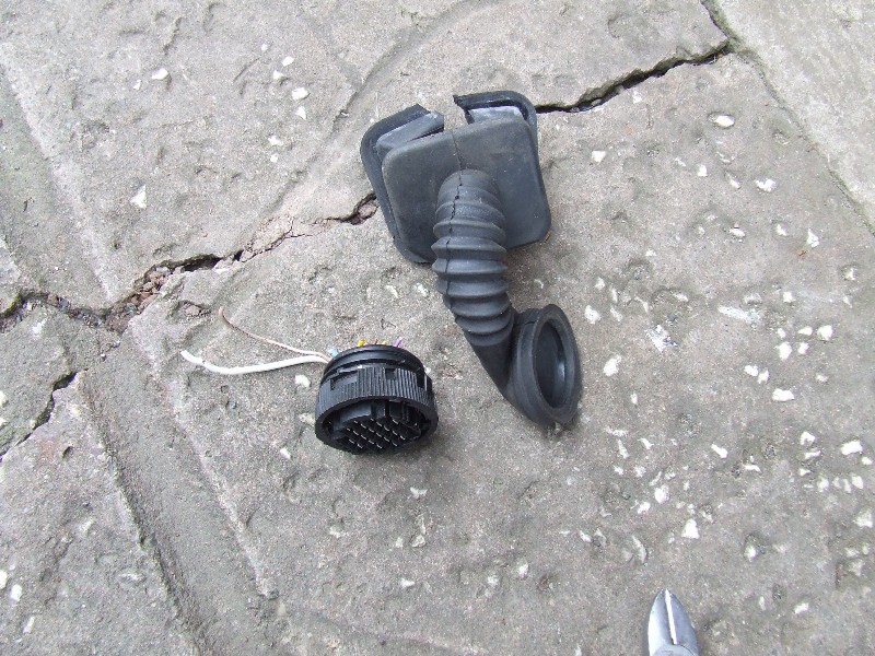

gently prise out the grommet you will find it is a double grommet and the internal section has the rear water squirter pipe going through it,
you will need to cut the inner grommet to release the water pipe
note the Apillar bulkhead is 3 skins!

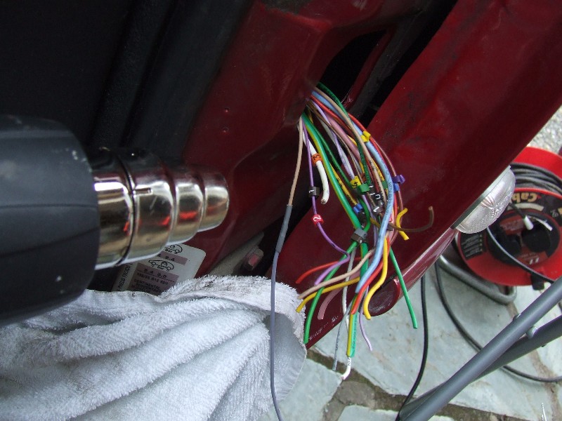

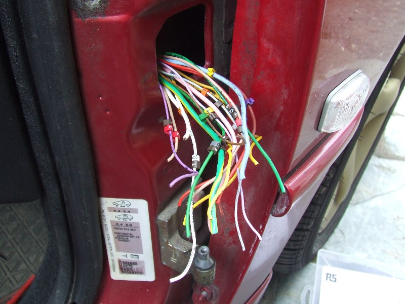

once i had freed both ends of the grommet i could then see my broken wires
as i was replacing the complete plug i removed each wire in tern and labled it with the plug pin position
now you end up with a scrap plug and the grommet which you need to thread onto the new plug n loom

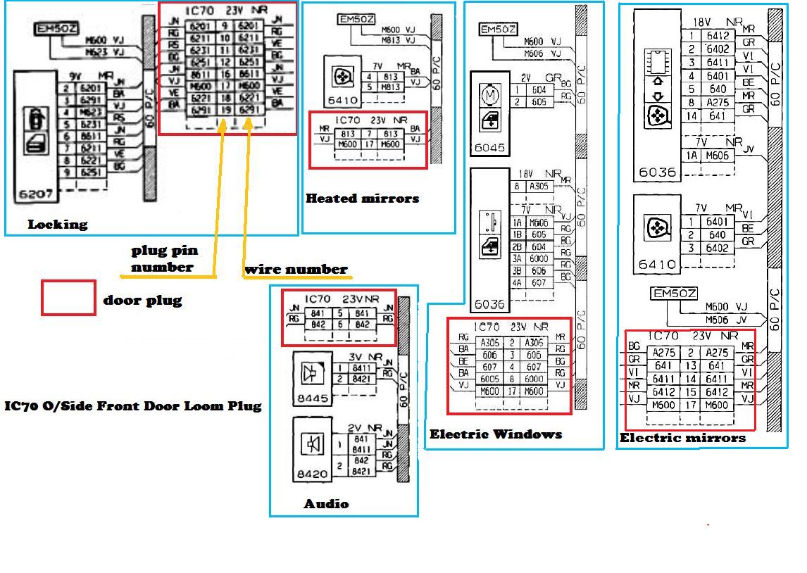

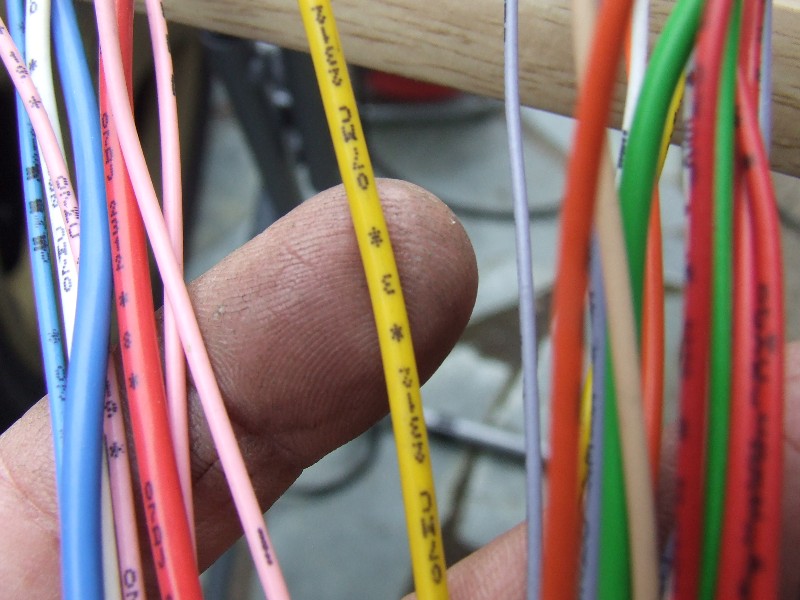

good thing about a new loom plug is you dont need to lable the pins to wires as it is already done for you
see in the picture the wire numbers the number between the * is the pin number
ie: yellow wire *3* THE 3 IS THE PIN NUMBER

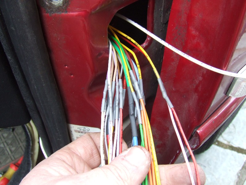

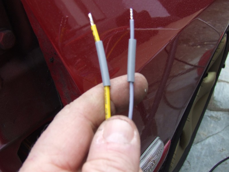

Now its time to get busy with the soldering Iron
But dont forget to thread the heatshrink on first!!
TOP TIP!!!!!
you need 3 hands for inline soldering get yourself some crocodile clips and make a 3rd hand!
now you can aline the joint hold the solder and apply heat
Heatshrink as you go
soldering larger cables
all done!

dont forget to insulate the unused wires as you dont know if they are connected in the door side
now you have finished the soldering you might want to test your handywork
to see if you have fixed or caused more issus ! Big Grin
i brought the door to the car and plugged in the new plug as it was on a long lead
just to test and it all worked!

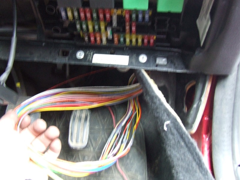

now you have to pull the cables back into the car and refit the grommet,
you might have to release the carpet on the A piller to enable you to pull the cables through, i also had to use a wire hook to reach up and pull them in as i couldnt reach the hole
now its just a case of refitting the door plugging in the plug and tidying up the wiring inside the car so you dont get your feet tied up

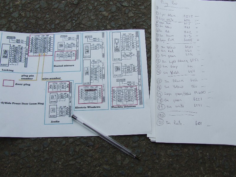

few extra pictures of the notes i made just incase the numbers fell off i put on
the drawing i had were 99% correct with just one wire number incorrect

you wont pull any more wire out of the car as the loom it taped tight and runs up against the exit hole behind the fuse box on the A pilar
