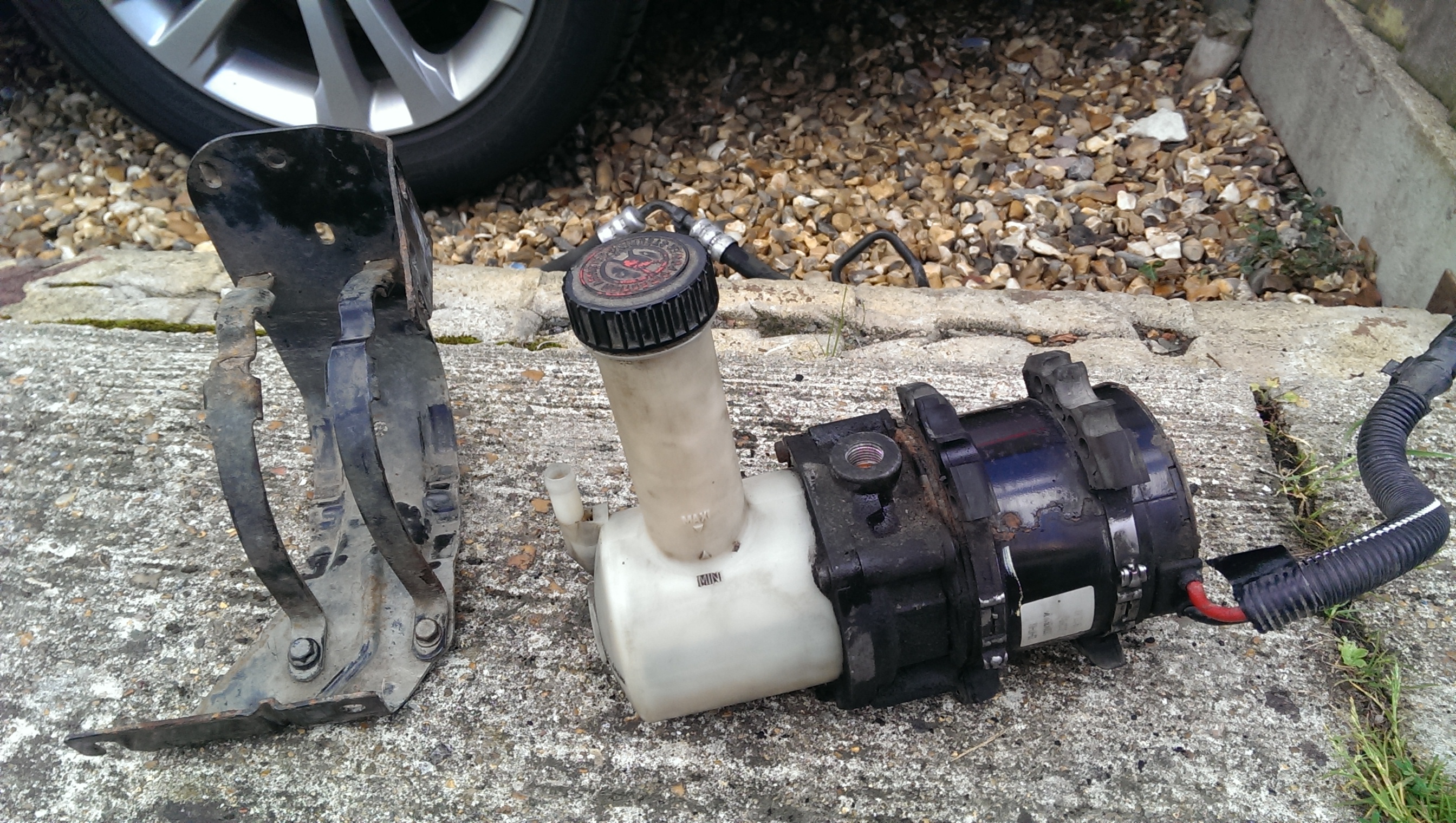

You can pick up a pump from a 106 or saxo from about 2000 onwards. The pump is down in front of the gearbox (where im mounting mine). On ebay they go for anywhere between £40 and £120 quid. I was lucky and picked mine up today at the scrap yard for £30. I would also try and pick up the loom as well. it has its own small loom which will make your life so much easier!

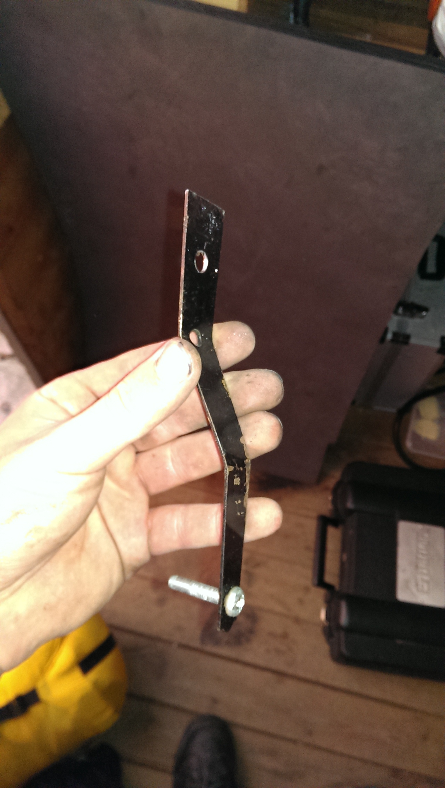

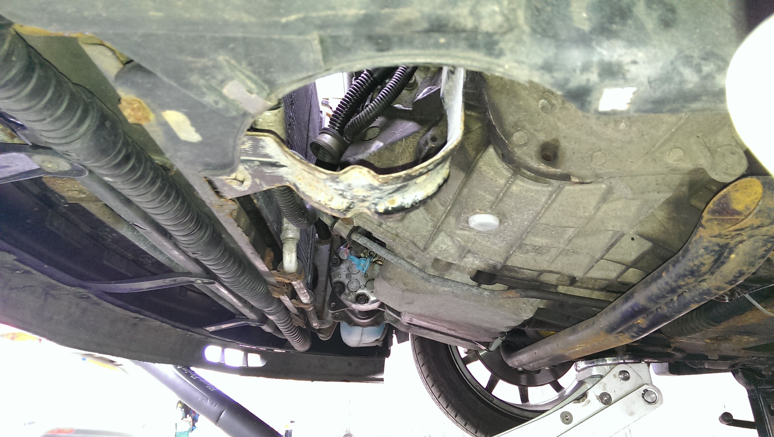

So firstly, remove the pump from the bracket and jack the car up. If you have air con, you will have to remove or bend the right hand pipe out of the way. Mount the front of the bracket to the front cross member. you will then need to make a bar to hold the back end of the pump bracket up. I bolted it on at the ABS bracket bolt and the other end to the bracket
No prizes for anyone who can guess what i used to make that strap Wink
Bolt it all up and make sure your pump fits in. The front bolts are difficult to get to but can be done.

Its connected to the pump in the 106/saxo's as standard. Its a really good design TBH, its all waterproofed and within its own housing unit. Ill chuck a picture up later unless Niall beats me to it.
