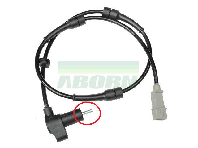

on the rear abs sensors a had to cut the pin down a gd bit in order for the abs sensor to go in as the pin was far too long and hittin against the hub could it be anything to do with that its still pretty close to the hub
you cut it ?.............you killed it then.
you cut the sensor?! Oh crap.
that maybe ya issue! lmao
had to Sad the pin was far too long theres still a bit of pin the gap between the pin and the hub is about 2mm from the hub
am taking it down to my mate tomorrow for an mot so a will just get him to sort the abs out
was the pin circled that i gave a wee trim
