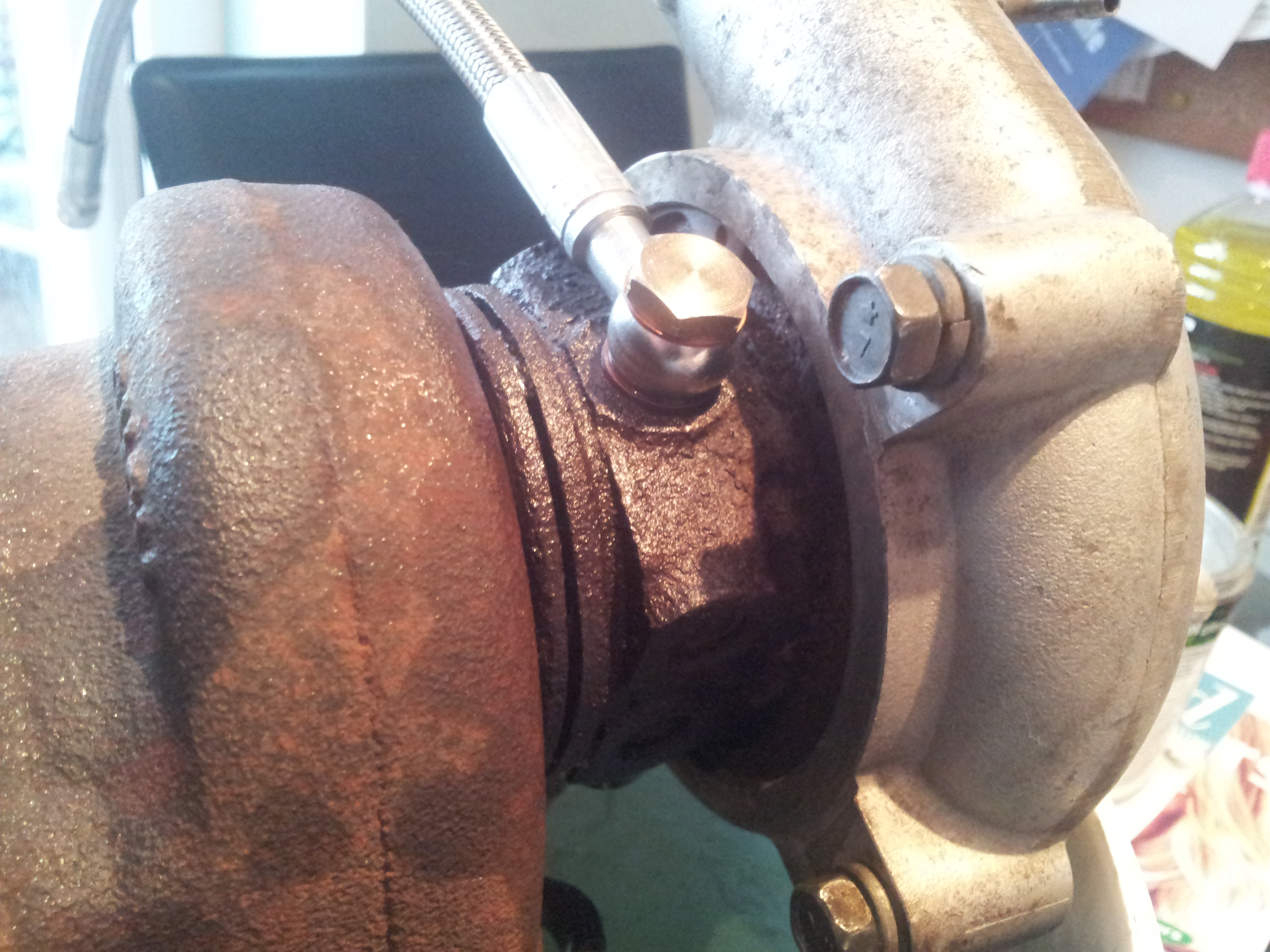

Sorry to jump in here but that pic at the top is a TD04 for sure but, is it just me or is the hot side welded onto the centre cartridge?! it looks like someone has lost the band and welded it on instead..........
Because if I'm tight your pretty much fecked and have been sold a heap of crap that is totally useless to you making it time to look for another turbo, hope it wasn't expensive!
Can't really tell from the pic though if i'm honest Tongue
Team Orange Engine Bay
Just clicked on the image and blown it up to full size and I can see what Mark is saying, I believe he's right. There should be a visible line where the 2 pieces meet.
Nah dw its defo not welded! It has a clear line to seperate them. Thats just a bad photo!
^^ I will trust what your saying but that pic doesn't make it look any better :/
if its not welded it looks like it will be fun to remove lol
Doesnt look welded to me but casting looks a funny colour to say its not been welded!? Unless its just my eyes certainly looks like some heat has been produced or applied

Heres a close up photo as im home -
Chisel and smash to f*ck lol
What are the 2 holes in between the oil feed and the drain pipe? 2 on one side is open and the other side is capped off
