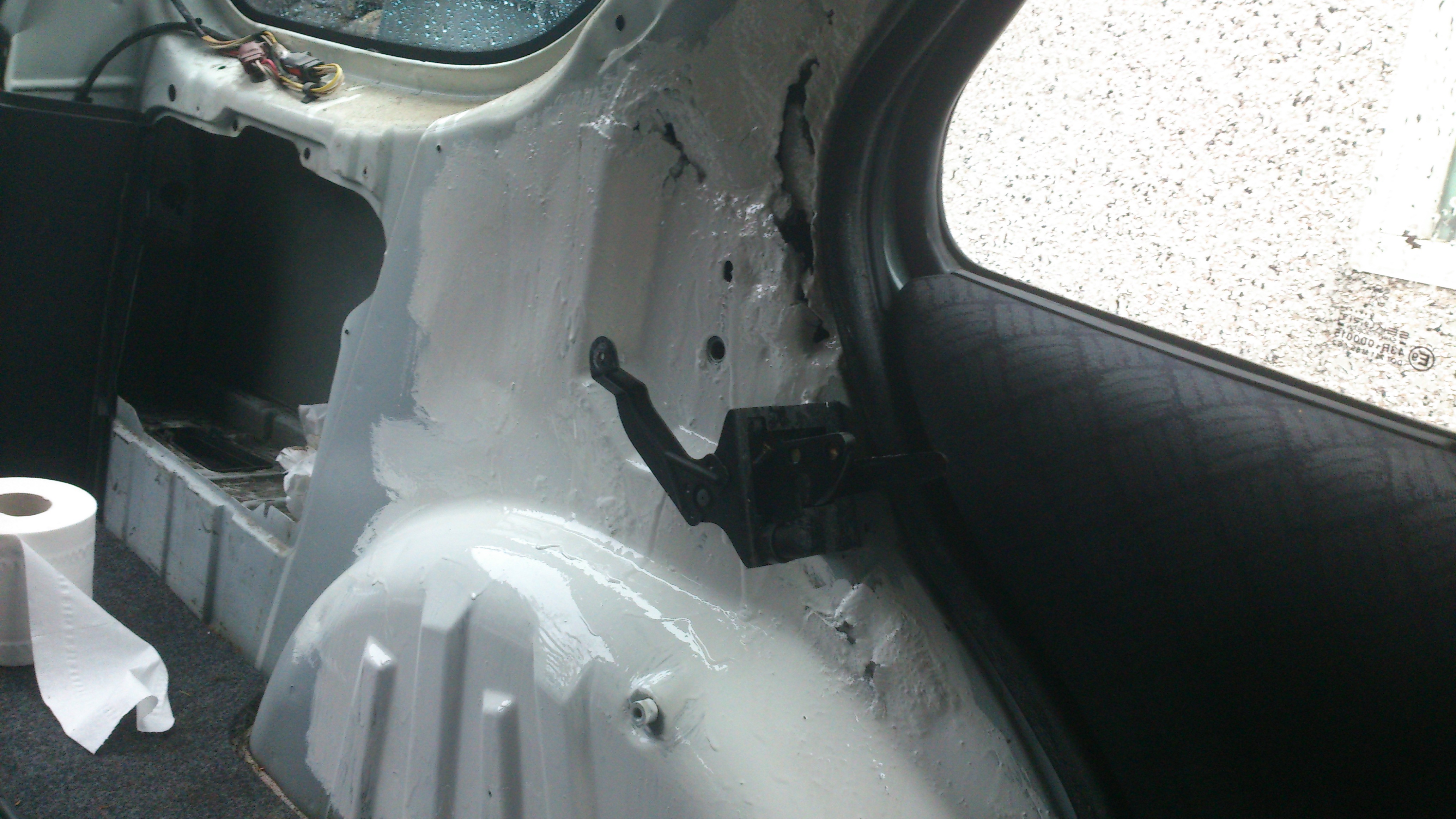

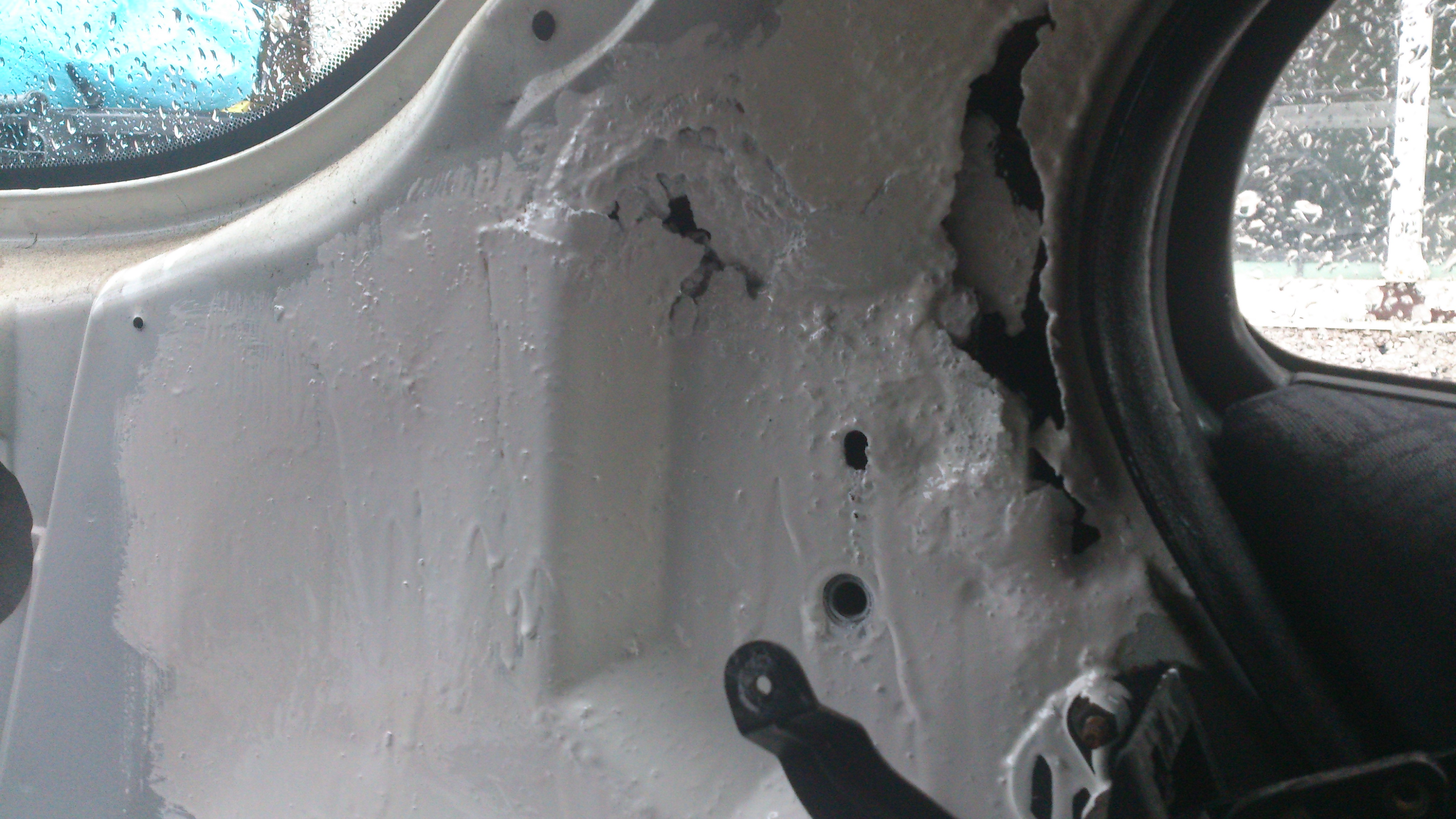

Just been replacing bits of trim which were missing from the estate I bought from Bengley (Birk's old car) and have discovered an alarming amount of rust around the seatbelt mounts in the back. I have just plastered in in hammerite as a temp solution but it WILL fail the next MOT like this.
Does anyone have the skill/knowledge in repairing something like this, obviously I would pay and be prepared to travel, just really concerned as my daughter sits in the back so need this done asap and don't really want to get raped by a body repair place.

Sand the rust down back to metal. Put some rust eater on then paint Hammerite. Smile
There is f*ck all metal left! Just gaping holes! Phone being gay I'll get a pic up in a mo
As you can see most of the inner skin will need to be cut out and replaced

That doesn't look too good, seen others like that getting cut out and welded up which is the way I think I would go with it
(28-01-2013, 01:57 PM)wil_Dtub Wrote: That doesn't look too good, seen others like that getting cut out and welded up which is the way I think I would go with it
Exactly but I just dont have the expertise or equipment to do it. Just could really do with someone who has done something similar before that would be prepared to do it for me.

Holy shit that's bad, I never even had that back panel off to notice it.
[Image: 704e7db1.jpg]
Ouch that's worse than I thought :/.
You'll need it welding. Best bet if you don't know anywhere then go to a body shop.

Its from the lack of the rear arch liners, water from the back wheels flicks up and rots away at he inner arch, I've seen it before on a 306, just not this bad. I may have to go to a body shop but its gona cost bloody hundreds thats why I thought I would post here first

You would do better cutting an entire inner arch out and welding it in. Thats a lot of rust!
Ok ive seen it today. Its bad! I need an inner arch asap!
