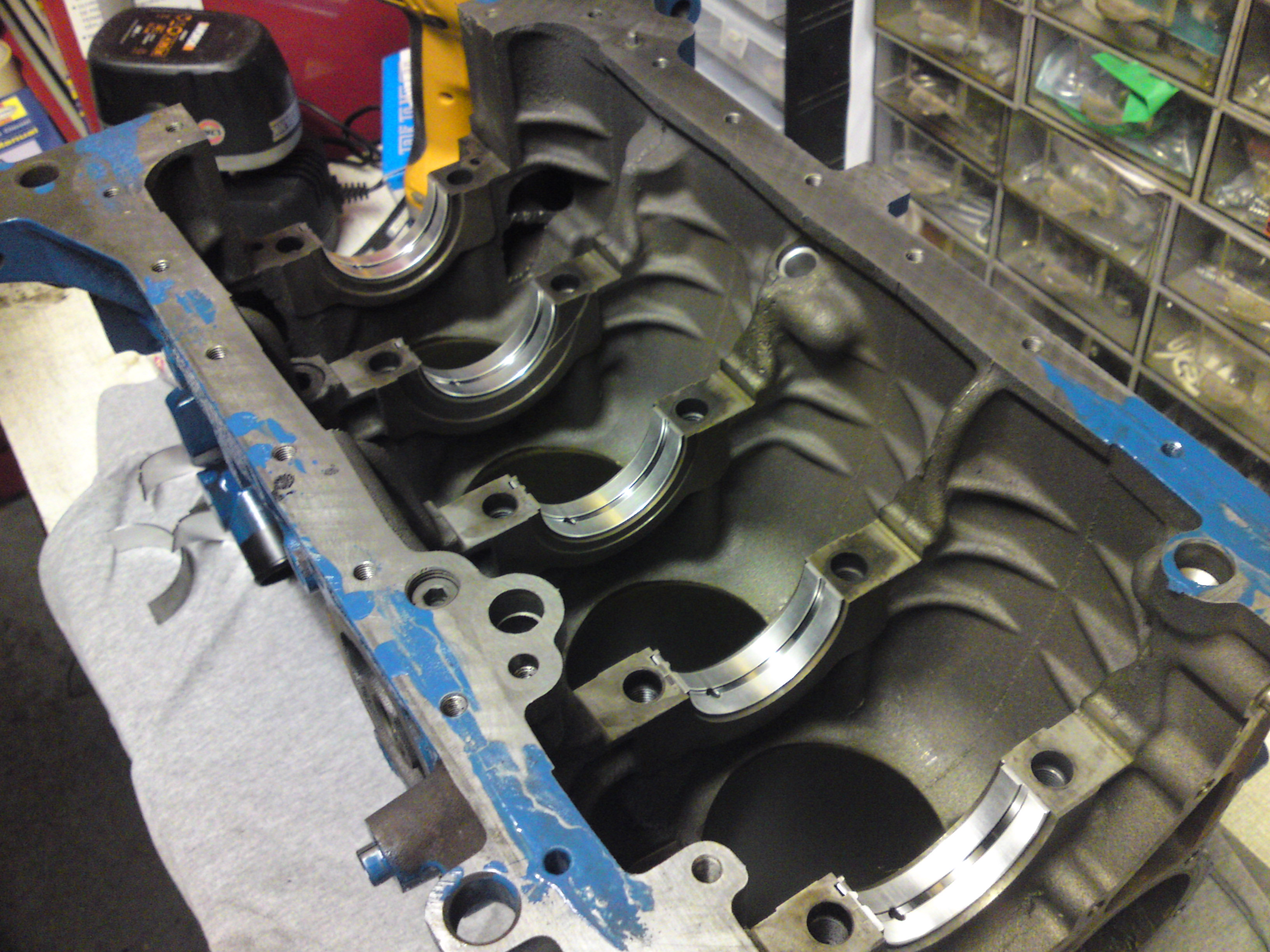

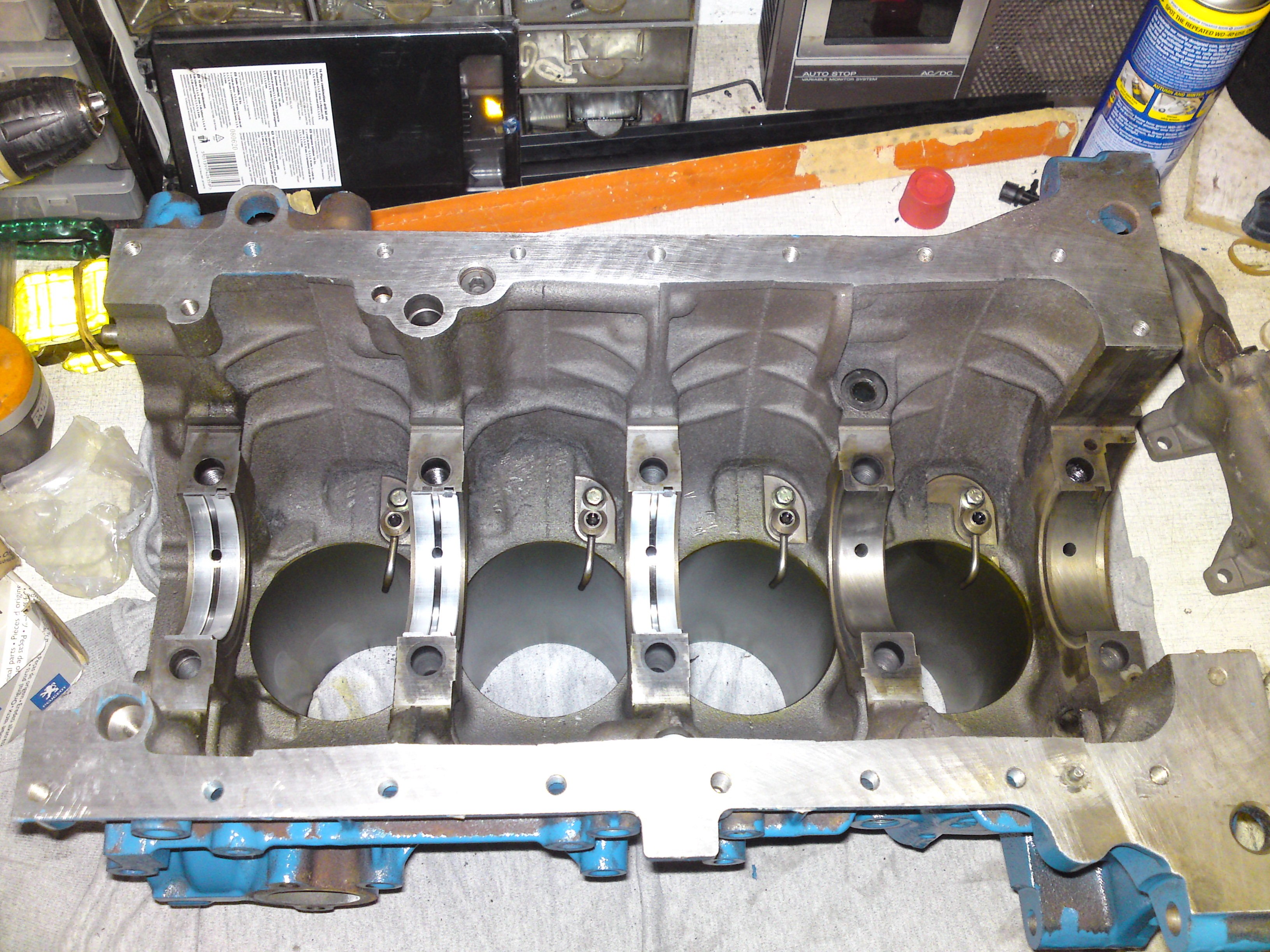

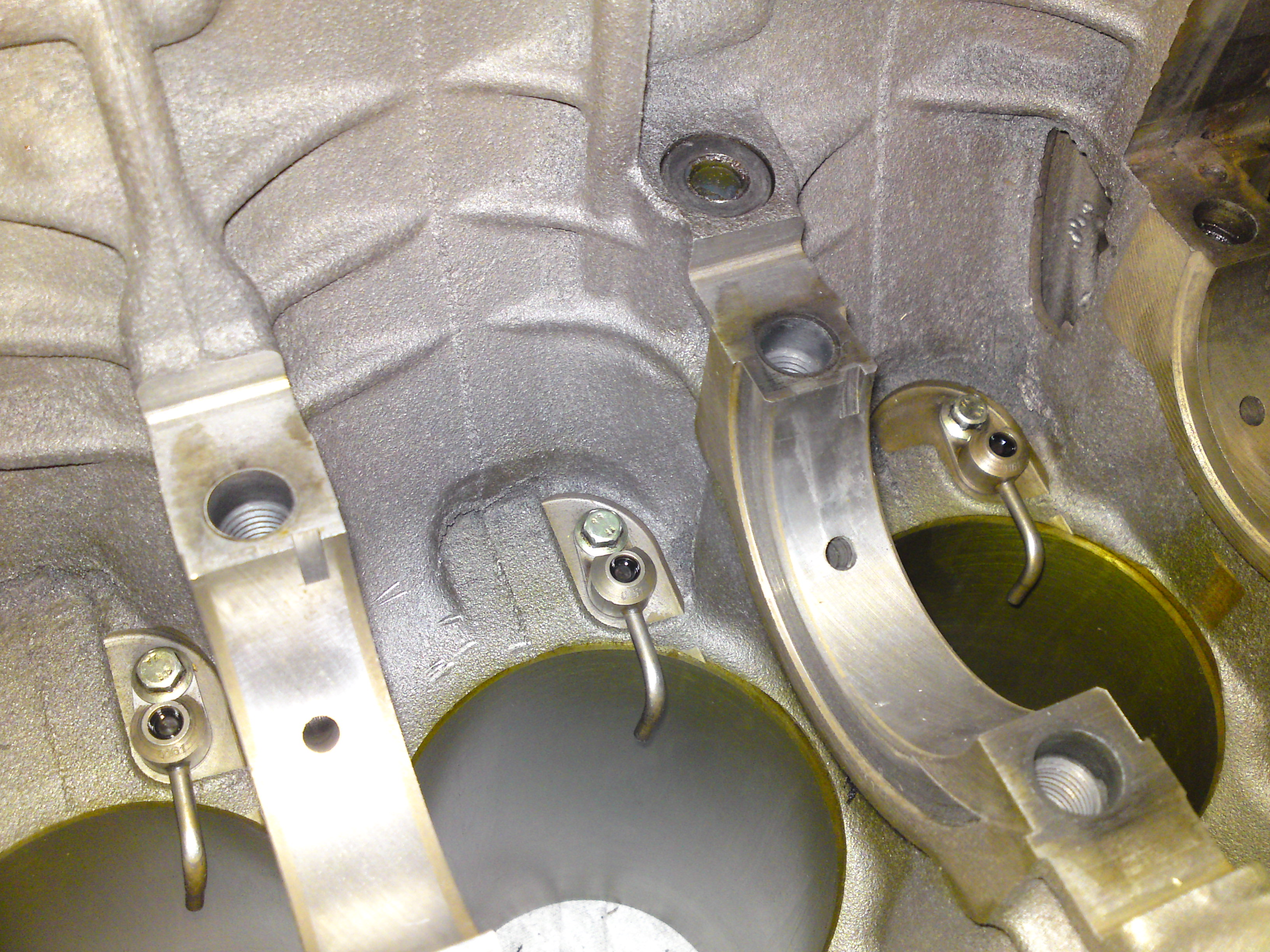

there should be cut outs that locate the shell into the rod and the big end cap. the holes in the shells are for oil to pass through---you will find tiny holes in the rod---this takes oil up through the rods to the little ends. so there fore when the shell is in place on the rod, you should be able to see the oil feed hole through the hole on the shell ( this hole that feeds the small ends via the rod).
The bearings have a small tab that locates them in their relevant positions, they almost feel like they clip into position when you get it right.
And yes they should have a small hole for oil for lubrication and this should line up with a small hole on whatever they sit on.
Theres also small holes in the crank and all the way up the rods to the small end bearing to keep them lubricated.
Ive added some pics so I hope you can see what im talking about.
Ok cheers guys. So how would putting them in with the tabs at the front and not the back affect them? Will the oil holes not line up or something?

(09-10-2012, 08:08 AM)Ricky Wrote: Ok cheers guys. So how would putting them in with the tabs at the front and not the back affect them? Will the oil holes not line up or something?
If you have to ask after looking at my pictures you shouldn't be building engines lol
If you put them in wrong then the oil ways wont line up but also the bit with the tab on wont be located and will either cut a nice gouge in your crank or pickup and spin or maybe both, either way itll f*ck your shiny new engine.
im not really sure how you could have put them in the wrong way...you would struggle to get the bearing cap on flush.....And for the referance, these dont have oil way up the rod to the little end....its just a drip fed lube on it from the bore squirter.
