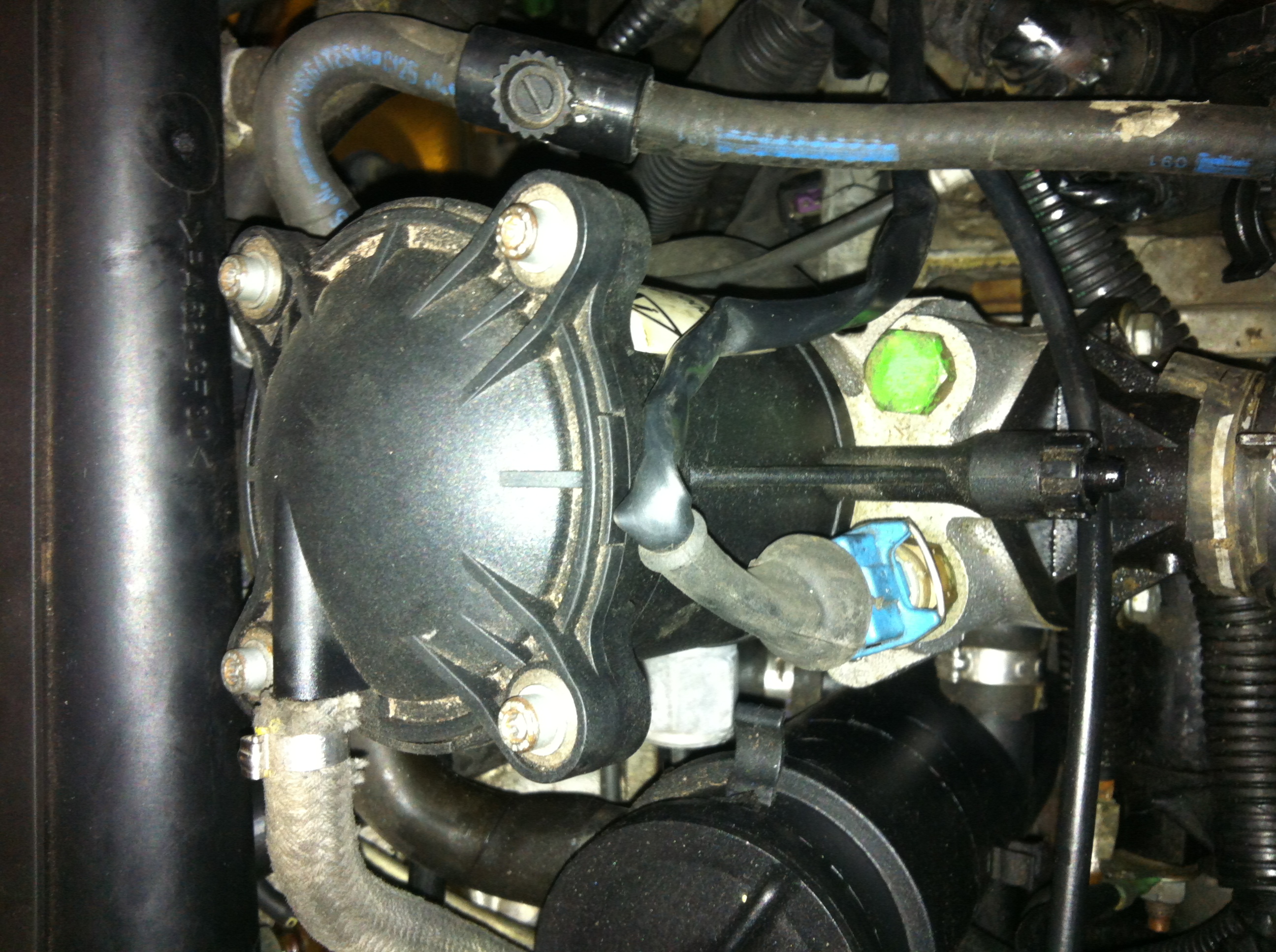

Our only issue is that the fans kick in as soon as we turn on the ignition, and fire up untill we kill the engine again. Obviously, the fans rarely kick in, so to hear them roaring away isnt correct.
Can anyone help as our knowledge of the wiring is vague. Is a 2nd switch needed on the thermostat housing? Or is this green nut anything to do with it, should there be a switch in its place?
Any help would be great

Not 100% sure as im not a diesel person Tongue but IIRC theres a brown plug for the fans around the stat. that makes them run constantly if its unplugged

yep, sounds like the brown plug is either unplugged, or missing

So am I right in saying in the position of that green nut?
Yep, did you use the loom off the old engine or the new one?
Just pull the sensor out the old engine and put it in that space Smile Though ill admit, I can't see the Brown plug nearby?
I had this; check the plug at the top of the rad which connects to the fans. Either you're missing a wire or somethings up with it. It's a blue plug.

Look in your old engine that came out... Is there a sensor where that green bung is? should be brown

Yeah, but its in a ph2 car, none of the wiring is there for the p1 gan setup, its all controlled by the bitron...
Have checked the old engine and it's all wired differently through the radiator switch, presumably as its a newer engine?
I'm still confused, for the engine wiring loom, did you use the original one that came with the ph2 t plate engine, or the one from the ph1 p plate engine?
The wiring might be different, but you only need to plug it all in, shouldn't be vastly different..
My car has a ph1 xantia engine in, although the wiring is different, the loom from my ph2 car fits on...
Theres basically 2 systems, one that uses a 3 pin plug in the radiator, the other uses the brown plug on the stat housing... They're not interchangeable between CARS... However they are interchangeable between engines if you catch my drift...
Sorry mate, I'm repeating all this via the chief mechanic (old man!) as I don't really know what I'm on about,
We're using the loom from the 'T' plate car, and from what we can see, it is slightly different in the way the fan is wired up. From what was first said, the brown plug should be the resolution to the problem.
What I was trying to say was the original, now scrapped engine from the 'T' plate car, had it wired through the radiator switch, thus, no brown plug.
