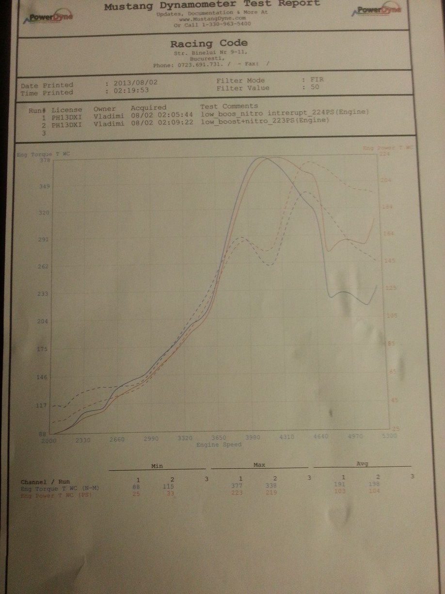

What website? This is the website of the company that ownes the dyno. http://www.racingcode.ro/
And your argument in saying that Darren's xud had more poser than ours is? Why all the dyno sheets posted so far are ok, but a mustang dyno 500 sheet from Romania isn't. If you're not convinced is your problem. I'm not trying to convince anyone. Don't forget, single turbo vs twin turbo supercharged.
With nos, without nos, with meth, without meth. It's still power. If nos is cheating, then w/m what is? Will see some figures at full boost. Bare in mind it was 1.1bar. So far it is the highest power measured on a xud.

(06-08-2013, 09:51 AM)SonnyRoby Wrote: So far it is the highest power measured on a xud.
And you know that how?
For a start though, that's comparing a few different engines, not many use the XUD11. And secondly there's a lot of XUD projects out there that people don't know about. Impressive result, but you come across a bit arrogant regarding it.
And given the size of the turbo i'd expect that from 1.1bar. It's f*cking huge. Bear in mind my GT2056 makes much more power at 22psi than a GT15 would at 30psi. Your pump's going to be the issue as the turbo can certainly provide enough air.

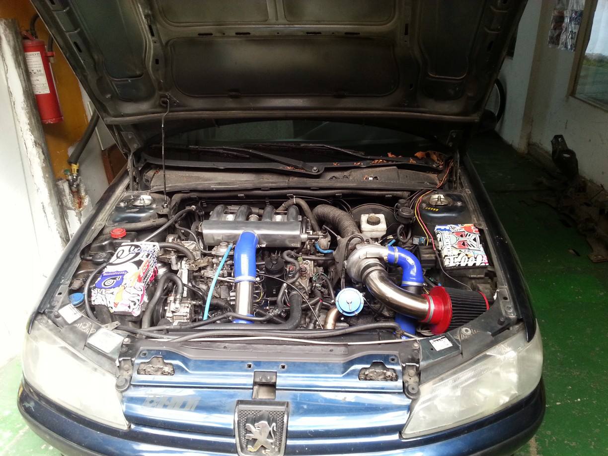

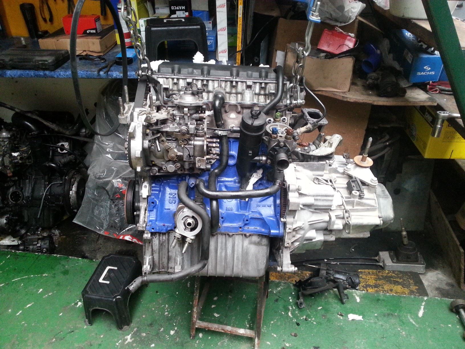

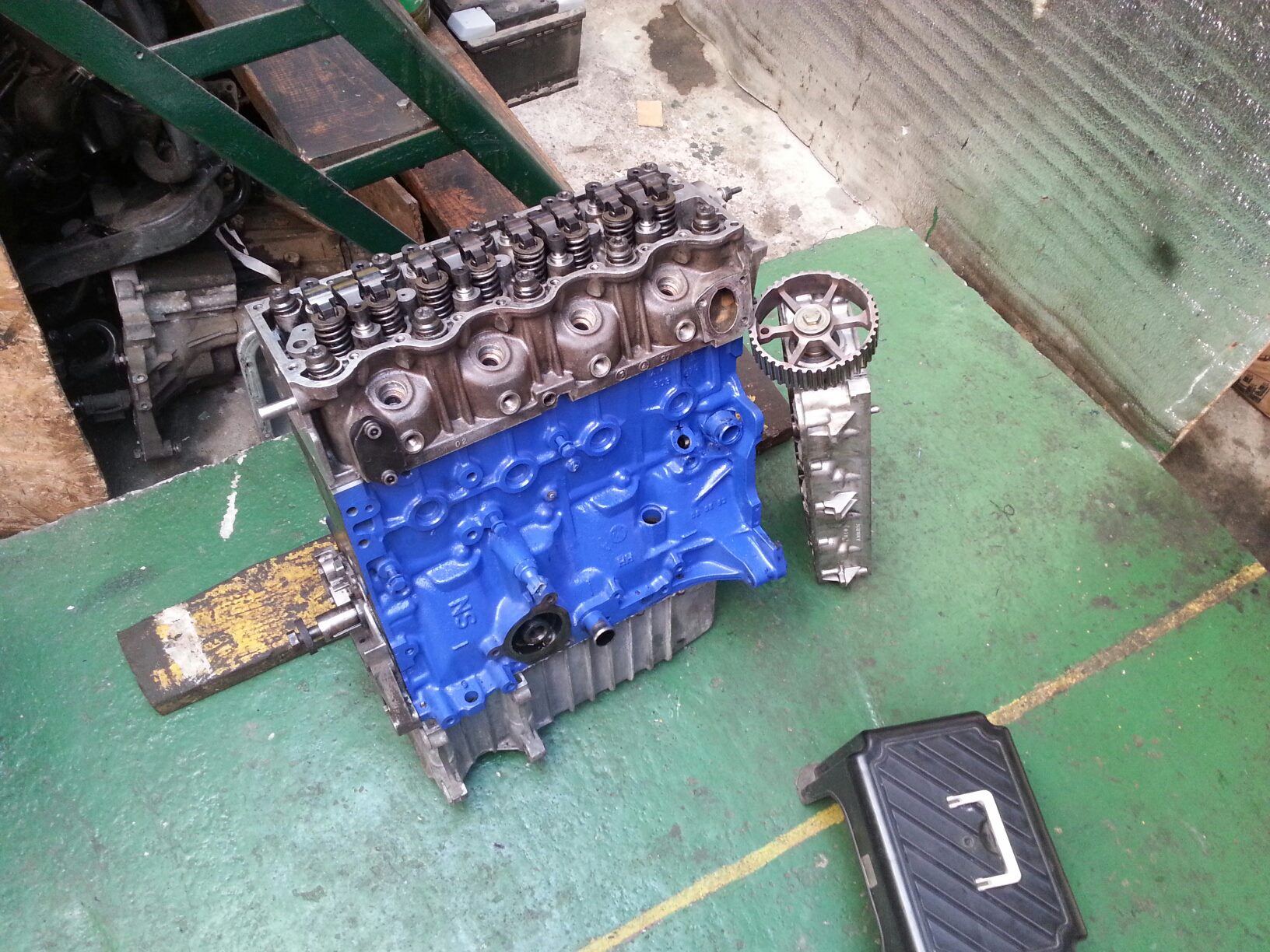

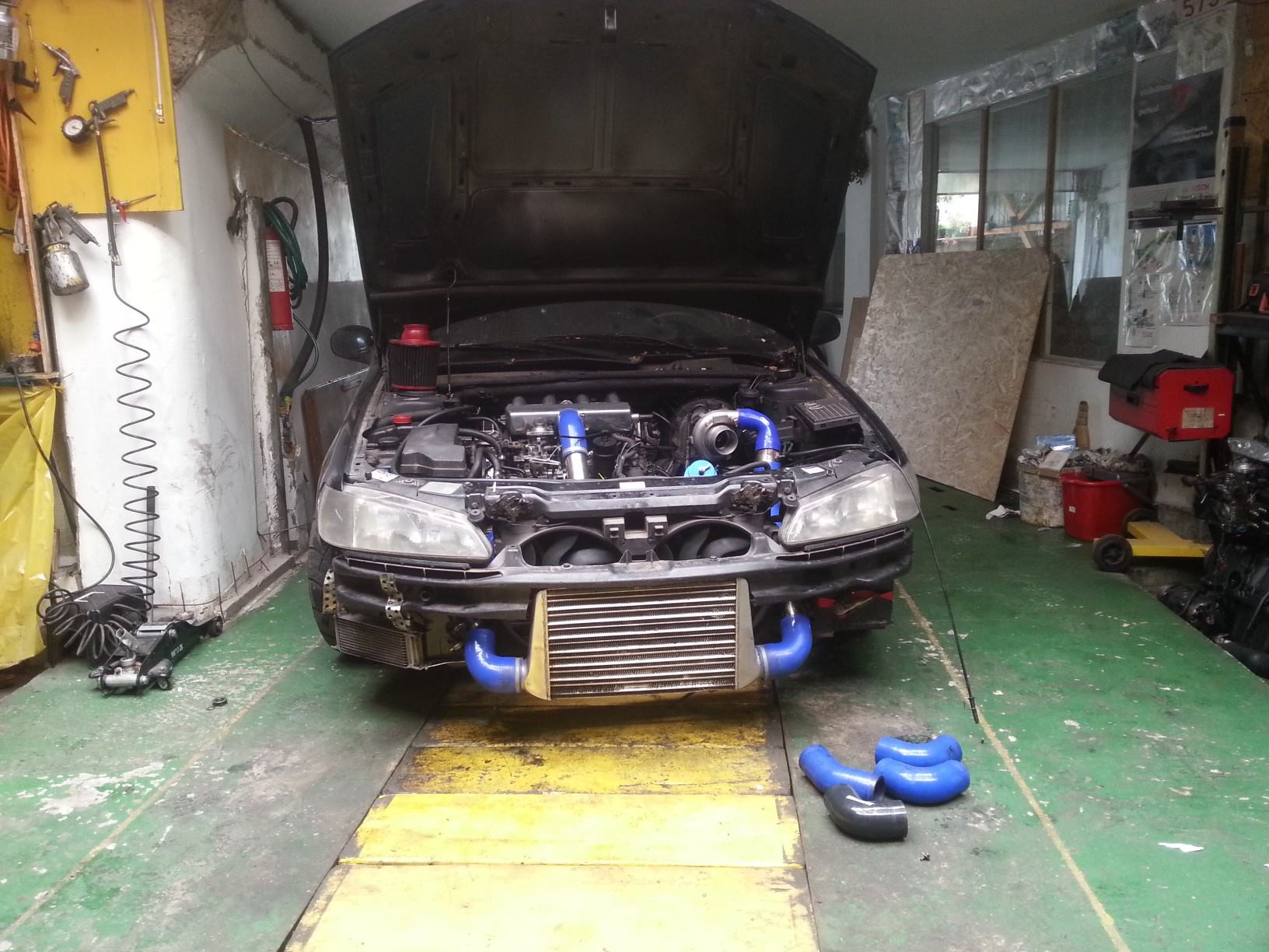

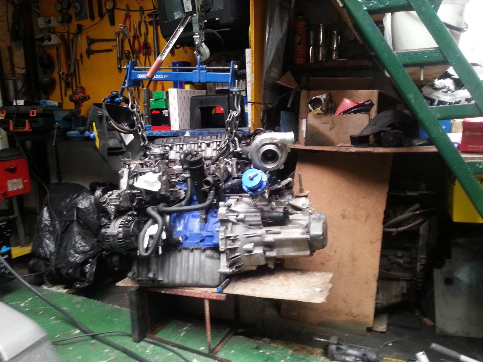

Here are some photos of the project.
#69
Nice result Sonny! I bet the NOS kit cost a bit mind!?

Yeah great result. get a project thread up to show all how you did it, would be a great read!

Pics Smile now we like pics looks a good build impressed!

That's a horrible power band though! Get that pump fuelling higher up the revs, it looks like it only starts making boost at like 3500rpm :o

(06-08-2013, 07:15 PM)cwspellowe Wrote: That's a horrible power band though! Get that pump fuelling higher up the revs, it looks like it only starts making boost at like 3500rpm :o
coz its a freaking huaaage turbo
I bet he is only using nos top end going by the smoke...needs to use that nos to burn that fuel and get that turbo spooling!

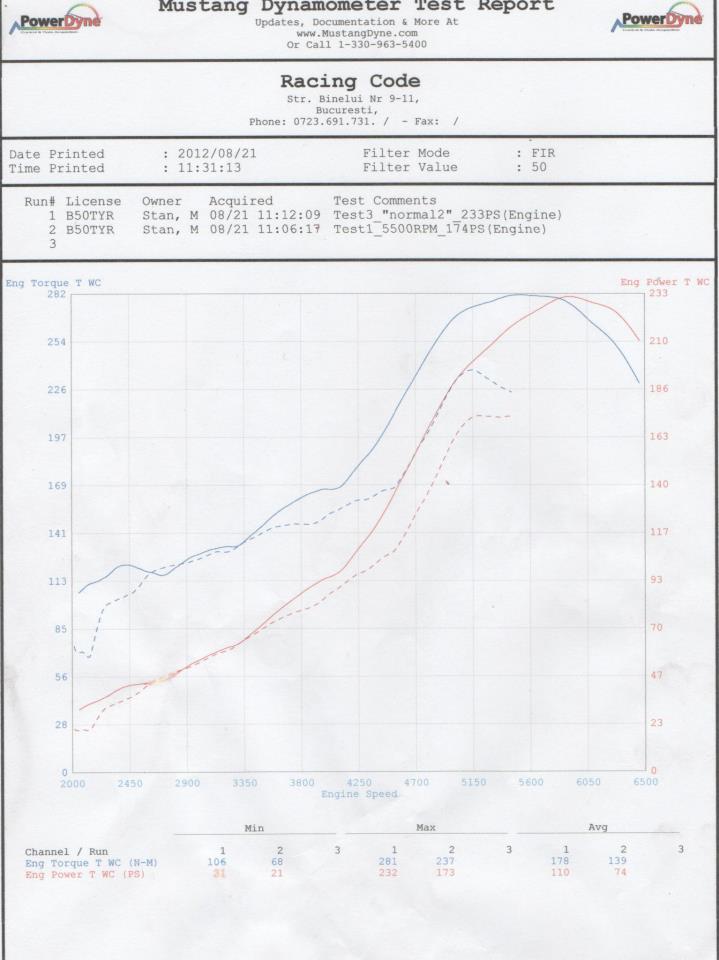

Hello ,
Here is an XUD single turbo , 2 bar boost ,12mm head , big turbo . the broken line at 174cp is with 1 bar , low rpm .
The power is not on paper .. is on the road , rolling start victims 60-220 km/h megane rs 280 bhp , gti 300 bhp , impreza 350 bhp , old civic with k20 some 800kg and 230 bhp and so on , and 2 broken gearboxes (from slicks)

oH. The same american dyno; from Romania! ^ this the BX.

Am I right in sayin these romanians are slightly out by a few 'BHP' as their dynos are in 'ps' and our dyno prints read hp? Lol

good results...adding up nicely
(07-08-2013, 05:52 AM)CJ_Derv Wrote: Am I right in sayin these romanians are slightly out by a few 'BHP' as their dynos are in 'ps' and our dyno prints read hp? Lol
yeah but only slightly...233ps is 230bhp
Don't be hattin'
The BX had XUD11 with a t3-t4 bigger AR than the 406 as you can see - full boost at 5500rpms. And no cheating.
