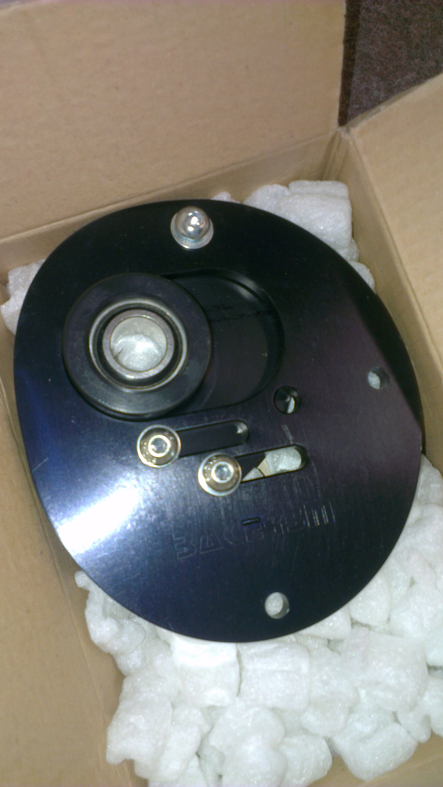

So are they just camber adjustable, or caster as well? Looks like you can only adjust horizontally, not vertically as well?
[Image: 20120704_212316.jpg]
#55
Fixed caster adjustable camber Smile

Ed do these already have some castor set on them? From looking at the pic, they look like the bearing is set quite a bit further back.
