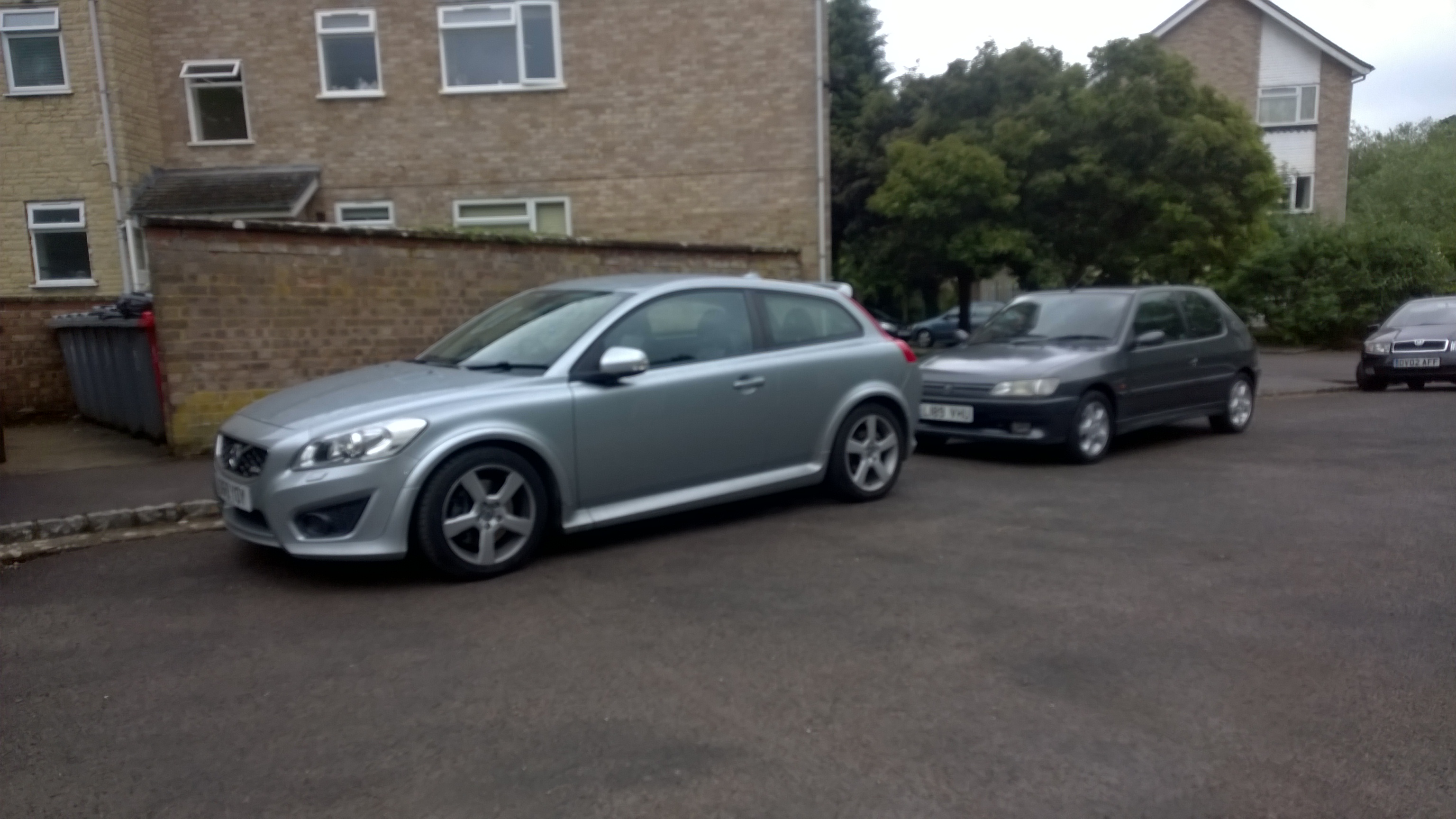

Anton got to say your two motors look the part there! the Volvo really goes well with the 306! I have toyed with the idea of getting a Volvo C30 as my next car, if I do get the chance to move on in life, I would buy a 3rd car lol,
#57
FIVE litres of brake fluid!?!?
You'll be there for hours!
#58
(29-06-2015, 09:33 PM)RetroPug Wrote: Awesome car mate.
Cheers mate, got to keep the phase ones going!
(29-06-2015, 09:34 PM)procta Wrote: Anton got to say your two motors look the part there! the Volvo really goes well with the 306! I have toyed with the idea of getting a Volvo C30 as my next car, if I do get the chance to move on in life, I would buy a 3rd car lol,
Thanks mate, so different but both great cars. The Volvo is just the perfect cruiser, love it.
(30-06-2015, 06:53 AM)Piggy Wrote: FIVE litres of brake fluid!?!?
Haha 5 litres of Pagid was £11 something, so there was no point messing about with smaller bottles.
