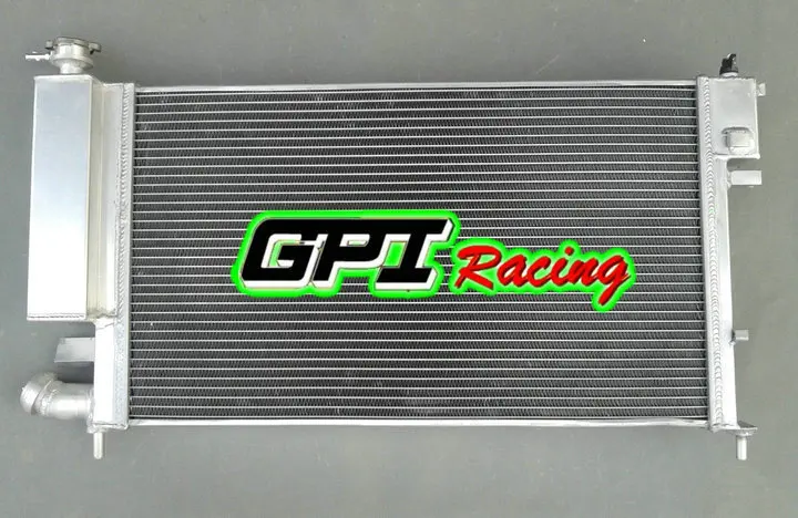

(05-10-2016, 07:19 PM)miles Wrote: The S16 has the 2 extra take off's as above, the 8v XSI is the same and maybe some other models, Nissens thou should do one to suit
That connection does anything else ? The Nissens you mean like this one: ? Like the stock radiator for peugeot but the nissens one right ?
[Image: thumb?id=1989438&lng=pt]
If i buy this one, and remove that hoses or blocking them will that be ok ? Just beacause this is a GTI6 radiator and doesn't have that.
[Image: ALUMINUM-ALLOY-font-b-RADIATOR-b-font-FO...ITROEN.jpg]
