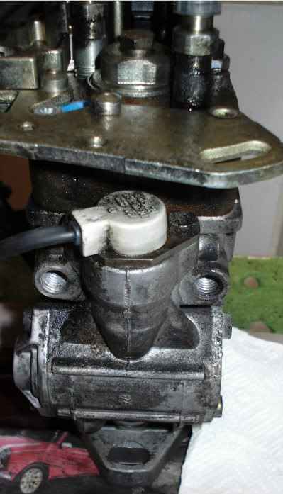

As shown above - as long as it doesn't have:
[Image: attachment.php?aid=26933]
It's a non-ECU pump.
The microswitch you're referring to is the EGR switch, this is what would cause the EGR to turn on/off depending on where the throttle is, the fact it has this instantly tells me the pump likely isn't an ECU pump.
