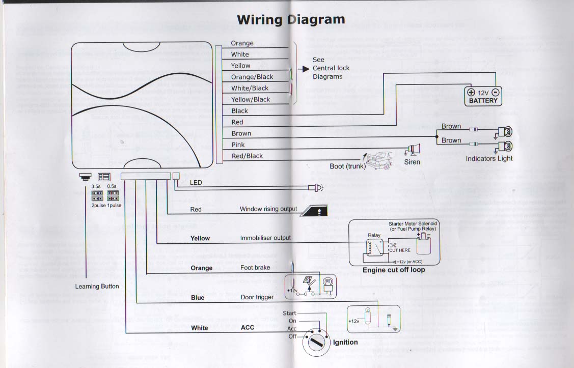

so now i know the car is a negative trigger ive got to start piecing different drawings from the book together
first is the main wiring drawing for the unit

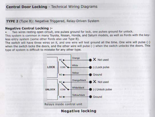

second is the central lock part of the main drawing this has to be wired as per the drawing
i will add wire numbers later and a propper easy to follow drawing
