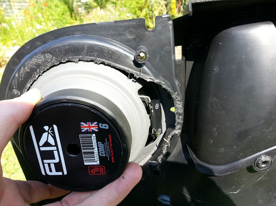

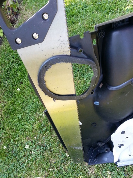

I followed this guide pretty much to the letter, http://www.theywhoshallnotbenamed/index....oorinstall , even bought the same speakers as it turned out being on a budget and all.
I found the easiest way to trim the plastic to fit them in was with a 20" panel saw, the speaker mount has 3 'levels' moulded into it, a bit like a plastic garden pond liner? And to fit my speakers I needed to chop off the smaller of the 2 levels just leaving the larger outer ring there. The saw goes through the plastic like a hot knife, and the square steps of the 'levels' keep the blade square and cutting where it needs to cut.
Already cut the first level off in the first pic, and you can see how it ends up in the last.
Bit ghetto, but it keeps the stock covers fitting with no loss of strength to the door card.
