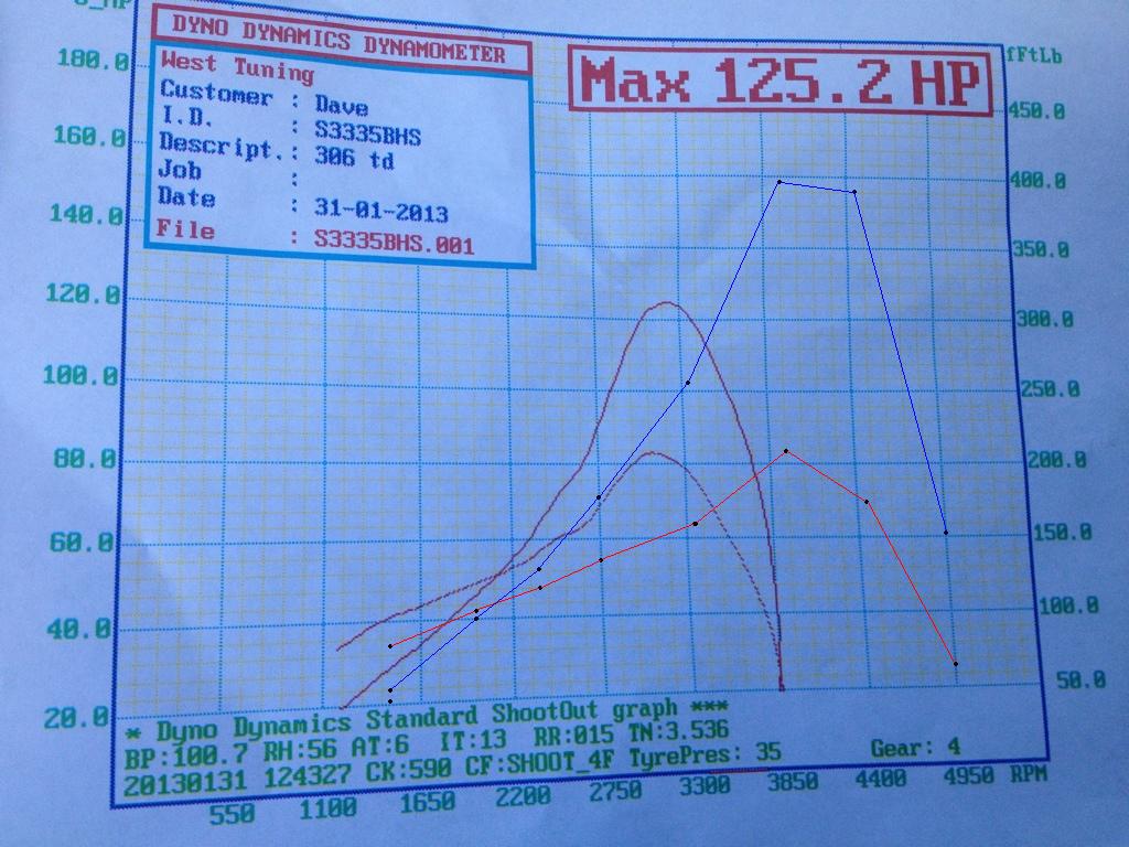

Dude this is only if my GUESS is right and it is all subject to human error and could be as much as 10% over or under (or actually wildly incorrect) and my plotting of the BHP line is pretty poor.
Realised my initial maths was a little wrong I had been adding 2 boxes for every 5 but actually it was 2 for every 7 but were there now.
1480 rpm = 85 lb/ft calculates to 24 bhp
1980 rpm = 105 lb/ft calculates to 40 bhp
2360 rpm = 120 lb/ft calculates to 54 bhp
2750 rpm = 136 lb/ft calculates to 71 bhp
3350 rpm = 160 lb/ft calculates to 102 bhp
3960 rpm = 210 lb/ft calculates to 158 bhp
4450 rpm = 185 lb/ft calculates to 157 bhp
4950 rpm = 65 lb/ft calculates to 61 bhp
Torque in red, horse power in blue
