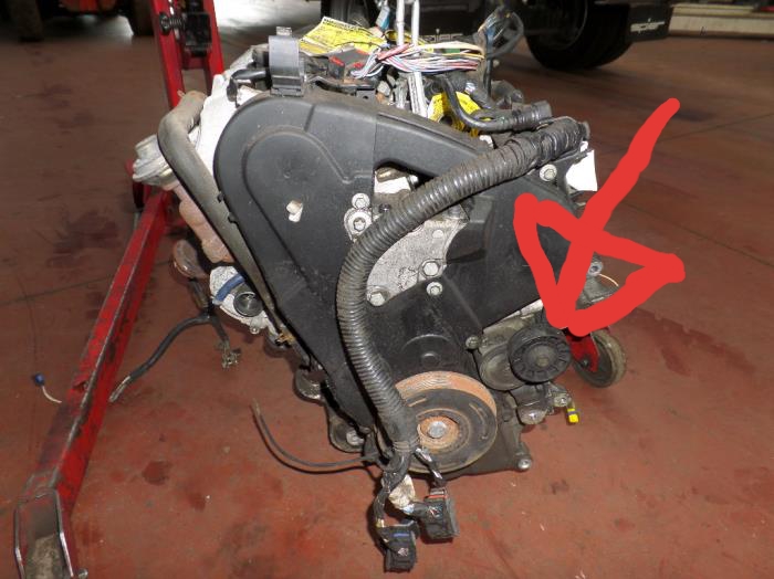

It should have a spring loaded tensioner which you use a double spanner trick from the wheel arch to move it.
I think the bolt on the black idler is a 16mm.
oooooooooh, yep. Well I'm a fool, I was fiddling around with the other tensioner, I knew something felt off from when I did it last time.
Thanks very much, I'll just put the other tensioner back as it was then, doh. I think you've solved my problem right there Smile

Yeah got it sorted this morning. The problem was that there are 2 tensioners, the upper one (known as 'pully' in most diagrams i've seen) which you can use its 15mm bolt to release tension, then put allen key in hole to lock. The lower tensioner has the hole for a square drive to release tension, doesnt seem to have any way to keep it locked, bolts on using a single allen head bolt.
I forgot about the upper one and started faffing with the lower one, which i should have left well alone. So I put the lower tensioner back in place, then released the tension on the upper one, locked it with an allen key, slipped new belt on (tight fit mind!) then released tension and everything was good again.
So yeah, it was basically my own error of mistaking the lower tensioner as the one I needed to fiddle with. Once Uberderv posted that pic and I saw the tensioner, I immediatly remembered how I was supposed to do it.
