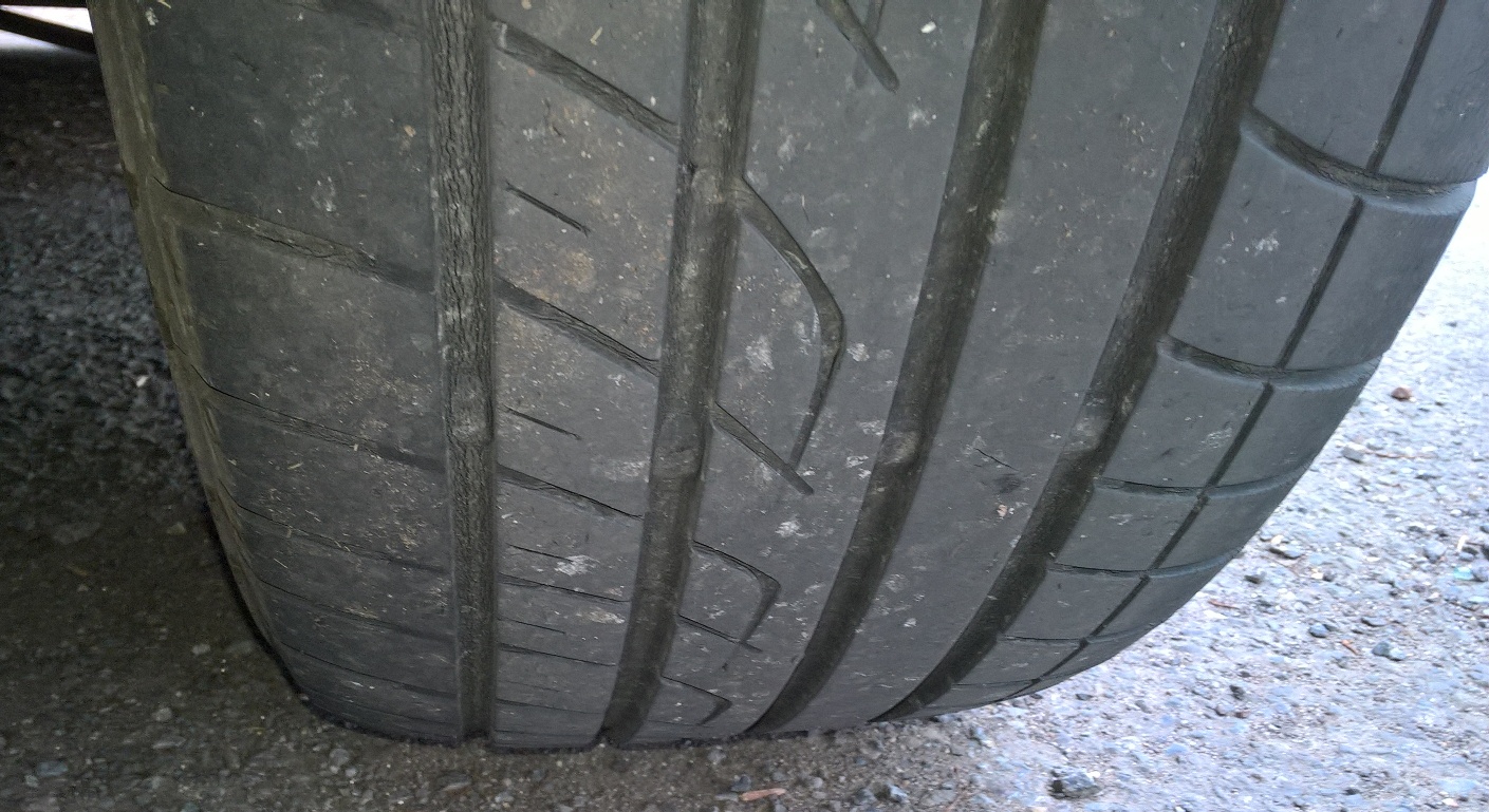

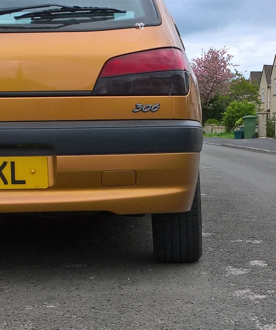

Had a quick look underneath & see tyres (particularly D/S) are scrubbing on inside edges & when I looked more closely I started to convince myself I could see some camber that shouldn't be there!  When they go do they really go that quickly?  Am convinced I would have noticed uneven tyre wear when I had the car up on stands to do the mounts.

looks like you have serious camber there, at a guess id say a dead tube for it to lean in that far. Very common now in 306's much like the 205 tubes. As bash said im in lyme regis dorset should you want some one to look at it.

(14-04-2017, 06:19 PM)Stef205 Wrote: looks like you have serious camber there, at a guess id say a dead tube for it to lean in that far. Very common now in 306's much like the 205 tubes. As bash said im in lyme regis dorset should you want some one to look at it.
'..serious camber'.  Damn, how did I not notice that before?!  My own stupid fault as should have attended to bearings as soon as I got the car.  (Prob same with other too). Think I convinced myself only mounts needed attention straight away. Have now taken it off the road & swapped to XSi number 2 .....but that's not without its problems either! Dodgy

Camber doesn't look that bad to me Wink
On my old 405 I had started to wonder why the damn thing was starting to 'wander' or tramline and feel generally unstable.
Anyway I had a look round the car and noticed a lot of camber on the rear wheels along with no tread left on inner edges of rear tyres.

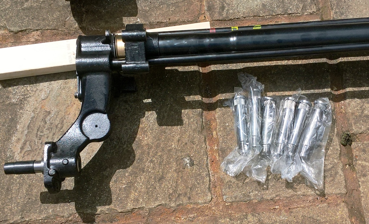

Update on this. Beam came off the car last weekend, after getting back from holiday. With three 306's in the stable (2 running) I decided having a spare beam ready to go when needed would be a good idea. It gives me time to try to re-build the tired beam at my own pace, including making up the tools I'm going to need. If I royally 'F' it up (a definite possibility) I'll be sending it to one of the experts on here!
Debated getting extra beam from a scrappy but decided it would more than likely have just as many problems as the existing one. Instead I ordered a 'new aftermarket' axle from CP4L, which didn't need old beam in exchange. With the bank hol discount last weekend it cost £311 delivered. Looks OK and has correct size TB's (20mm). It also came with 4 sets of stub axle pins! 1 set was fitted and 3 further sets were taped on to the beam. Each set is a slightly different length, presumably allowing you to fit the beam with disc or drum hubs in their various forms?
I don't have any illusions about this new beam. There's no guarantee quality bearings etc have been used. I just need it to give me some breathing space to get the other beams sorted and it can then be pulled apart, checked, and fitted with a known set of decent bearings in a year or two.

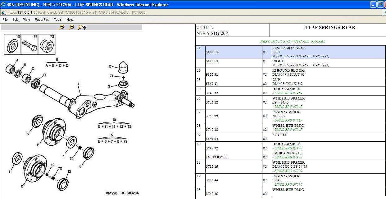

Not sure why the new beam has this machined area on the end of the swing arm as there isn't anything on the old swing arm.  Apart from that they look identical.
There have been a couple of un-anticipated problems with going down this route though. No doubt some of you will roll your eyes at me being so naive but I'm still learning .....

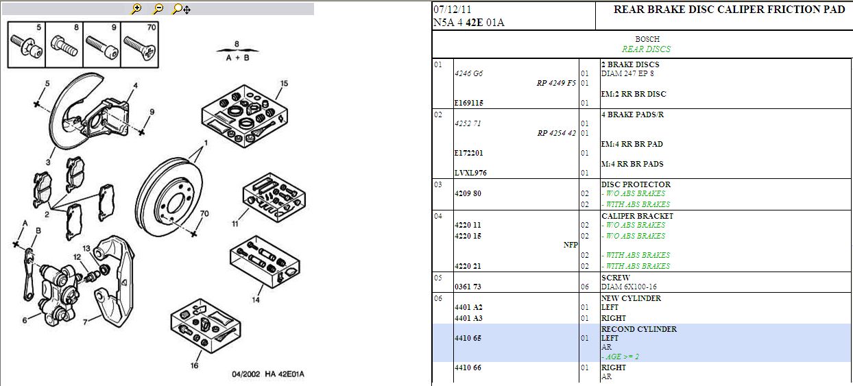

1) The new beam didn't come with caliper brackets, labelled 4 in the attached diagram. (I don't want to take the one off the old beam as it will mean taking the hub of and possibly wrecking the bearings, which still feel like they're in good nick). I thought I'd have to go hunting at a scrappy for these but it turns out Peugeot only charge £12 + VAT for each bracket. Happy days!! I do have to wait a week for them though as they have to come from France.
2) I already had a pair of aftermarket rear hub/bearings. Problem is they don't come supplied with the spacer you need to put behind them. Peugeot don't sell these separately either. At worst I will have to get a pair of hub/bearing kits from Peugeot, which include the spacers. For anyone thinking about getting some, the older style are apparently still available in original spec (part 5 in the diagram) whereas the newer style aren't. Peugeot are only wanting about £34 + VAT ea for the older style ones which isn't bad.
3) I bet the ABS sensors aren't going to come out of the old beam. One died on the front last year and I had to drill/chisel it out as corrosion in the hub had exerted a vice-like grip on it. I'd forgotten I'd want to swap them over - doh.
Have a couple of questions resulting from this relatively long ramble .....a) does anyone know where I can source some of the hub spacers (other than a scrappy)? The internet hasn't yielded anything. b) Any recommendations for a good value source of ABS sesors? Ebay has plenty which are either ridiculously cheap and can't possibly be any good or else known brands (Intermotor etc) seem to be £30 upwards. Then found these http://www.autosensors.co.uk/en/519-abs-sensor-454533-454536-454546.html but have the 'buy cheap buy twice' mantra ringing in my head!

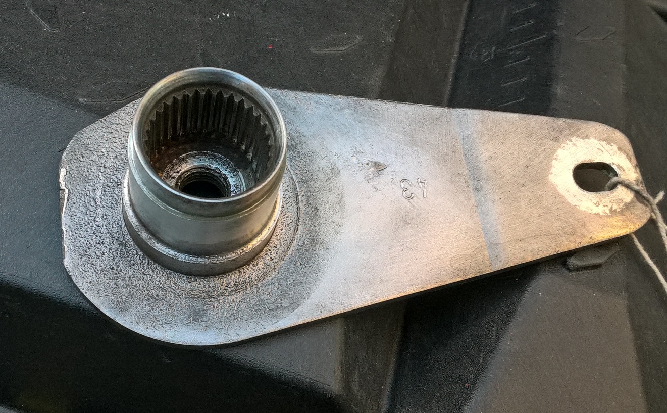

So had a bit of time to start dismantling the old beam today.  Started with winding out end plates on ARB ...well one of them at least.  Had to put breaker bar on it in the end n was convinced would strip the threads but was OK in the end.
Was glad of the impact driver to get the end screws out of the torsion bars.
The offset washer came out pretty easily on the n/s arm.  O/s was a different matter.  Walloped the carp out of it with a punch.  The end broke off the punch but the washer did give in eventually.  It's definitely not re-useable!

you only ever need to remove the right hand arb end plate.
new beam looks like a drum abs type.
Peugeot do the spacers, parts numbers in your post.

Thanks Welshpug.  The machining for drum ABS makes sense.  It looks like the correct holes are also drilled & tapped for the caliper bracket so hopefully it'll be fine Huh .  (It was sold as disc compatible).  If not ...well, disappointed would be an understatement.
I guessed it wasn't entirely necessary to remove both ARB plates.  I wanted to get them cleaned up in an electrolysis tank but may just treat one with the ARB still attached!

see this many of times from internet axles, they hate waste so they will machine arms to "fit" all applications. But as said it is for a drum abs and looks like xsara arms aswell.
Their thinking is one axle fits all hense your array of stub axles.

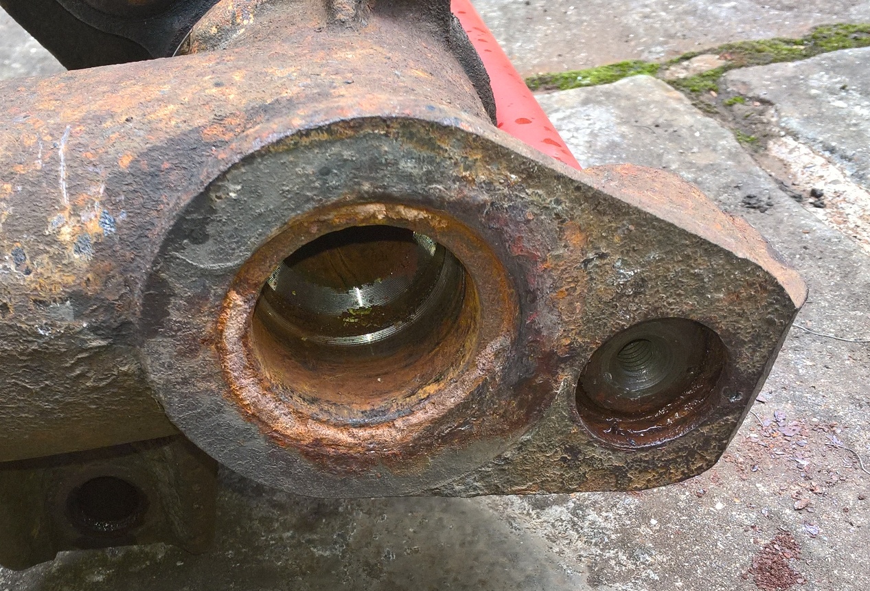

So, finally found some time to work on the old beam again and here's the state of play so far.
As predicted, the BFH got the right hand torsion bar moving at the end farthest from the swing arm.  Got quite a bit of heat on the end nearest the swing arm and cranked up the puller on it.  It freed itself, but without the spectacular 'crack' I was expecting.
Thought the LH torsion bar would need the same treatment but using the puller it wound out with hardly any effort. The splines were really well greased which made me think it had been out before.  The bearings on the left look pretty good too (original Nadella ones) but the shaft has notches on it where the outer bearings sat. It's only on about a quarter of the circumference of the shaft though and the rest seems perfect.  Makes me wonder whether it can be pressed out, rotated 180 degrees and reused for a little while longer?
I don't have high hopes for the state of everything on the RHS as the shaft is currently jammed solid inside the tube.  I assume some of the bearings have come adrift and have wedged themselves in there.  I guess I just have to hammer the living daylights out of the swing arm until it works itself free?

Right hand swing arm finally off.  The word for the shaft (and possibly the tube), I think, starts in 'f' & ends in 'd'.  There wasn't really anything recognisable of the outer bearings, apart from a bit of the shell.  I'll get the tube cleaned up anyway.  I assume you then have to measure the internal diameter where the outer bearing sits to ensure the bearing will still have an interference fit all round?
Good news is the new beam has gone on.  The caliper brackets fitted it fine as did everything else.  I managed to find some of the spacers to fit the hubs, from Spanish eBay! Just a few more bits to fix back and then it can go for it's MoT.
If I need to get a replacement tube for the other beam is there anyone on here who supplies them?
Cheers
i can supply recon tubes, about £150 fitted with new bearings, seals and outer cups.

Many thanks Stef.  Probably a really stupid question but would you say the existing tube is most likely damaged beyond reuse?  I'll have to give it a month or two to get my finances back in order before thinking about a replacement.
yup wouldnt even question it. good second hand tube or a recon tube.

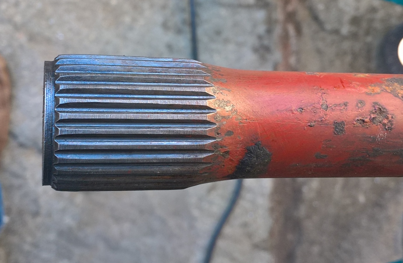

Various parts went in an electrolysis tank to be cleaned up.  (Thanks to one of Piggy's Youtube vids a while back for getting me started with electrolysis for rust removal.  Lots of other info on the web too).  The swing arms looked like this after a night in the tank.
10 mins with a wire wheel on a drill and these are the results.
The rusty splines on the torsion bars and the ARB end plates got the same treatment.

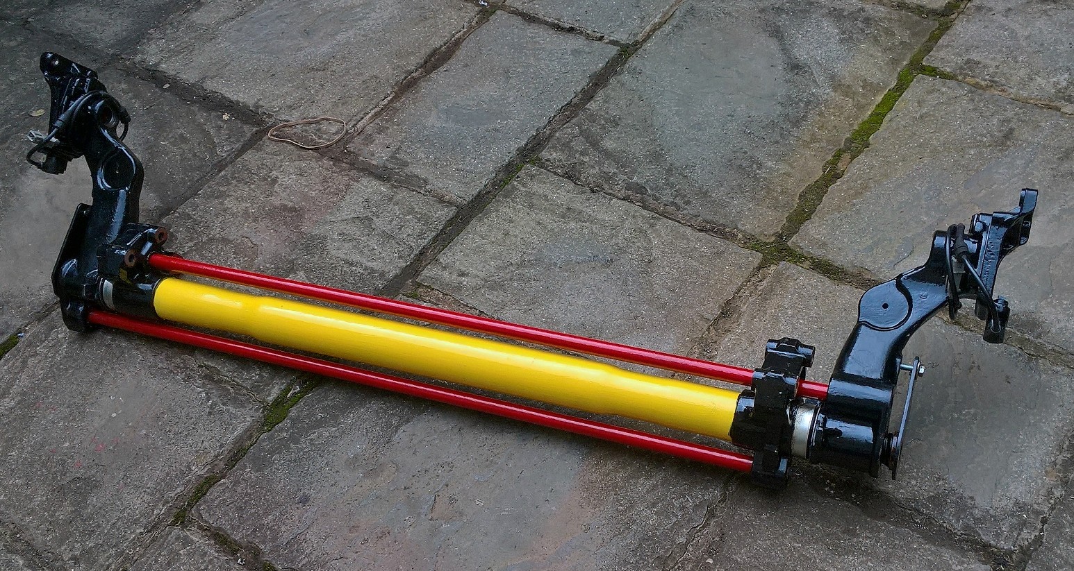

Nearing the end with the beam rebuild now.  I got an aftermarket tube from Stef a couple of months ago.  It seems like a really solid piece of engineering and comes fitted with quality bearings and also comes with the other bits you need (cups & seals).  Stef also supplied me with some offset washers as Peugeot don't stock them anymore.  He's had some made up.
I finally got the swing arms to the local garage and had the new shafts fitted.  Then the brake caliper brackets got a clean-up and were refitted.
After several coats of paint in the standard colours I've put everything together temporarily.  All of the parts that normally corrode have had a healthy dose of anti-corrosion wax (Dynax S50) in the hope it won't rust itself together.  The torsion bars will have to come out again to set the height on the red car and I'll get the ARB end plates properly back on once I've done that. Smile
For anyone who questions the price of getting the likes of Stef to rebuild a beam to a high standard, don't.  There really is a lot of work involved.  I probably would do another one if needed but I'm very glad I didn't need it in a hurry!
