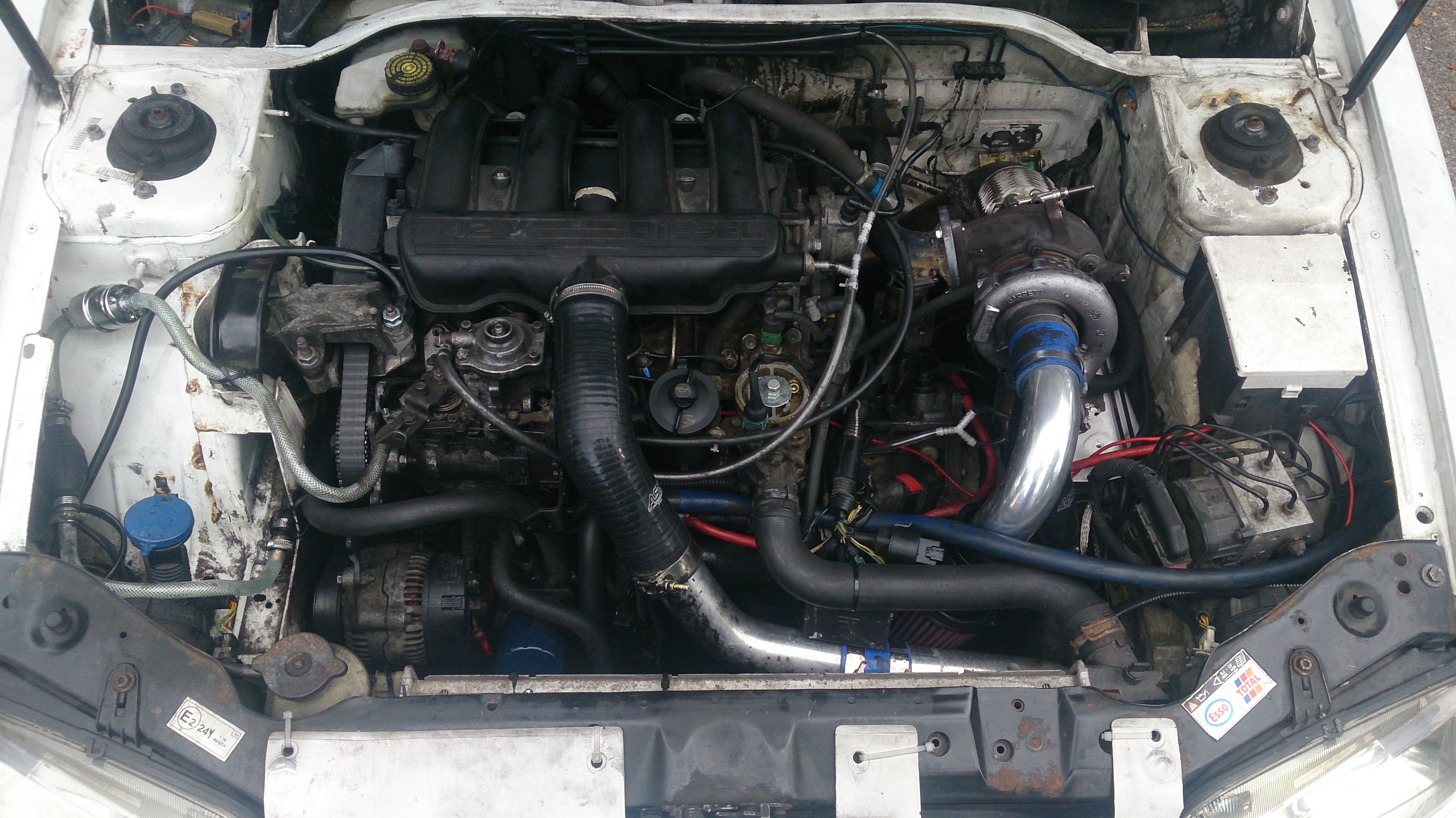

Evening guys boring Saturday night as spent 75% of cash on parts again but were there....inlet is all back on everything is together and double checked and tomorrow is the day my mate comes and does the welding so I got a cooler kit coming of A mate as I ordered one of a friendd and it won't be sent for while so got something to get her moving
so got the turbo clocked with a new bracket made for the actuator and got all that set and went and had a braided feed made.
Then cleaned and pained the inlet Mani and got all that bolted up glued the rpm sensor in the block.
then trimmed  the loom cut out some bits that wasn't needed and painted the slam panel and finished off the last bits of plumbing.
so tomorrow I got my mate coming to weld as above and two more friends seriously into their xuds and all hands on deck to get it driving as well as running aha tall order? We shall see. Will keep u posted.

Right guys small updates on this little project had my mate come and make my manifolds Sunday.
l went well obv a pain doing it out the car as the first time it Fowled like a Jew so took the motor back out and done it again and we'll its I'm may have to knock the bulk head about a touch to for driving as the engine rocks.
But everything went smooth and although it was dark due to having a major light wiring faik we connected the essentials and tried for a run or at least a fire.
No inlet Mani to bleed the injector and the down pipe is yet to be finished and........it took a bit if starting due to my originally battery not physically being man enough to swing the motor over fast enough lol.
But with the bipper van and some jump leads....still not quite enough power due to the killing the battery so out came the fendt 724 and some longer leeds we use for the forager and bang couple turns....she's alive until it coughed out so much smoke it filled the room in minutes due to being layed up for about 2 years out side it fired pretty easy couple turns had fuel going to the injectors and was soon trying to go. So if anyone can reccomend a good battery size for it be much obliged if not I got the old combine battery that will go in lol (did some one say agri spec?)
So with work picking up and not having no lights in the work shop anymore only a couple hours Herr and there is what's going on but shafts are in every thing on that front is all done pluming etc so slam panel is on so rad to go in and repaire till I pick up my new one and a small cooler kit I dragged out of a swamp is being fitted and I can go for a small drive.

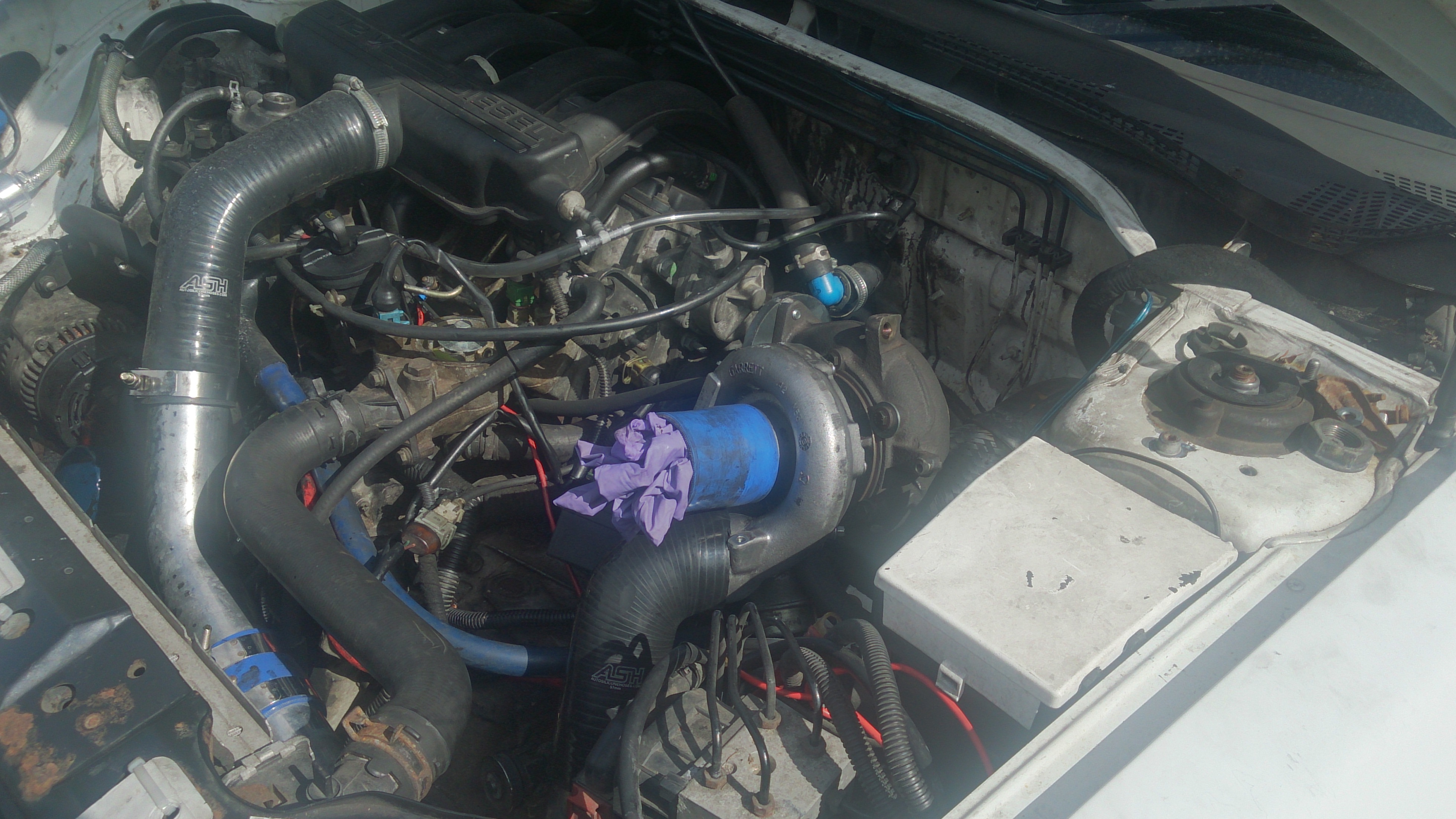

Right guys been a moment since I got near the car as I've had some ones else's to work on, but although I've had it running due to the snoke just pouring out and running like. Nails obv the pump and can was a tooth out.....epic fail.
so I lent out my locking tools to lock the crank in tdc with out dropping the starter so I used an Allen key that was big enough and when I put the belt on the cam and pump were a tooth out ah well no big deal so I pulled the motor as there was a lot of things I was unhappy with due to the overal tidyness of the bay. So out retimed it cut a few things about wheyyy happy days she's in running 100% like a dream and doesn't fowl anywhere at all now.
So that's the cooler on also only a small one untill the twinpass turns up in a few weeks. But today it was so far and after slapping the engine rad slam panel and all that shit in the front bumper and that can wait till tomorrow then can go for a drive.
So I had to clock the turbo again to get the boost pipes in and now the actuator needs a bit of adjusting as its somewhat on the piss no biggy. That's tomorrows job. .
When the motor was out I seen my time to order some original turbo gaskets also to stop any little keajs as we all know a blowing exhaust sounds hurre Dou's ? so that's sorted.
I also started on the inside of the car  all my old set up out wiring things in tidy now and I gotta do the relocation of the battery. So I bought some jump leads of eBay for 15 notes and there nice thick cable and 3m of it So that's what I'm gonna use call it a lash or what ever but if it'd tidy and it works who honestly cares? I don't.
