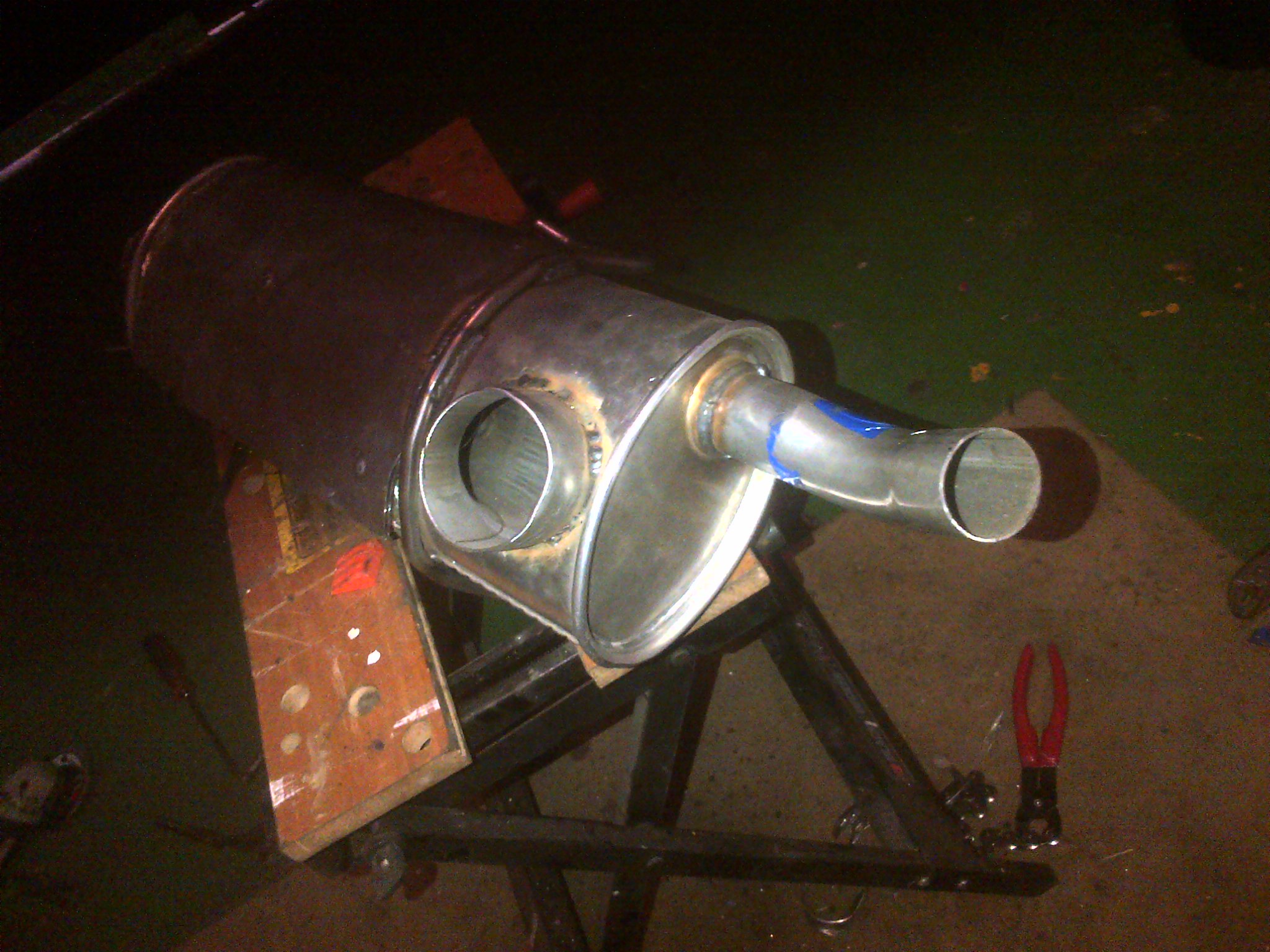

Here's a picture of that sneaky back box too. Started with a brand new 205d rear box, slit it open, gutted it and then rammed a bloody great 3" pipe and swept bend through it. Some of the original perforated tube was fitted into the walls of the 3" pipe and all the wadding was refitted, so it has room for expanding into the box and quietening it down a little, but in reality - she's straight through.
