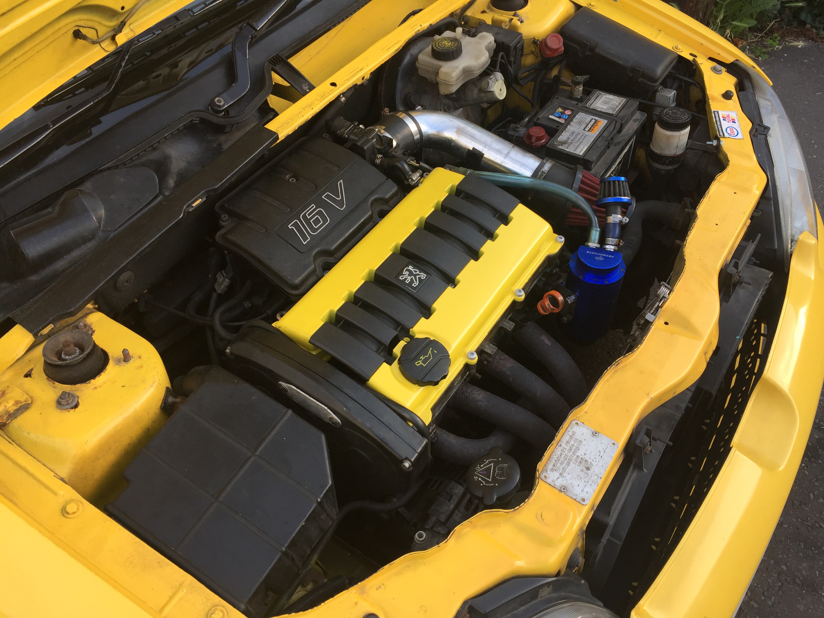

I'm no perv expert, but that KnN looks awful small and with no cold air flow to it Undecided
It is a small filter but doesn't perform to bad it doesn't actually get hot. I'm going to invest in a BMC enclosed unit that way it gets a good air feed and looks awesome Tongue
BMC is an overated rip off mate, you dont get enough heatsoak at the front of a 106 engine bay for it to be a problem. spend the money elsewhere and run a cold air feed from the foglight Smile
Also the filter you have is plenty big enough for a 1600cc N/A engine

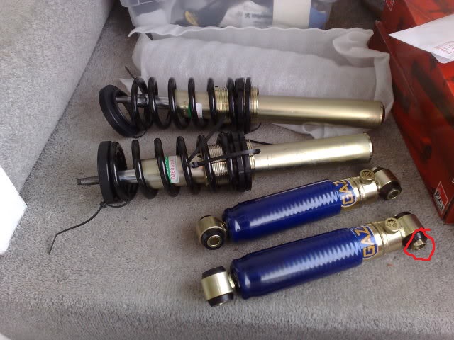

My adjustable GAZ shocks arrived today! Big Grin so got them fitted to the rear beam. Hoping they give me some decent adjustment and control over the rear end. Tomorrow I'm going to try get hold of a blow torch to burn the rubber beam mounts out and put my solid beam mounts in Smile

(14-07-2015, 02:54 PM)Stef205 Wrote: Errr don't mean to put a downer on things but there 205/306 items not Saxo/106! Sad
Really? They look exactly the same as the 106 units
No 106 units have a spacer on the bottom to space it way from the arm you can see the angle the shock is sat at due to the missing spacer
90' 205 gti6 supercharged
05' Evo 9 IX GT
Team eaton.

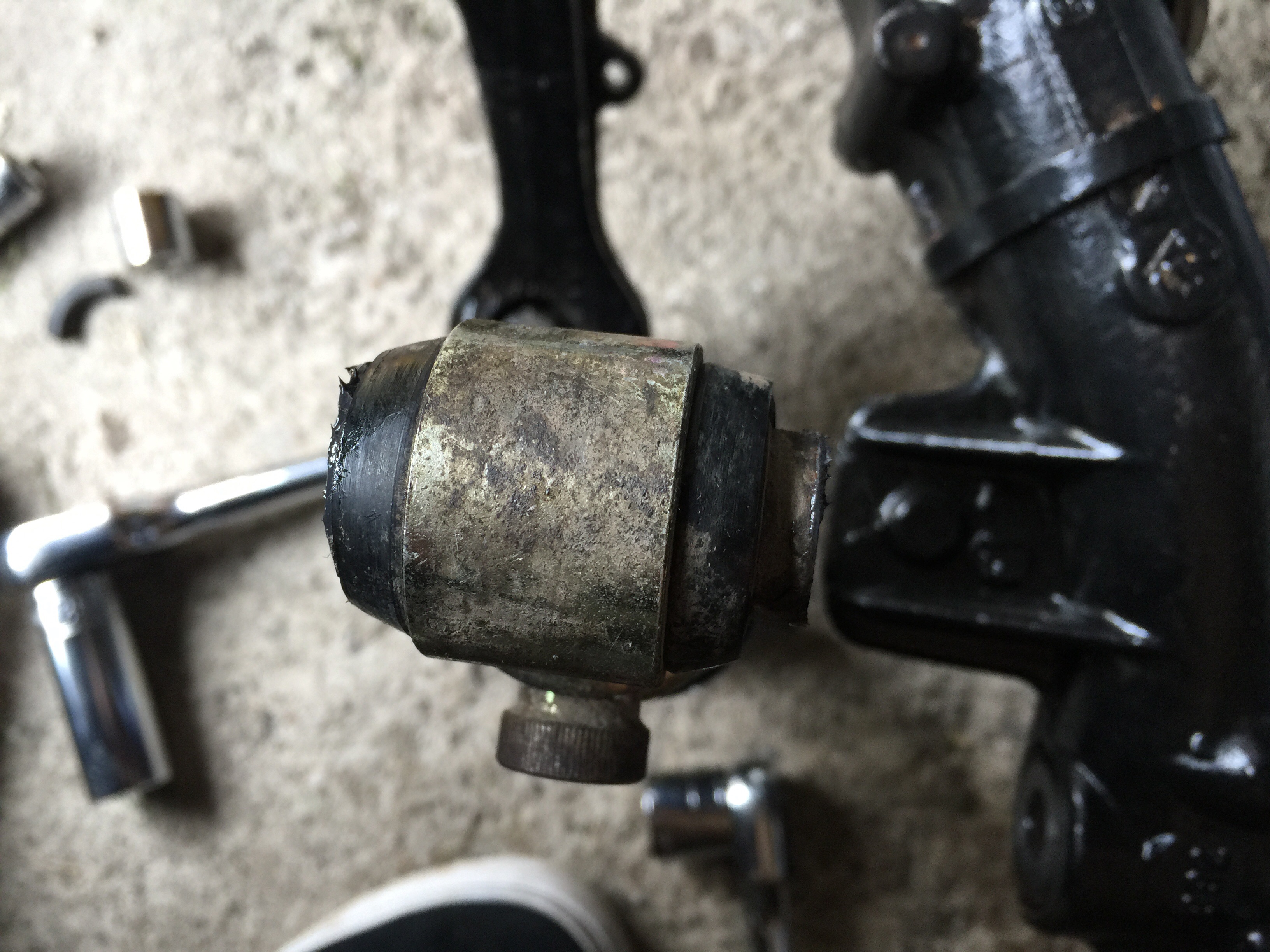

(14-07-2015, 02:58 PM)Stef205 Wrote: No 106 units have a spacer on the bottom to space it way from the arm you can see the angle the shock is sat at due to the missing spacer
Hm can't find a picture of the spacer. This is how the shock sits once the bottom bolt is loosened
They certainly look like 306 items I don't have any 106 shocks near me atm but I'll get one later
05' Evo 9 IX GT
Team eaton.
(14-07-2015, 03:41 PM)Stef205 Wrote: They certainly look like 306 items I don't have any 106 shocks near me atm but I'll get one later
That's the 106 rear shocks look the same as mine
Nathan in that pic you can clearly see the spacer block stef's saying about that yours dont have!
This piece circled i mean
Team Cyril
(14-07-2015, 03:48 PM)Matt-Rallye Wrote: Nathan in that pic you can clearly see the spacer block stef's saying about that yours dont have!
Ah I see! Can I not just space mine out with some washers?
Or could I even press out that spacer from my old shocks and put them on the GAZ ones

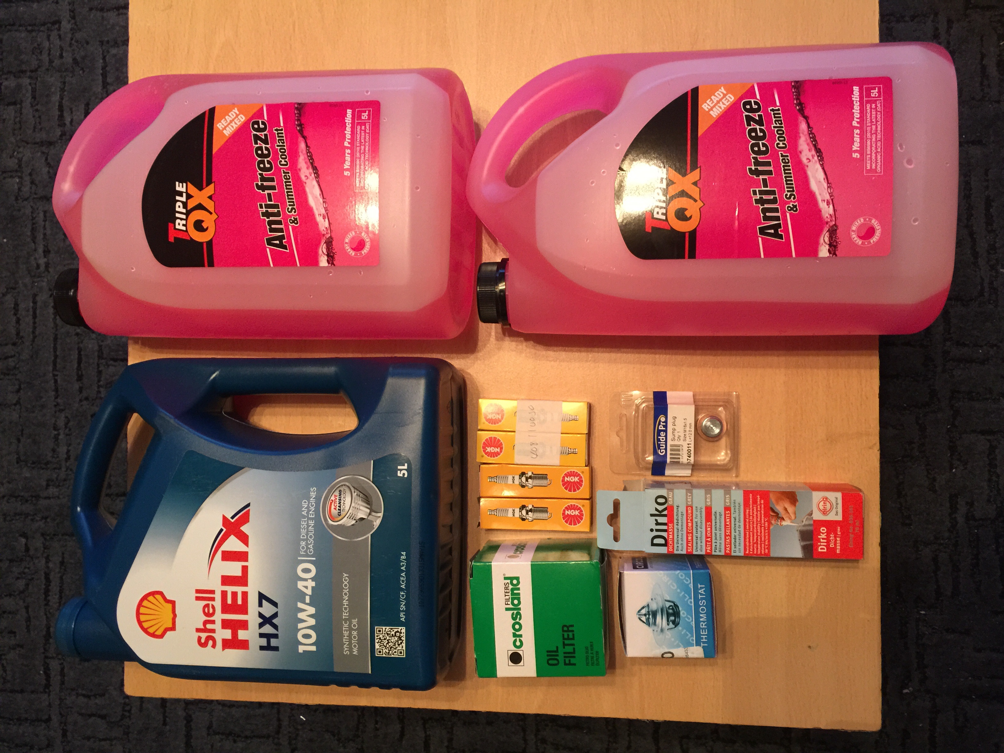

I thought I'd treat the GTi to a good service after its thrashing at Pugfest Smile got some decent oil, coolant, oil filter, spark plugs, thermostat, sump plug and some gasket sealant for the cam covers as you can't buy the gaskets anymore. Not bad for £53 Smile ECP have a further 15% off using code: Extra15

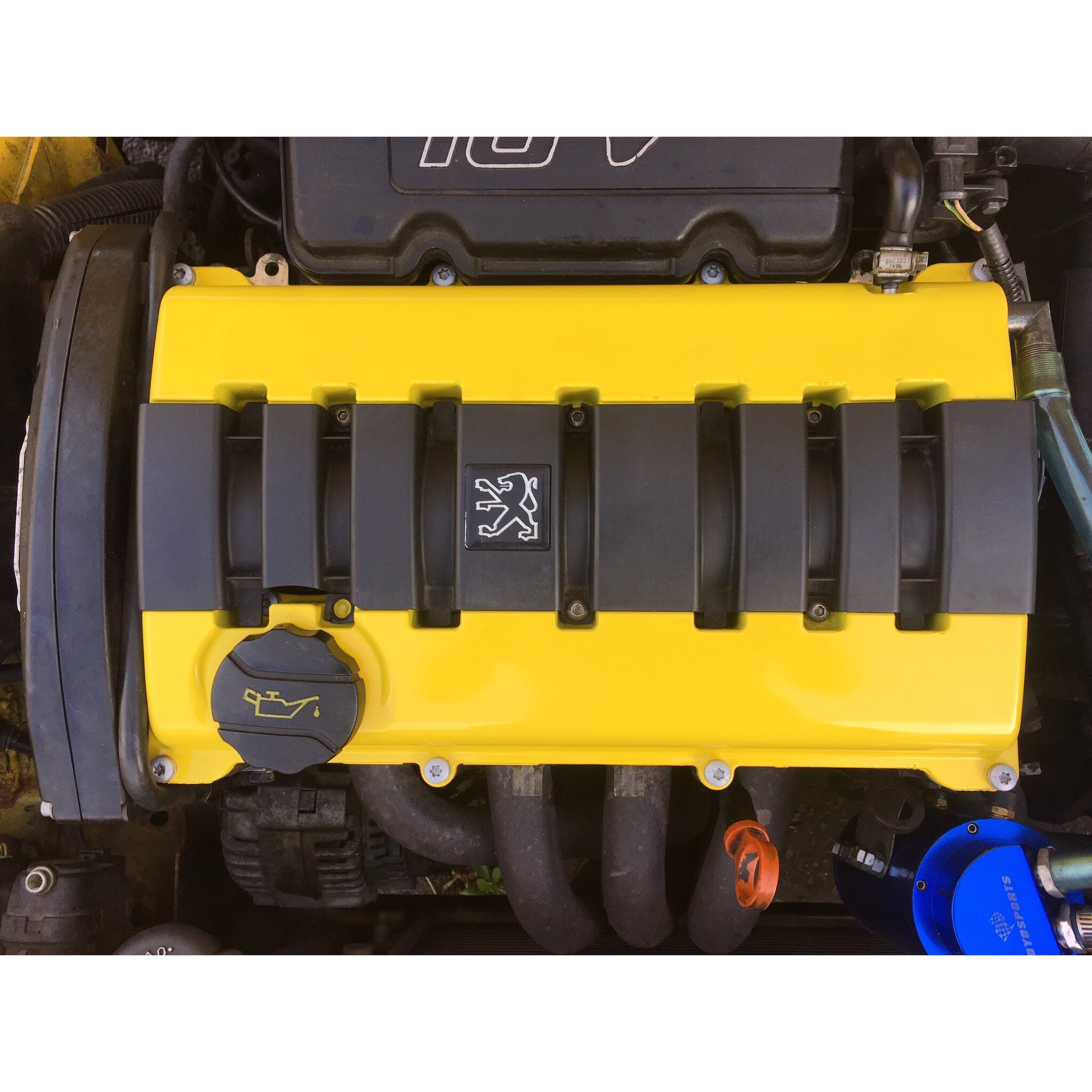

Boredom got the better of me today so I sprayed up the cam covers, pretty happy with the results Smile it's actually Fiat Broom Yellow but pretty close to sundance.
By pretty close i assume you mean they are both A shade of yellow? Haha
