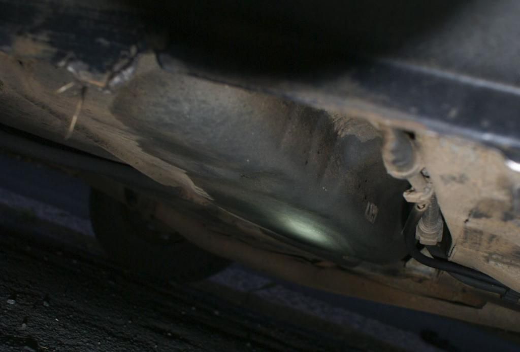

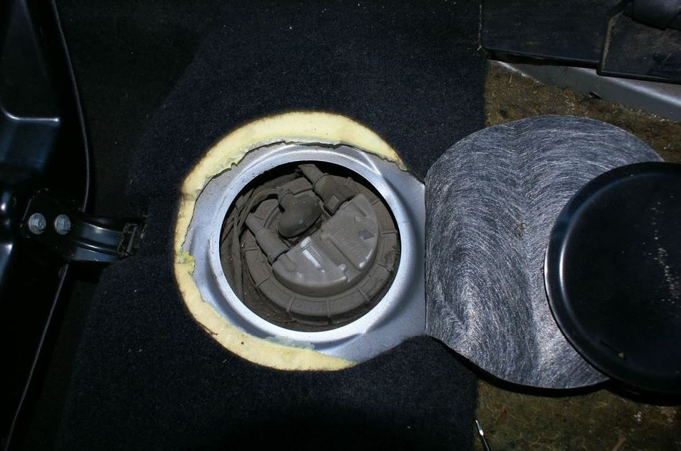

Since buying the car I have only driven about 40 miles and put 30 litres of fuel in but the tank is only registering about 1/4 full. Noticed noticed a small patch of fuel below the back and seems the tank is damp:
[Image: dampfueltank_zpsfbde0b62.jpg~original]
The fuel lines look intact and I've looked at the fuel strainer which has nothing obvious wrong:
[Image: fuelintakestrainer_zps037ac83b.jpg~original]
May have to go to a garage with this one.

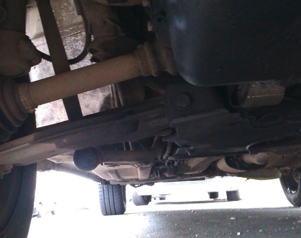

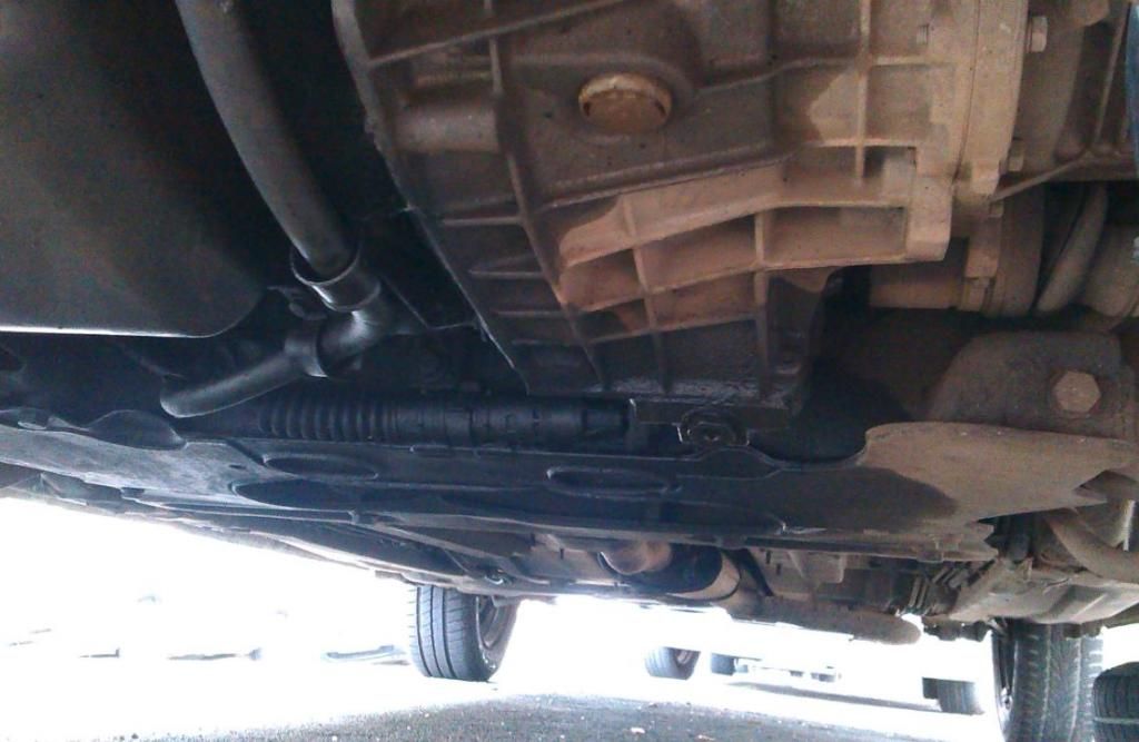

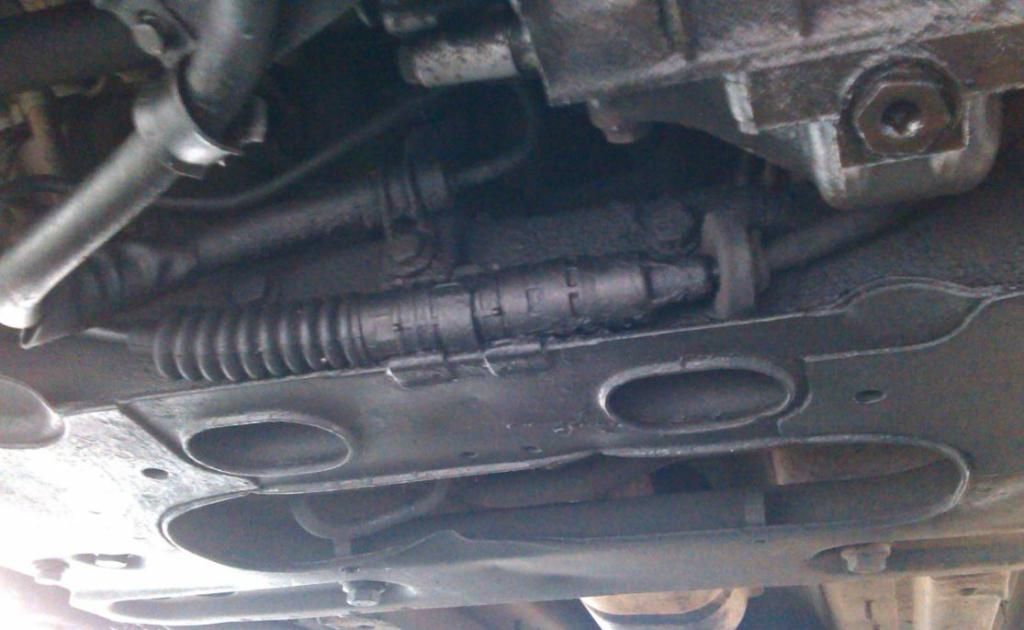

Unknown fluid on the transmission and generally around underside of engine bay. It hasn't rained here for ages so sure it's not water. I can understand there being some fuel on the sump from the leaky injector tubes but not sure it would have spread this far:
[Image: unknownfluid_zps24ff5f55.jpg~original]
[Image: unknownfluid2_zps77b0509d.jpg~original]
[Image: unknownfluid3_zpse2862c57.jpg~original]

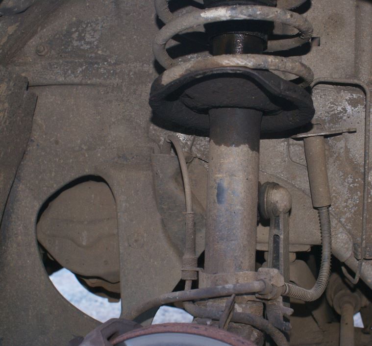

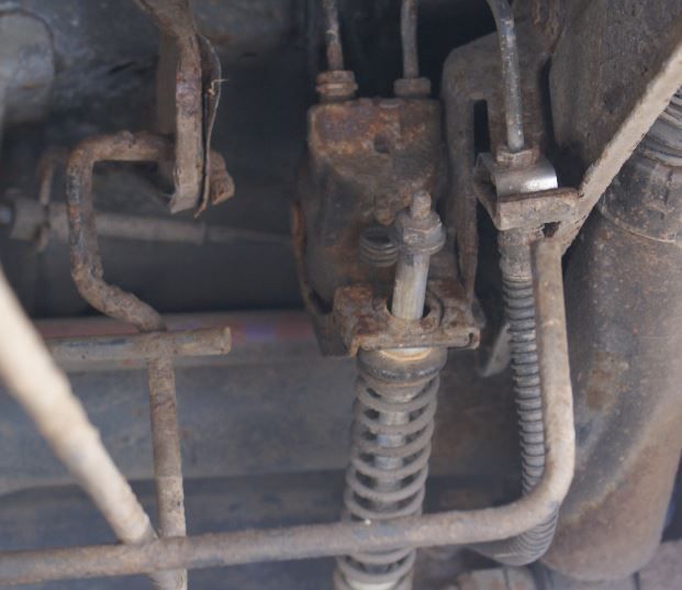

Leaky shock absorber and seized brake balance valve to top it off:
[Image: Leakingshock_zpsacacf28d.jpg~original]
[Image: seizedbrakebalancevalveandrustedhangar_z...g~original]

Looks like an oil leak on engine...check cam cover area or turbo oil supply/drain.
Fuel could be the rubber elbow from filler neck, common tl go. But also may just be run off from engine oil leak. Wipe the tank clean and check again after a little while
Shockers can be had for peanuts on here...most chuck away standard ones I expect...best to do in pairs mind
And seized comp is common too, soaked in wd40 and free up with pliers.

Leaks spread a long way, that could easily be diesel from the leak offs down there, mixed with a bit of tranny fluid and engine oil as well knowing 306s haha. Degrease it and see how much comes back. Smile

Looks like every 306 I've ever owned.
Cam cover gasket, leak off pipes and sometimes sump plug washer.
all those leaks can spray horrible looking oil all over the underside of the car, but it's no problem.
f*cked shocks is quite common, the cars are getting on abit so it's to be expected - as is the rusted up brake balancer.
You'll probably find the bushes in the suspension arms are shot and the arms are usually bent from Kerb action, and the drop links are often mullered.
All cheap parts and all easy to fix.
You've gotta drop the arms off to sort the shock out anyway, 90% of the time the balljoint is so old you puncture the rubber so it's not worth re-using old arms.
IIRC you can get complete lower arms, with bushes and balljoins pre-installed for about 50 quid a side.
20 quid or so for both drop links.

They all look like that underneath tbf.

I've had a look and think the cam cover is ok, the fuel filter is weeping a little bit and can't look at the turbo without risking getting squished. I’m a bit limited in undercar work, only got on street parking and my narrow one way road has quite a steep drainage fall and is a through road so always busy, hence not sure it's worth getting a jack and axle stands while i'm here.
(24-06-2014, 04:56 AM)Piggy Wrote: Fuel could be the rubber elbow from filler neck, common tl go. But also may just be run off from engine oil leak. Wipe the tank clean and check again after a little while
I’m pretty sure it’s not engine oil runoff, the space between the engine and the tank is dry. Can’t find anything about the filler neck in Haynes.
(24-06-2014, 04:56 AM)Piggy Wrote: And seized comp is common too, soaked in wd40 and free up with pliers.
Freed it up somewhat but not sure it’s right, no tension in the springs.

Checked all the lines to the tank and can't see and leaks so think it's probably fine. The fuel filter was weeping a bit which could have been causing the engine bay mess, replaced oil and filter now.

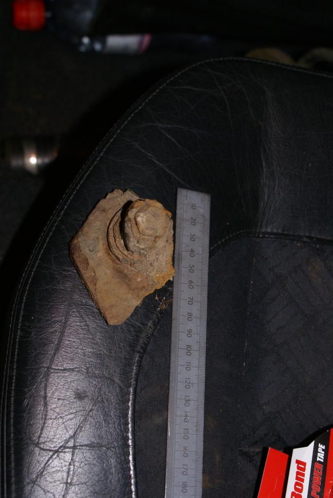

Pulled this out of the rear passenger side wheel arch the other day, not sure if it's worth wire brushing and applying underseal or if it's too late..

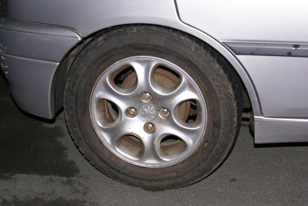

Went to get shocks, ended up with alloys and other toys too Big Grin, cheers mate. repped
Should look good when cleaned up:
[Image: 2014-07-12204650_zps8b7bee92.jpg~original]
err where exactly did you pull that bolt from??
It's probably worth getting the back end up in the air and having a poke around with a screwdriver and a wire brush, see what else is rusted to hell.
It seemed to be roughly where the seat release lever is. Maybe held the body work to the chassis? Should be able to get it on axle stands at the end of the month, should probably put off any big spends before then.
oh right, yea it's best to have a good look.
The 306 is pretty good at resisting rust, but there is one patch by the rear seats that can go.

Turns out the leaky suspension strut wasn't even for a 306, only had two bolt holes on instead of 3 (from a 206?). All replaced and good now though.
