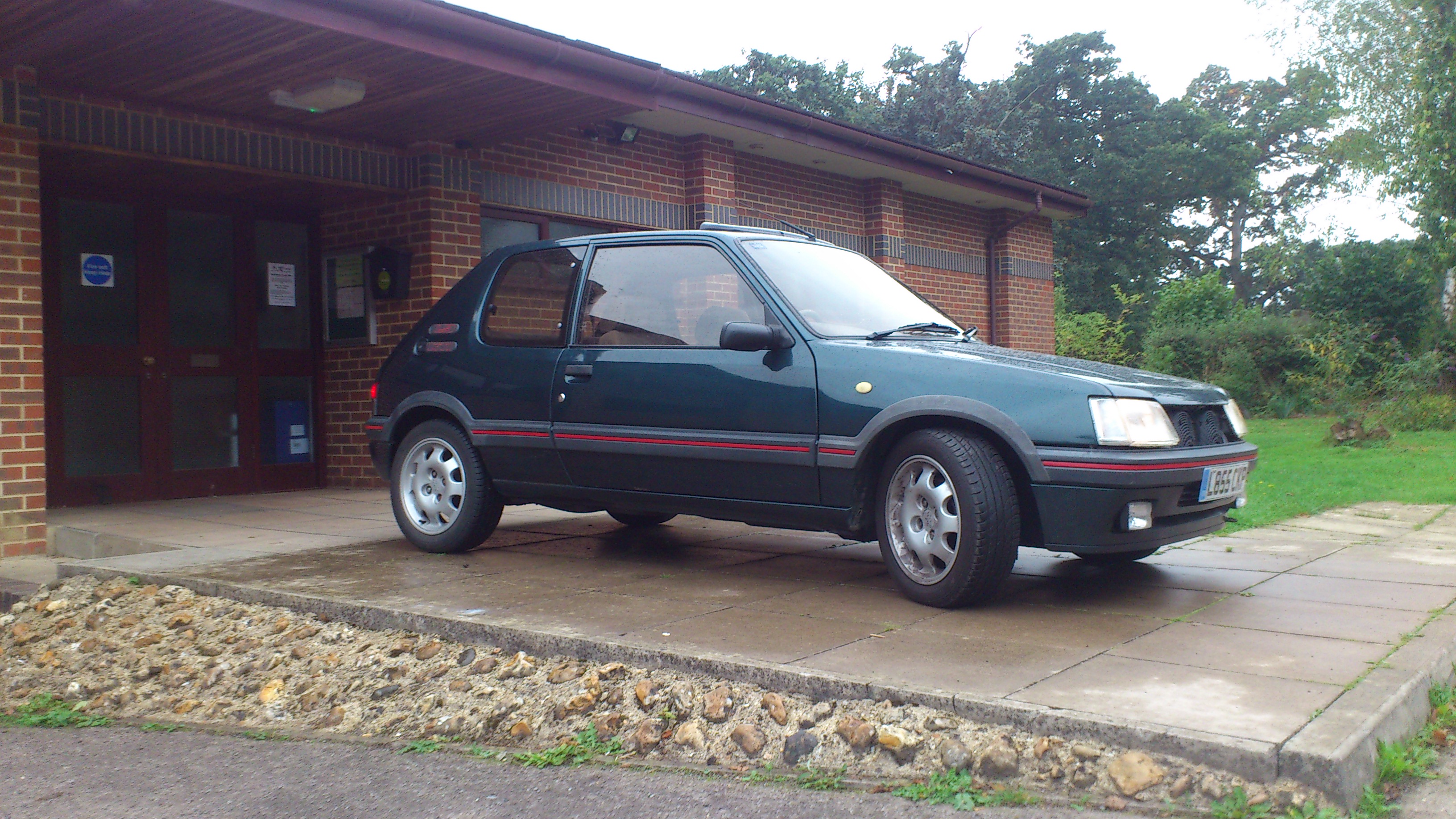

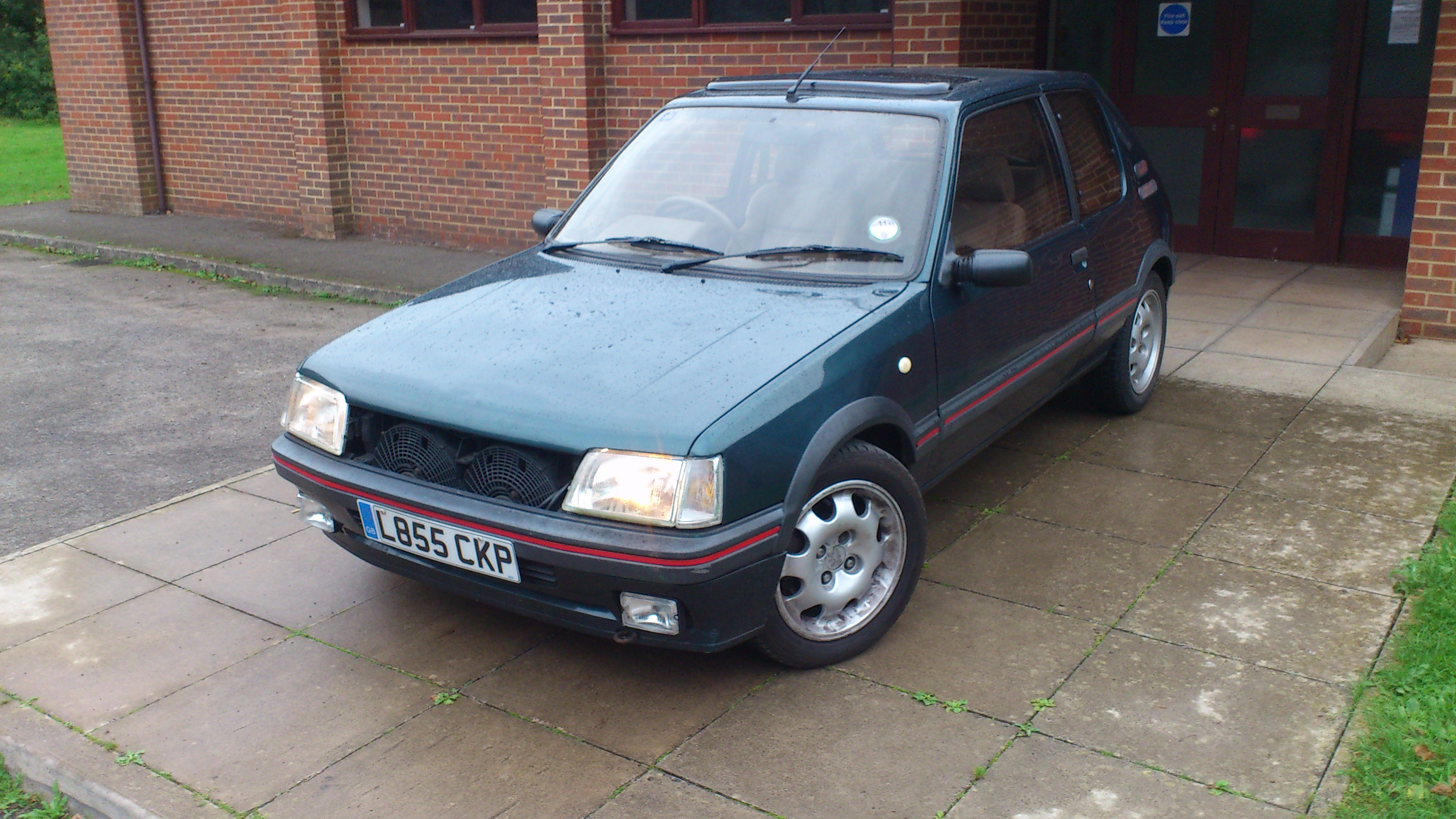

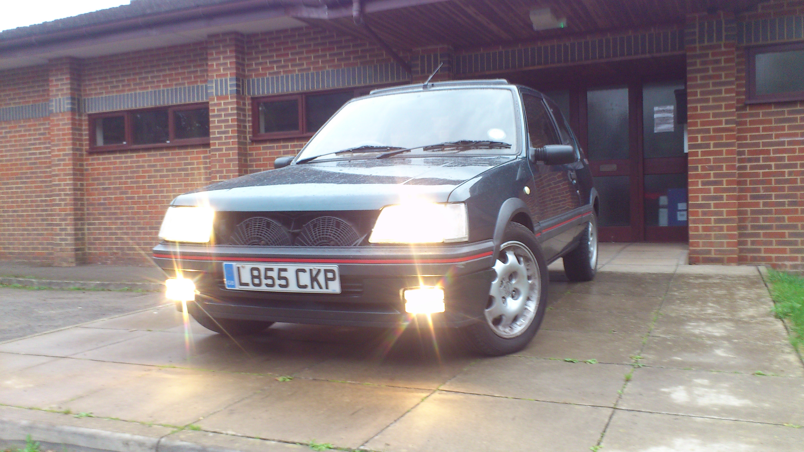

Finally, pictures, proper ones this time and all! ![]() Passed today with a clean sheet, still needs a few things done, but i can relax now. Thank f*ck lol. Oh yeah, the grill will be going in very shortly, it was just rather low on the priority list until now.

Well done man , good to see all the hard work has payed off
25-09-2013, 08:34 PM
Glad to see its on the road, this means you get your car back now.

Your grills missing. Trying to be like ginge eh?
