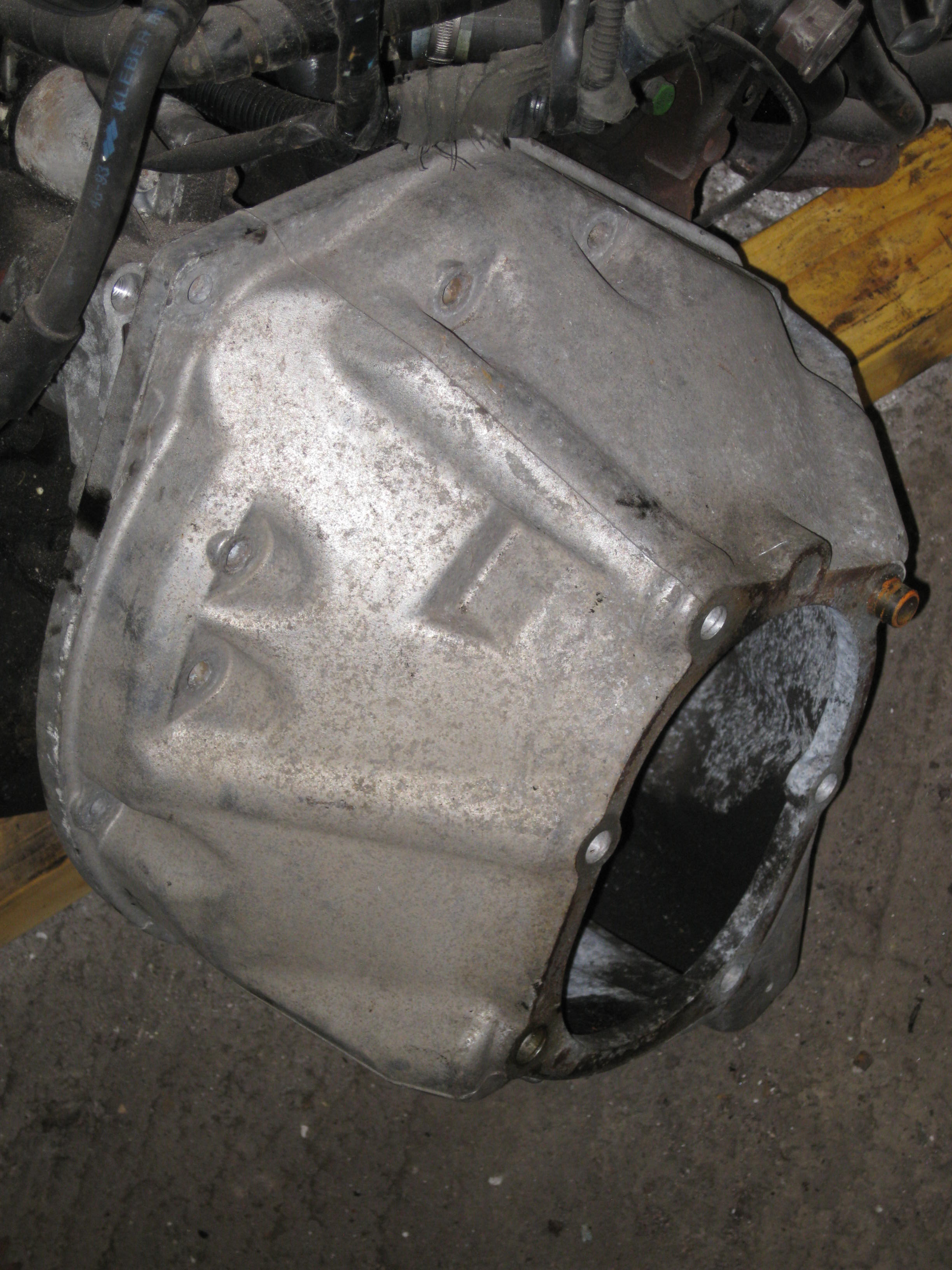

If anyone is thinking of doing a similar thing I have a bell housing for an XUD to Rover LT77 gearbox.
