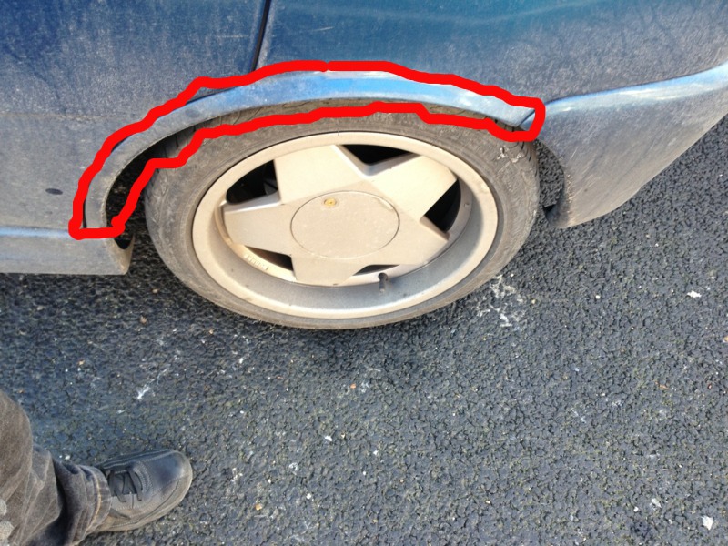

Okay so my wheels have arrived and while I am refurbing and sorting tyres I need to consider how I'm gonna get them to fit lol.
There is an arch roller and heatgun to rent local, has anyone had any experience using one? I'd like to keep the arches in the best condition possible

Just out of curiosity whats the spec of the wheel and whats thenride height? Make sure the arch is nice and clean as when yoh roll it if theres lumps of dirt stuck on the lip they will result in lumps. You will want to warm the paint to help stop it from cracking, its not a guarantee, then just take your time doing it bit by bit and keeping it as even as possible. This is what i know from doing it to mine with a few bits of pipe, lots of hammers, and some wood. Still had to get it done properly after (surprise, surprise).
they are 8j et -12 so not quite as much poke as you. ride height is only ~-60mm atm but would want it lower i would say. probably go for 185 tyres too

If you can get away with just rolling the top then you'll be fine. If you need to do down past the door id advise getting some one whos done it befor to give you a hand. Smile
Just clear all the mud and crap from the arch before you start.
Have an idea of how far you want to come out and from what height

Its all down to how you use the roller as t exactly what you get weather its just rolling the lip, adding a tiny flare at the bottom or pushing the whole arch out by miles.
I own an arch roller but it lives with Kris so ive got a fair bit of experience using it.
I went a bit mad with my BMW and ruined the arches, not sure if ive got pics but tried getting a good 2 inches more out of the arches for the huge wheels i had.
I think I will rent this equipment its only 20 quid for a week. any tips on setting it up?
