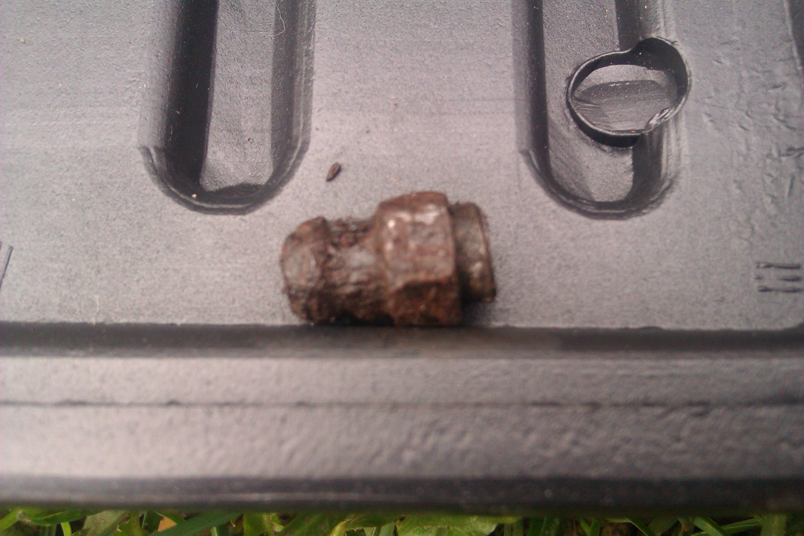

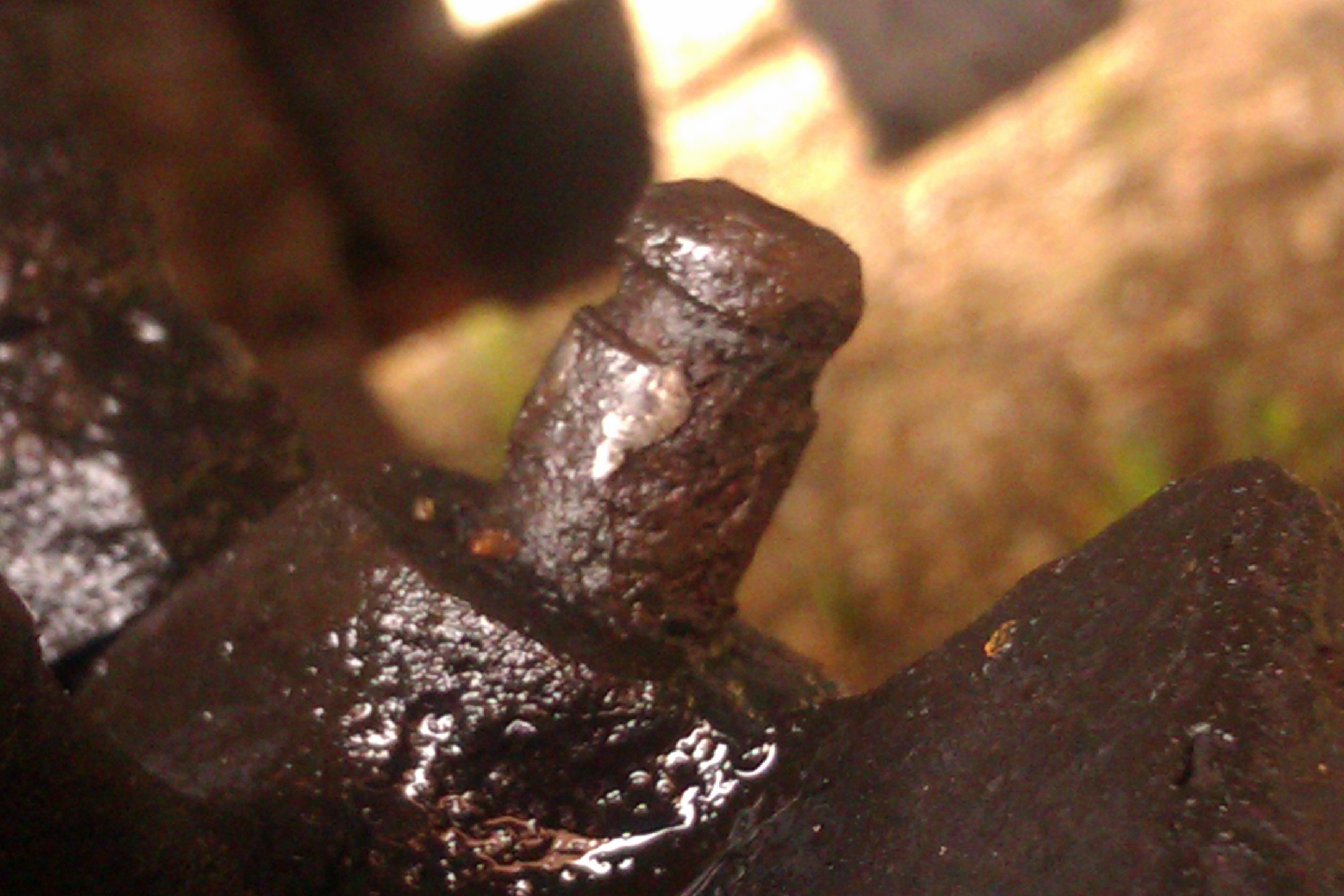

Drivers side nipple has already been mashed, anything I put on it has no purchase at all -
Managed to loosen of the pass side front and rear ok with a lot of patience.
Got to drivers rear and barely any force at all this happened! Sad
Sad

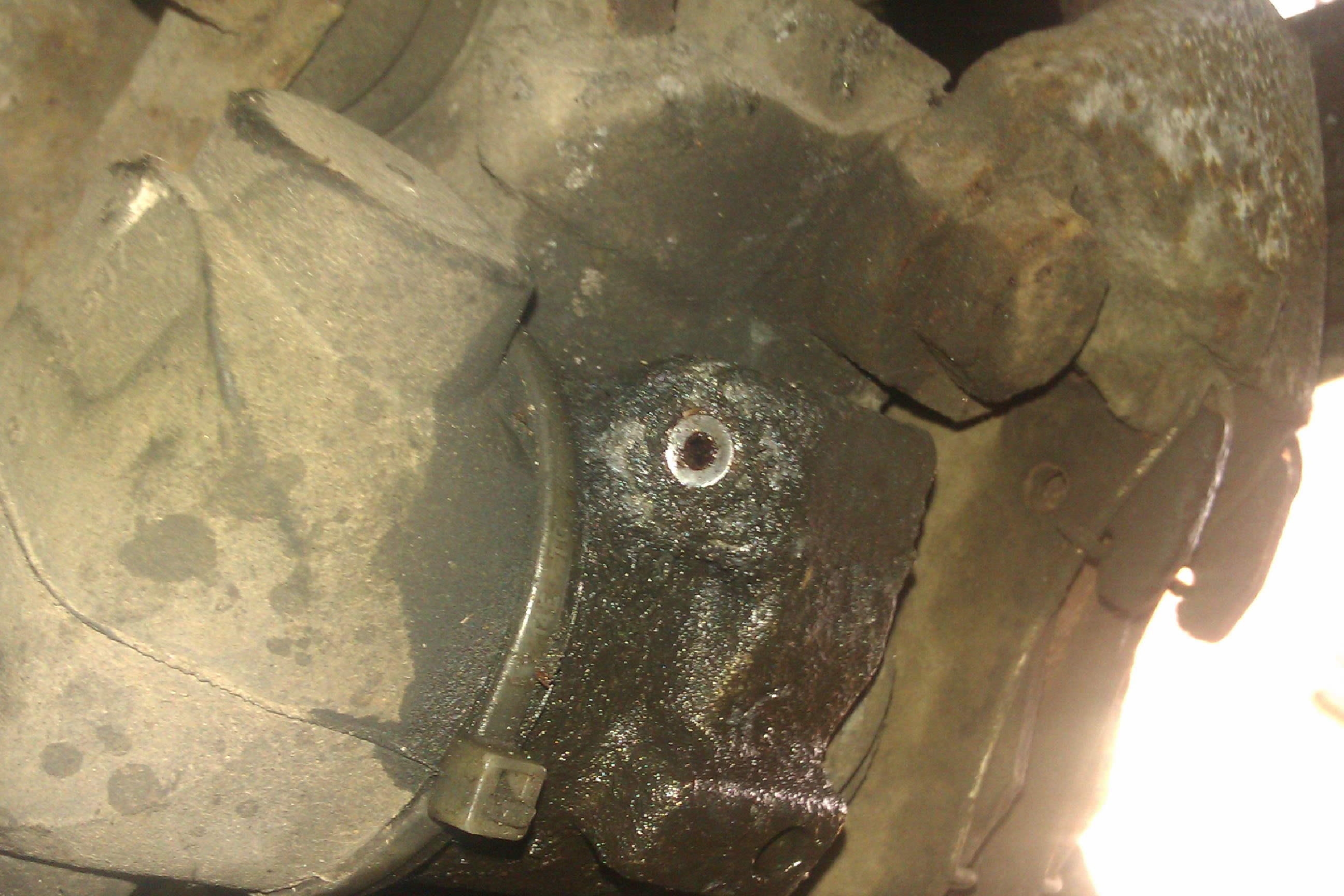

Don't know what to do know. Undecided can I drive it like that? Not entirely sure how the nipples work but there's no fluid coming out.
Wish I hadn't bothered now.....there's a reason I worry about stuff going wrong....because it always bloody does!
Any advice on what to do about it would be appreciated.

That's fine to drive Tom. I drove my old one like that for months. Time to either get a decent set of calipers or drill them out and put new nipples in. You can also bleed them from the brake lines but that's far from ideal for you.
Hammer a torx bit into the hole that should get it out, you'll need to buy new ones though, obviously.. You can drive around aslong as you have brake pressure.
Take the calliper off and drill it out and fit a new nipple or take it of and get a garage to do it
Team Doesn't own a 306
New nipples are only a couple of quid on ebay, just drill the remains of the old one and re tap the hole.
No wonder you arnt getting no where using DIY'ers WD40 if youd of used somthing decent like a branded penetraition oil. Durex play dosnt work BTW . They may have actualy got somewhere
So you're sure I'm ok to drive it yeah? Well at least that's a start lol.
I've got a feeling the brake hose ends are gonna be just as difficult to get out though, they're rusty as hell too!
How much do you reckon the garage would charge to replace all brake hoses, the two f*cked nipples and bleed everything after?

As long as you have pressure, it'll be fine to drive Smile
Get some decent penetration oil on the brake hoses, even if you take it to a garage, it'll make the job easier and therefore cheaper!
And just go and ask the garage, explain the situation to them. They don't charge for quotes :Lol:
Fine to drive, provided it didnt move, its just as sealed now as before you started Smile

Plus gas is the best penetrating fluid I have ever used, never let me down yet. +1 on the hammering a torx bit in! Worked for me
