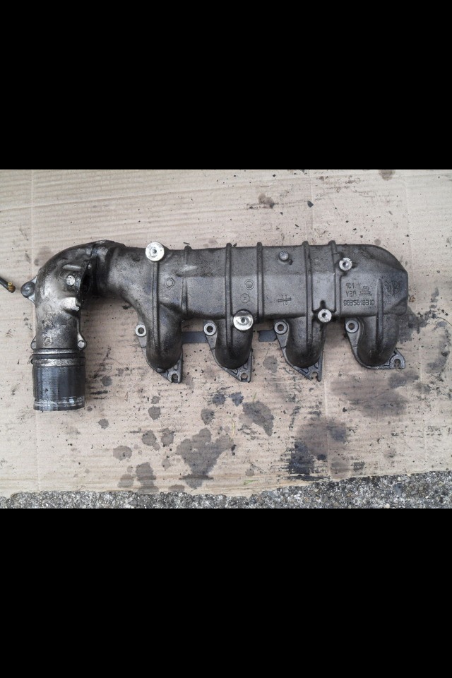

I know I'm being a little thick I'm sure but hey I gotta learn.... Is this what u mean..
17-09-2012, 07:55 AM
(16-09-2012, 10:51 PM)Icywalts Wrote: I know I'm being a little thick I'm sure but hey I gotta learn.... Is this what u mean.. or is it this, I would be great if u could help. I'm not sure what piping to get either but if I have the basic stuff I can find the rest after... So wish someone was selling a complete set up :-S niether of them. they`re off the 90bhp http://www.ebay.co.uk/itm/251141650402?s...1438.l2649 you want the 3 on the left coz it makes things easy. then buy - http://www.ebay.co.uk/itm/2-25-UNIVERSAL...4840df0d05 or similar, and thats it, apart from the clutch and map

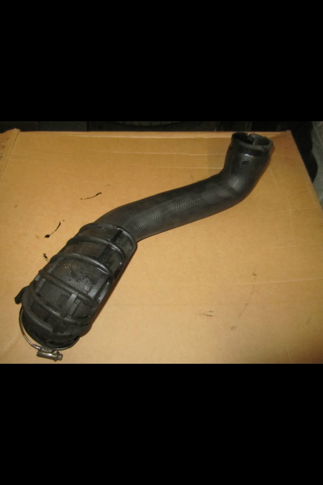

So I have been part hunting.. What about these!?
There was one more small part from it list but I couldnt find it? More advice??
18-09-2012, 04:24 AM
Check the guide section dude, a whole thread on this. There's also a further 5 related threads in the first 3 pages of this section. Also, if you read/click the link on neilz85's post, you will be able to see the OEM pipes required, they're all easily available in scrap yards.

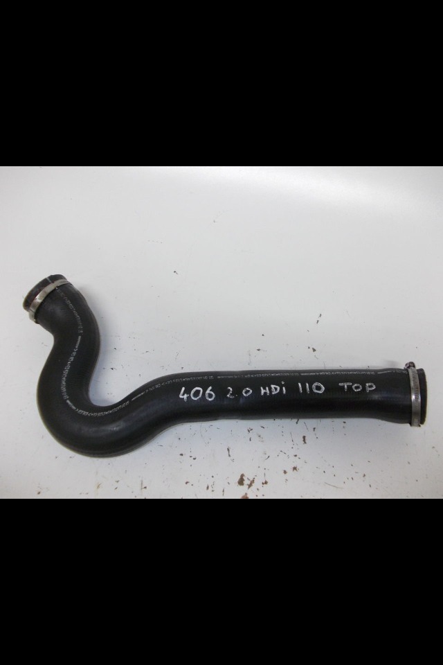

These are the 2 pipes you need off the 406 110bhp
![]() I recently just finished my intercooler off i went round scrap yard finding cheap rubber elbows (pipes with elbows on that can chop down) the right size (57mm) thats the size i went for anyway then sourced some cheap alloy pipe and cheap intercooler all in all from doing it on the cheap it probably cost me around £80-100, but you could just buy them pipes on the pic from a scrap yard (i paid £10 for the 406 ones) and then get a universal intercooler off ebay if you get a single pass one then i think you may need to remove air con (if you have it) twin pass would be easier tho look at my thred to see how i run pipes etc

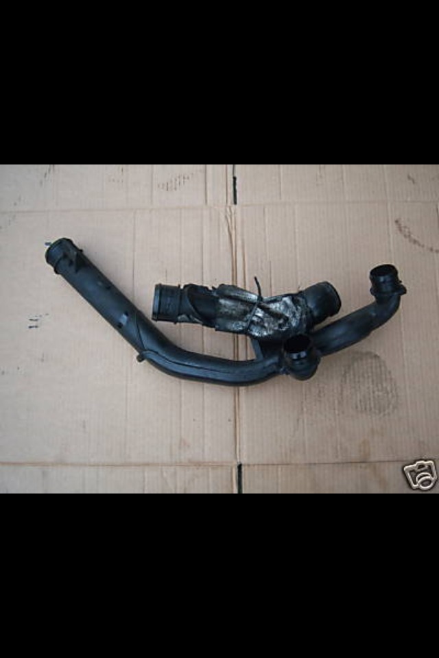

Would this be of any use??
21-09-2012, 07:11 AM
Not being funny mate, we've told you exactly what you need and where to get it, there's only so much we can do for you. You can see for yourself that the required pipes aren't present in that picture, and i can see that you have a phone, therefore must be able to ring the seller and confirm for yourself. Give it a go, most sellers are pretty pleasant.
