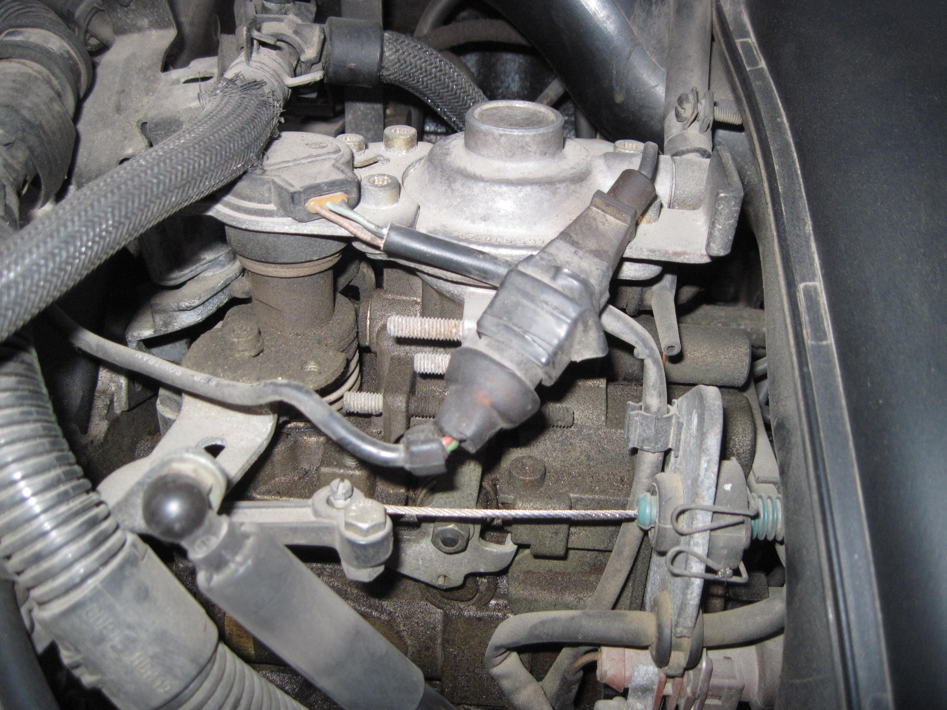

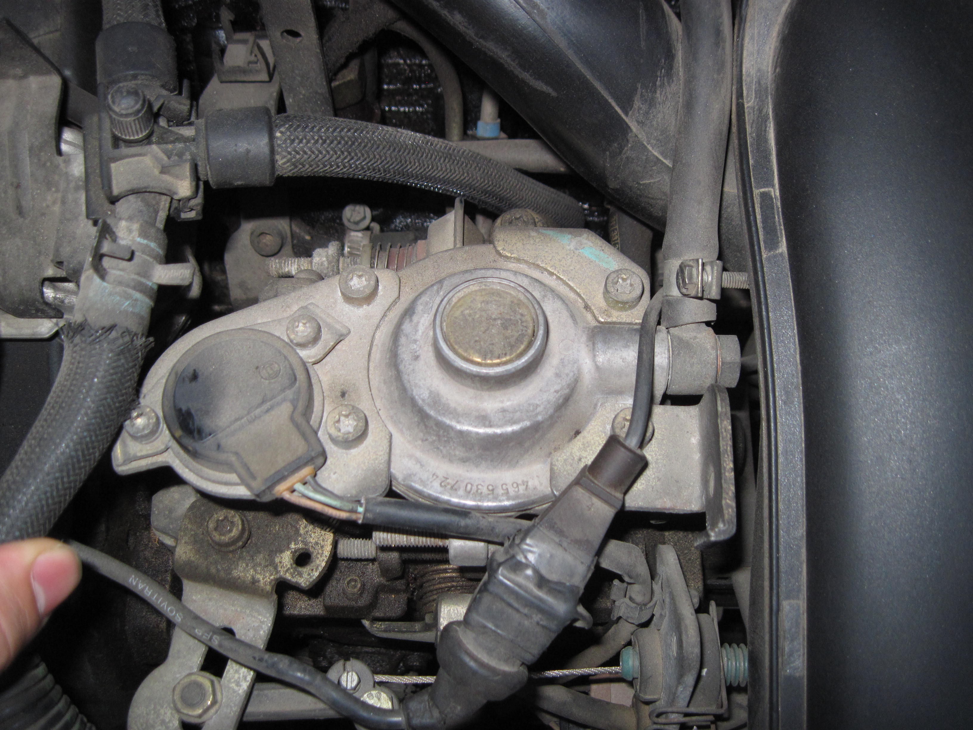

RE: Another XUD - Nikolov_BG - 21-11-2012 I must put a 306 pump RE: Another XUD - Kwik - 21-11-2012 iirc not all 406 pumps are semi ecu...... RE: Another XUD - Nikolov_BG - 21-11-2012 I'll post a photo of the pump this days... RE: Another XUD - Nikolov_BG - 24-11-2012 Here are the photos RE: Another XUD - Kwik - 24-11-2012 semi-ecu one see the wires on top of the LDA cap that's the giveaway RE: Another XUD - parrotveasey81 - 24-11-2012 (24-11-2012, 06:31 PM)Kwik Wrote: semi-ecu one see the wires on top of the LDA cap that's the giveaway so what does the tps control on these pumps then??? RE: Another XUD - Kwik - 24-11-2012 it's for advance as a wire goes to one of the injectors iirc RE: Another XUD - Nikolov_BG - 25-11-2012 So,what I have to do? RE: Another XUD - Kwik - 25-11-2012 the max fuel screw is armoured iirc so you need to grind off the armour to get to it. But you have to be careful not to grind off the screw! a dremel may well be your best friend there. When you done that you can pump in extra fuel to match the td04 RE: Another XUD - Nikolov_BG - 25-11-2012 What's iirc? Some pic guide?

RE: Another XUD - Kwik - 29-11-2012 well you can do the turbo wastegate but no point if you can't up the fuel RE: Another XUD - Ruan - 29-11-2012 Remember this isn't petrol - there's no AFR to worry about, running lean doesn't cause any issues, it's running lean all the time! You can turn up the turbo, but you wouldn't achieve any more power than standard as there's no more fuel to go with the air... You can wind up the pump a bit without winding up the turbo, but as a rule, you'll want to adjust the two together... You can achieve around 135-145 on a stock turbo and tweaked pump if you do a hard tune
RE: Another XUD - Kwik - 29-11-2012 Raun is the max fuel screw armoured on the semi ecu pump and does the ecu control advance or am i totally wrong? RE: Another XUD - Nikolov_BG - 19-01-2013 Can I put the older Pump without ecu control? |
