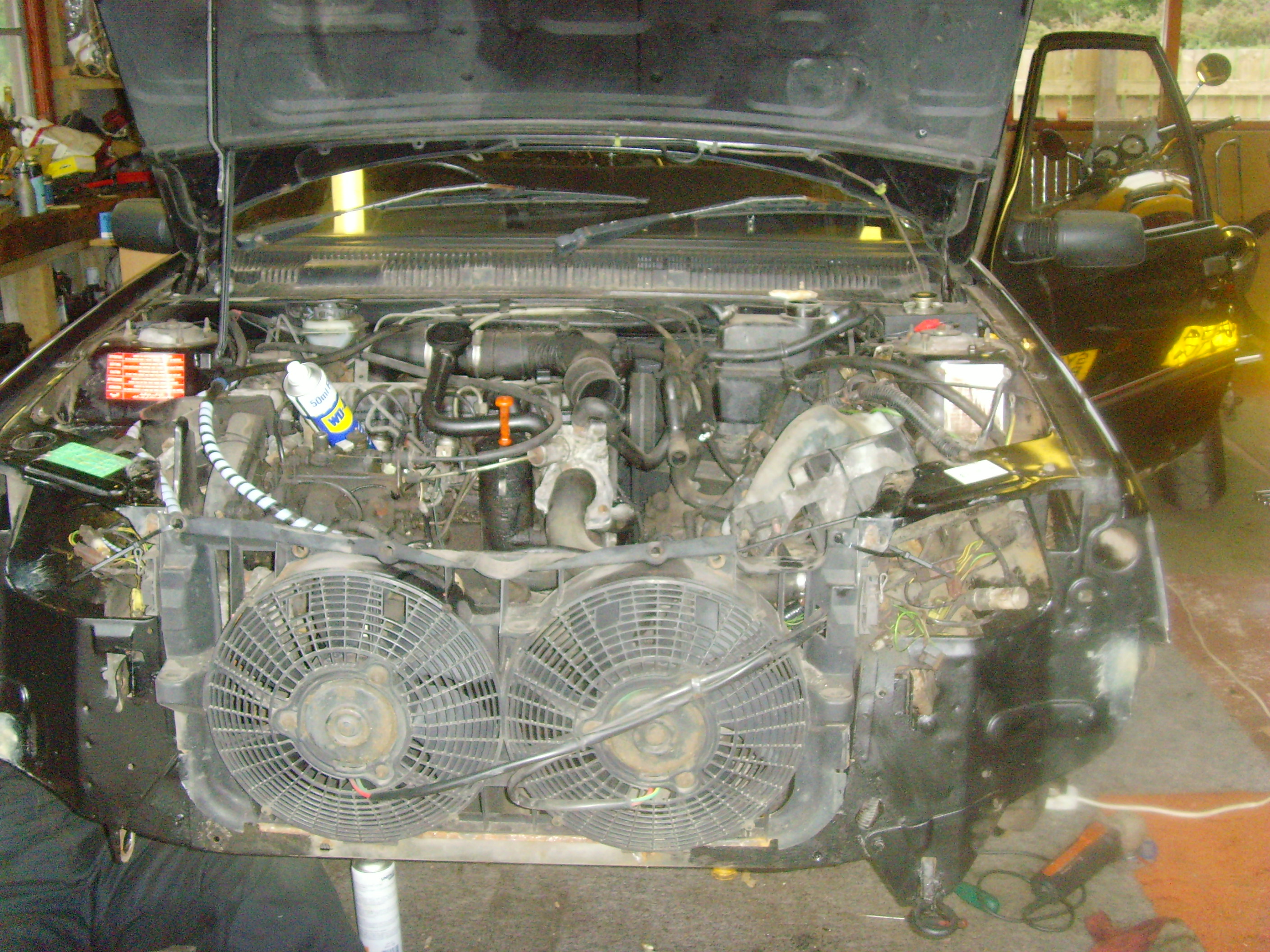

[attachment=13232] So finally got this 205 xud project underway. Got hold of a citreon ZX dturbo with bosch pump, we took the engine out and a few other bits and bobs, then got rid of the shell.
