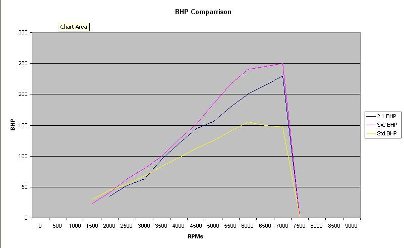

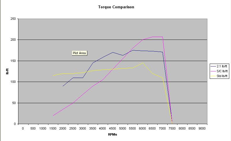

RE: turboing my gti... - Dum-Dum - 23-09-2012
Ruan I appreciate what your saying but the OP is taking about a (Im assuming used) T25 turbo that was designed at some point before I was even born.
I do appreciate what your saying about stroking and cams moving in opposite directions but if youve looked at the milder performance cams for the 6 they dont move the peak power any further up the rev range.
Anyway for comparison
.xls   GTi6 power comparisons.xls (Size: 28.5 KB / Downloads: 190)
This is based on the data contained in Petes GTi6 standard power graph and the 2 graphs below, the 230bhp is a 2.1 and the 250bhp is a S/C
http://i49.photobucket.com/albums/f257/m_stevens90/RRgraph.jpg
http://img.photobucket.com/albums/v247/carpy6185/rollingroasd001.jpg
Ill remind you that the S/C will have a bit more low down and mid range than a turbod car also the S/C is running a little more boost than the OP is talking about so making a little more power. If i could find one to do a 230bhp N/A to 230bhp boosted comparison but i reckon it would be pretty interesting.

Dum the low boost rotrex charger is shit low down, and as a general rule turbos have much more lower down than a charger, if sized correctly.
The lynx low boost charger isnt a great example of what you can achieve with that application, a bigger charger Like the 38-94 They use with the high high boostengines with a restrictor ring would be better For the significant increase inow down torque it privides.
either way a turbo properly sized is a step up again in torque levels all over the rpms
also didn't Pete's gti6 make 150bhp cause it was a. It of a tapper? Or was it fuelling issues?
either way its hardly the best comparison...
