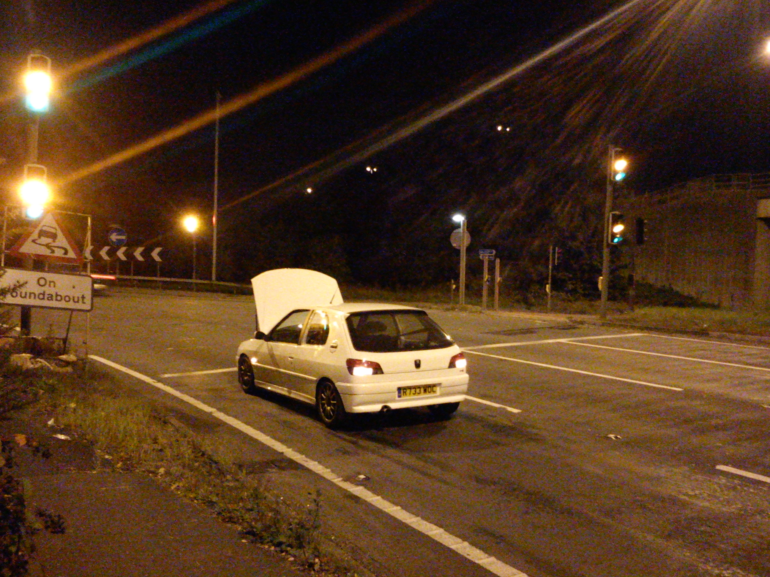

f*ck you GTi6 - waiting for the AA - Dum-Dum - 16-09-2012 So 3am finds me at the side of a cold motorway slip road waiting for the AA cos my 6 is a lady garden and wont start. RE: f*ck you GTi6 - waiting for the AA - procta - 16-09-2012 pain in the arse that dum dum, did it just cut out on you? RE: f*ck you GTi6 - waiting for the AA - Niall - 16-09-2012 Sorry but HAHAHAHAHAHAHAHAHAHAHAHAA!!!! Re: f*ck you GTi6 - waiting for the AA - Alee83 - 16-09-2012 She's just collapsed after extreme dieting... lol RE: f*ck you GTi6 - waiting for the AA - Matt - 16-09-2012 Scrap it RE: f*ck you GTi6 - waiting for the AA - Poodle - 16-09-2012 FLOL! ICV? RE: f*ck you GTi6 - waiting for the AA - Grant - 16-09-2012 Was the starter motor removed in a quest for saving weight? RE: f*ck you GTi6 - waiting for the AA - samass - 16-09-2012 Or the battery? RE: f*ck you GTi6 - waiting for the AA - Niall - 16-09-2012 I will happily bet £3.26 that this doesn't get fixed and he scraps it because it's broken RE: f*ck you GTi6 - waiting for the AA - Pompey306mark - 16-09-2012 Nice trip down to portsmouth was it? Lol RE: f*ck you GTi6 - waiting for the AA - cully - 16-09-2012 should of bought a derv! bad luck m8 RE: f*ck you GTi6 - waiting for the AA - 1616six - 16-09-2012 I reckon he just got tired pedalling home now he's removed that heavy old engine.. RE: f*ck you GTi6 - waiting for the AA - 4WayDiablo - 16-09-2012 Cars have to be bred to survive the rancid Portsmouth atmosphere Also niall. How come £3.26... Did you know that's how much work have paid me to poop this week RE: f*ck you GTi6 - waiting for the AA - Ed Doe - 16-09-2012 I reckon it's not priming cause the Inertia switch has dodgy connection. Only cause that Happened to me before on the Diablo! Did you get it sorted in the end? RE: f*ck you GTi6 - waiting for the AA - smanfa - 16-09-2012 Oh nooo!   that sucks! Mark just told me! Did you get home in the end? I feel awful now lol. X
