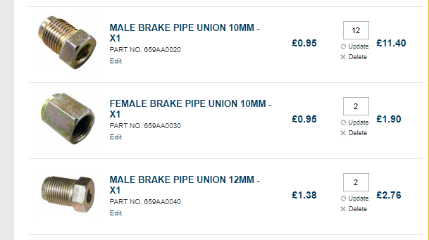

205 brake line fittings - Doseph - 17-08-2017 so im replacing my brake lines Does anyone know what fittings i need for a 205 1.8d? i think 12 M10 unions will do me? 205 brake line fittings - bashbarnard - 18-08-2017 Im sure theyre m10 x 1.0 Sent from my iPhone using Tapatalk RE: 205 brake line fittings - Doseph - 18-08-2017 for the 1.9 gti "you need 14 M10 unions and two M12, one side of the inline brake compensators has the larger thread." from 205gtidrivers RE: 205 brake line fittings - zx_volcane - 18-08-2017 (18-08-2017, 08:27 AM)Doseph Wrote: for the 1.9 gti "you need 14 M10 unions and two M12, one side of the inline brake compensators has the larger thread." true dat RE: 205 brake line fittings - Doseph - 18-08-2017 (18-08-2017, 08:34 AM)zx_volcane Wrote:(18-08-2017, 08:27 AM)Doseph Wrote: for the 1.9 gti "you need 14 M10 unions and two M12, one side of the inline brake compensators has the larger thread." the diesel is the same? RE: 205 brake line fittings - zx_volcane - 18-08-2017 depends on the rear brake setup if you have drums, then you shouldn't need the m12 as the compensators are built into the rear wheel cylinders. if you got discs though, they have inline compensators that have m12 on one end and m10 on the other. RE: 205 brake line fittings - Doseph - 18-08-2017 (18-08-2017, 08:41 AM)zx_volcane Wrote: depends on the rear brake setup ahhh it makes sense now, thanks ![]() RE: 205 brake line fittings - powerandtorque - 18-08-2017 From memory the base model drums (ie the ones with in-built compensators) don't use M10x1 fittings but something larger. 1.6 GTi spec drums (that have a separate compensator in the engine bay) are M10x1 as are all the other unions, with the exception of one side of 1.9 non-ABS compensators as mentioned. RE: 205 brake line fittings - welshpug - 18-08-2017 pretty sure as Anthony mentioned that the wheel cylinders may be M12. also for ease of fitment I would do as peugeot did on the 306 and citroen on the zx, which is to use an inline joiner at the base of the bulkhead to link up to the pipes going off to the rear. RE: 205 brake line fittings - Doseph - 19-08-2017 ok so i think this should do me then? 205 brake line fittings - bashbarnard - 20-08-2017 Are you re doing all the lines? The m12 one is just on the rear. Sent from my iPhone using Tapatalk RE: 205 brake line fittings - Doseph - 20-08-2017 (20-08-2017, 06:58 AM)bashbarnard Wrote: Are you re doing all the lines? The m12 one is just on the rear. The tank is out and its off the road so I thought it would be easier now BUT Would i bet better off just replacing front and then the rear upto the inline joiner. and leaving the rest till i deal with rear brakes? also i got a bit confused between brakes lines and fuel lines when i was stripping it, and pulled the wrong one out, so one of the lines is quite kinked now. |
